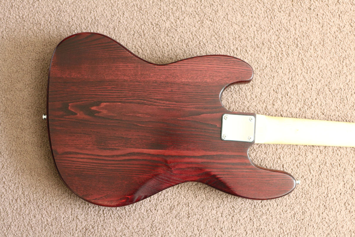

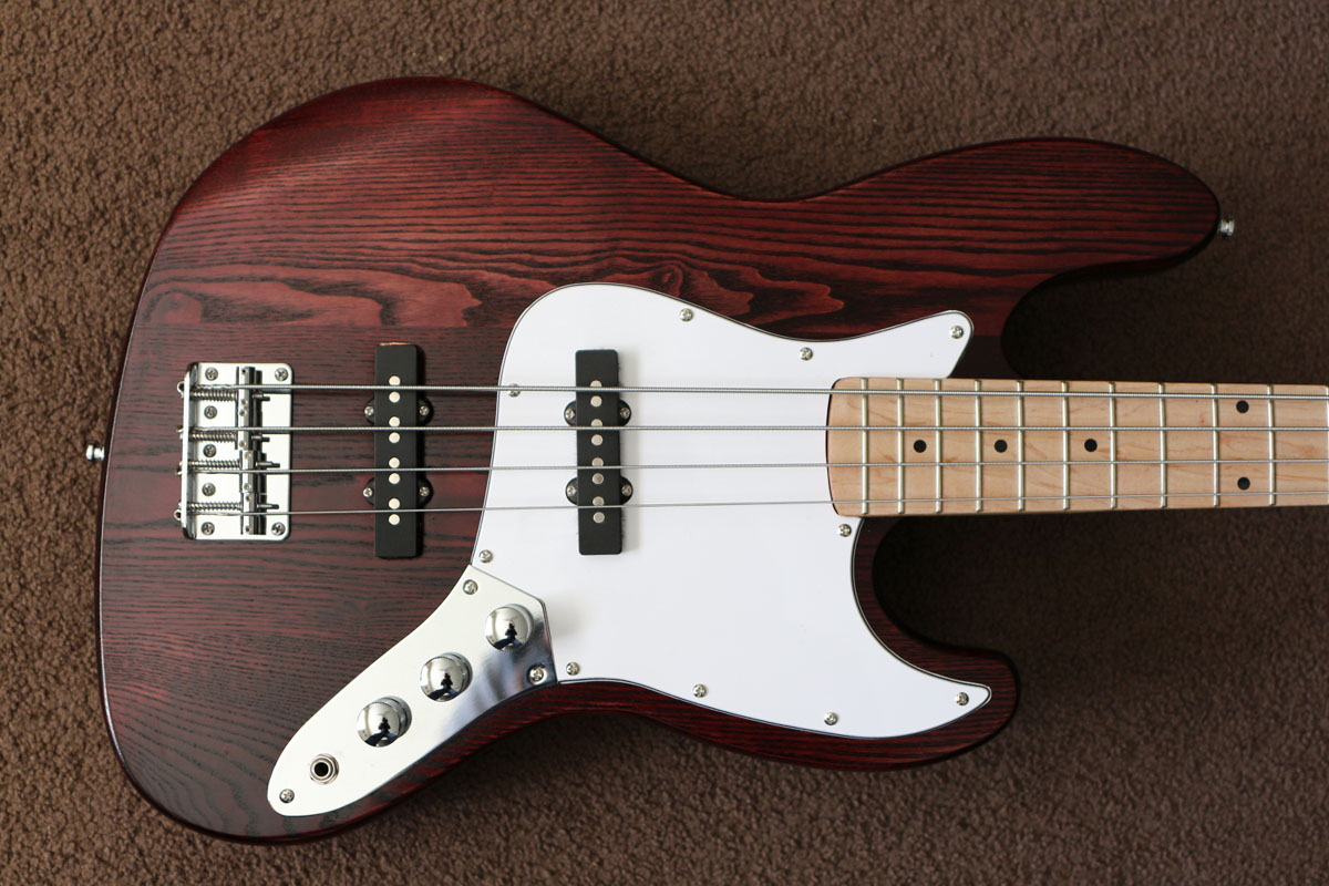

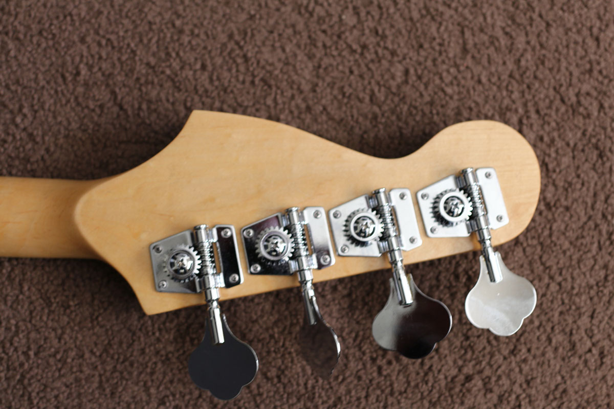

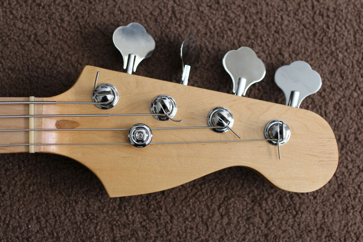

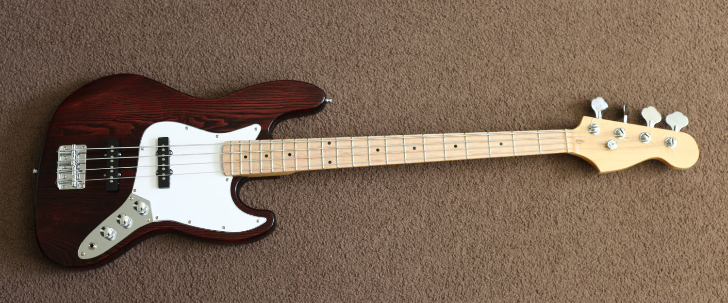

    Finally received the bone nut and some dingowax so that I could finish the fretboard and proceed with the setup.
    Here are images of the finished guitar.
    Setup was fairly uneventful - the intonations are all well within the range of the standard kit bridge (with the supplied strings).
    I think that the action could be a little lower, especially on the E string, so I may make some further adjustments, but it is playable as is, and it sounds OK (albeit through a pretty small amp - a Blackstar Core BEAM). I may have to investigate alternative strings to get a lower action as I don't believe that the standard strings are sitting well down into the notches in the bone nut - I set the nut height based on information I found on the Stewmac web site and the resultant string height is definitely not per the set height at the first fret. If it can't be solved with string options some rework of the nut may be required.

    Great looking bass, Jed. You can normally sort the nut slots out on a bass with a round needle file and some fine grit sandpapers.
  9. #39
    Thanks for that. Time to raid my daughter's jewellery making tools then. I love pay-back 😏.
