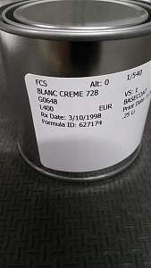

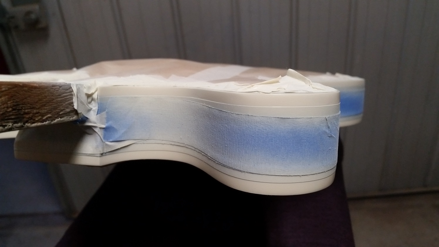

    Finally got back to this one, the JMA had my attention for a while. Sanded the clear with 600 grit followed by 800, may have been able to flatten out more of the grain marks but wasn't willing to risk sanding through. Went with Sonic's idea of touching up the binding by painting it, not the whole thing just the affected bits. All taped up, took ages
ID:	26925Click image for larger version.
    And hey presto, nice clean looking binding.
    Coz I'm using acrylic clear, played it safe by finding a suitable colour in acylic lacquer. The smallest amount they would mix up was 250ml so now have a lifetimes supply of binding touch up paint. Even though I'm fixing up a problem that was mostly self-inflicted it still feels a little like cheating.

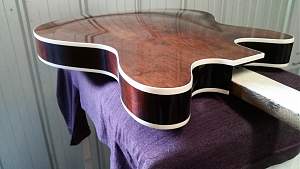

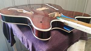

    Then sprayed another 4 coats of clear, may need to do more but will wait and see.
ID:	26929Click image for larger version.

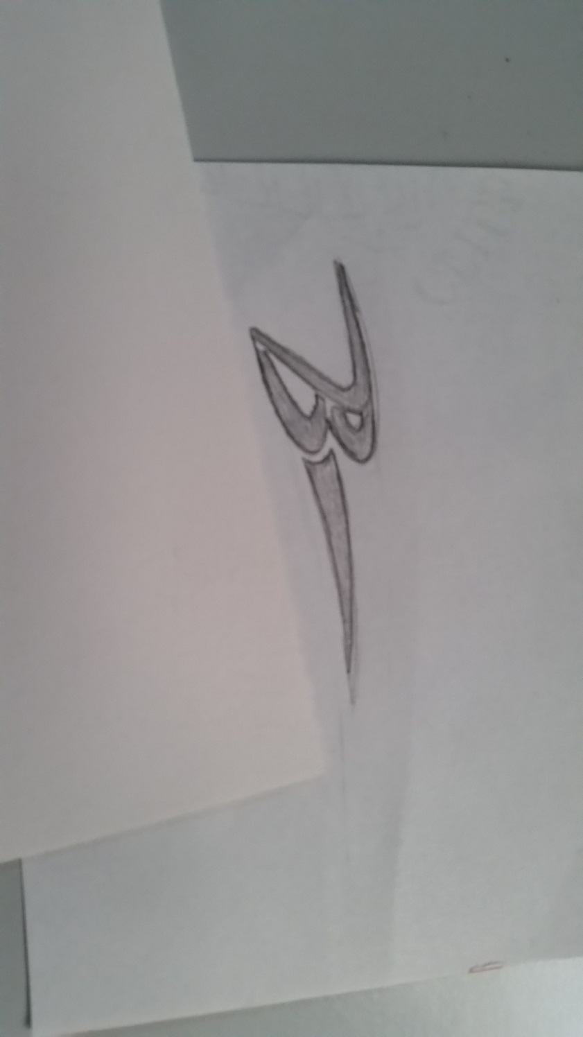

    Trying to come up with something to do for an inlay on the recessed part of the headstock, this is the current idea. It will be white MOP on a black background.

    Looking good. If I were to do a hollow body I'd probably pick this one. Great work on the headstock and binding fix.

    Wow, that finish looks unbelievable, well done!

    Oh my, that is looking amazing NW. Wonderful job.
