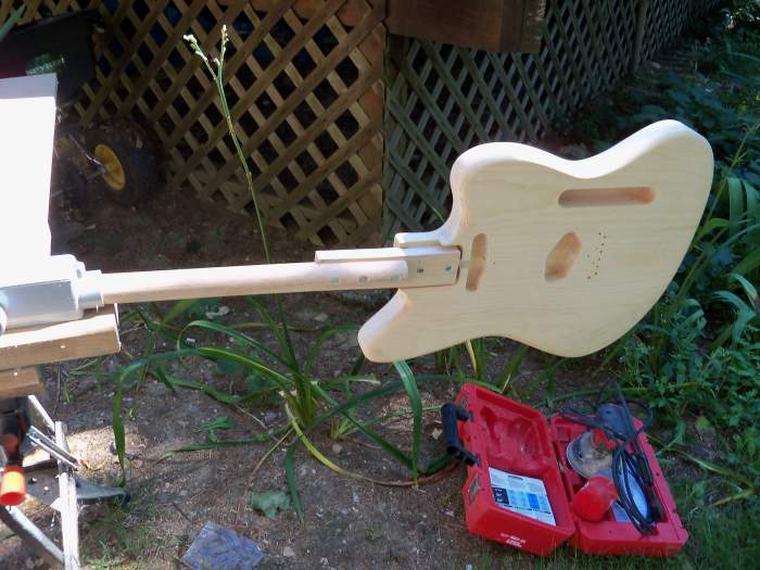

    Hi mates!
    So today is a windy day again in Greece so no painting is gonna happen today.
    I've masked the cavities of the body and i'm trying to find out how to hang the guitar for the painting process.
    I've seen the hanging method with the thick wire but i doesn't look so good to me.
    I'm trying to think how to make a DIY hanger tha can hang the guitar horizontaly (parallel to the ground) and maybe a way to rotate the body while painting.

    Something like this..
    Does anyone have a tip to share??
    How did you do the paint job??
  7. #37
    Hi George, if the guitar has a hole for jack plate I generally put a dowel in there impale it that way, then do the neck on the bent wire system. If no jack socket I do what you have pictured with a fake neck. I have a small vice mounted on a short plank that I can clamp to a table, fence post or anything other handy place and hold the dowel or fake neck.
  8. #38
    Member D.K's Avatar
    May 2015
    Townsville N.Q.
    131
    I normally just hang on wire through one of the neck holes, on a strat this area is covered with a plate in the end anyway. When I did my blue strat you couldn't even notice any marks before the plate went on.
  9. #39
    I bought a wooden 'lazy susan' turntable (not sure what you'd call them in Greece) like this one from Ikea http://www.ikea.com/gb/en/products/t...-art-90074483/ , then put a bit of cloth on it. You can only paint one side of the guitar at a time, but you can do the sides as well. and they always benefit from a bit of extra paint and it's easier to sand-through on the curved edges, and the top edge gets the most wear from your arm once you start playing it.
    In reality, if you simply put a bit of cloth on the bench that's smaller than the body, then the body will happily rotate on the cloth if you pull on the body.
    Certainly painting it flat produces less runs, but you can hang the body up and do it both sides if you're careful. Just don't hang it up too high or you won't be able to spray the top edges around the neck pocket properly.
