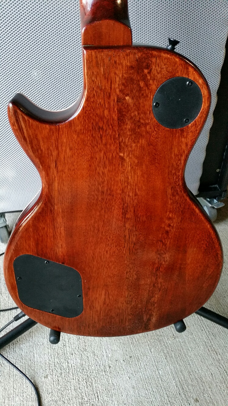

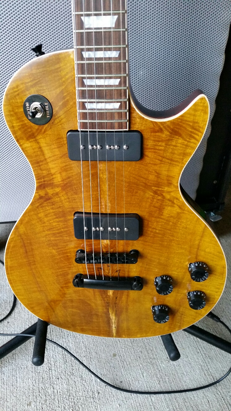

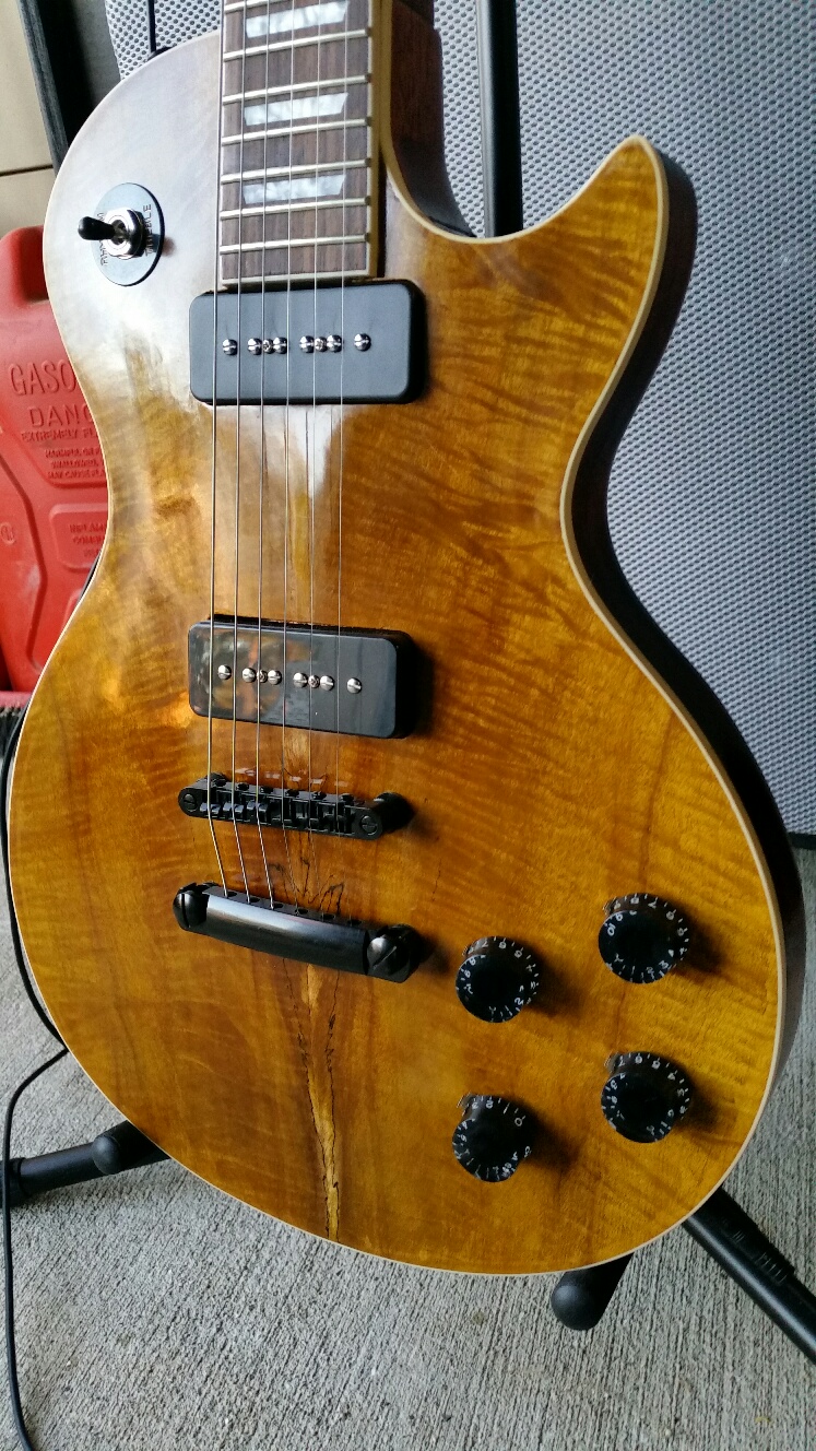

    Cool Marcel's LP-1SSP -- Pretty well completed
    Okay....
    I spent a considerable portion of yesterday and today putting everything together, bolting on hardware, soldering and stringing up.. and then a few minutes (seriously, it was probably less than 15 minutes) intonating and checking for that elusive fret buzz....
    It now boasts the following....
    French polished Shellac on all spalted Maple that has been coloured with my own mix of Yellow & Brown Keda dye, then U-Beaut wax buffed to shine.
    FW Jarrah stain on all Mahogany then covered with 2 coats of BC sealer filler and then 4 coats of BC Tru-oil.
    Push back cloth wiring (A.k.a .'50's style wiring) on all signal paths.
    Brown drop 0.047uF caps.
    PBG neck P90
    Yibuy bridge P90

    Identified the tone control issue which turned out to be two issues.
    I had put copper foil under the pots and the pots have tags on them that hang down... Well, I had a short to ground on the unused tag... first problem sorted.
    Second problem - Wasn't happy with the range of both the tone controls. In addition to rolling off the highs on both knobs it almost became a pseudo volume control at maximum high cut, and I knew I didn't have any short circuits, so I concluded that the installed caps must be the wrong value... Replaced the 473 brown drops (kit was supplied with 473 green caps) with 223 orange drops and both the tone controls now work as expected.... All the general chatter that I'd seen elsewhere about what size caps that typically go with single coils and with humbuckers must have sunk in.
    Had a play with the action.... High E is 1.5mm and low E is 2mm @ the 12th fret & still nil buzz... Sweeet!!!
