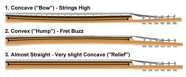

    When you say that the neck is 'still slightly curved towards the strings in the middle of the scale', can you just confirm that you are saying that the neck has a slight upward/convex bow to it, rather than the slight downward /concave bow in the middle that you would expect?
    If so, the truss rod needs to be loosened (rotated anti-clockwise). From loose, tightening it first reduces concave bow, then makes the neck flat and then introduces a convex bow. See the diagram below which should hopefully remove any terminology misunderstandings.
Name:	Truss Rod Diagram.jpg
    So if your neck is slightly convex, you need to loosen off the truss rod. Depending on how well levelled the frets are, you can get away with anything from flat to quite concave (never convex), but the best overall action without buzzing is normally found with a very slight concave bow in the neck.

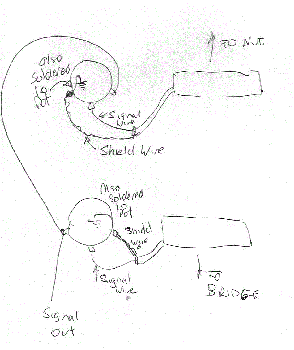

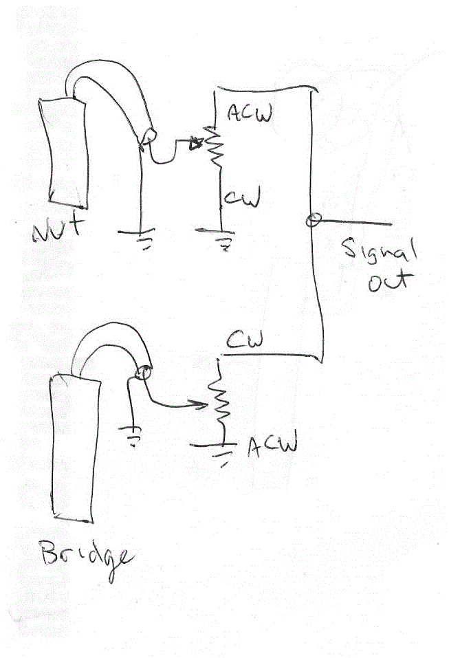

    Both my other left-handed guitars use conventional pot wiring: ie, clockwise makes it louder.
    The wiring on the JB is not standard pot wiring anyway.
    With a normal volume control, the signal source (ie pickup) is wired across the two outermost pins of the pot, with the shield connected to the "anticlockwise" pin. (Anticlockwise looking at the knob side). The amplifier connection is taken from the centre (wiper) pin, with its shield also soldered to the anticlockwise pin.
    In my Bass, the pickups are wired with the signal ("active") wires going to the wipers of the pots; on the pot for the bridge pickup the shield wire goes to the "anticlockwise"pin, and the signal is taken from the clockwise pin.
    On the pot for the other pickup the shield wire goes to the clockwise pin, and the signal is taken from the "anticlockwise" pin.

    I know the reason for connecting the active signal wires to the wipers; because there's no selector switch, if they were wired in the conventional way, turning down the volume on one would also turn down the volume on the other.
    I really just need to know if swapping round the output and shield pins was intentional or not. I can easily re-wire it.
