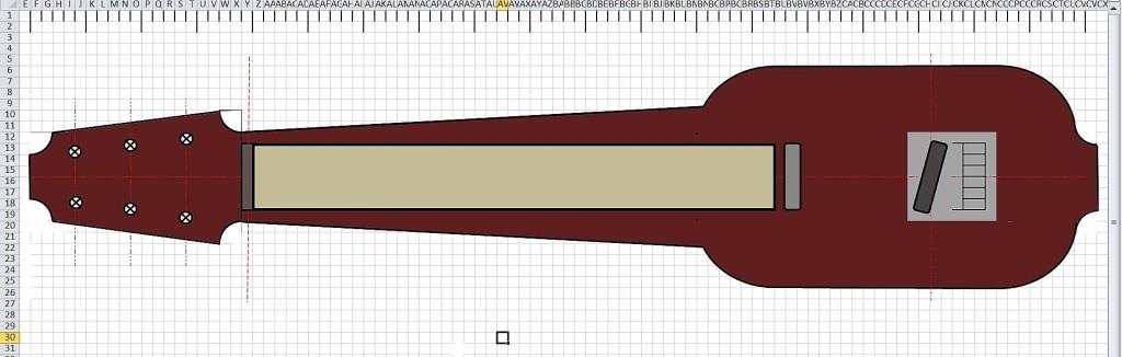

    Hi
    Draft No 3. Not exact to scale , but close! Any obvious issues? Feel free to critique, gotta jigsaw lined up for weekend, itching to get underway. no router or drill press in my circles, think its going to be carefull hand drill and chisel job.
    all advice appreciated. Guvna

  10. #40
    Guvna the design sketch looks great, sure it will work fine. Assume you will have a rear control cavity and jack on the side on the treble side of the bridge
