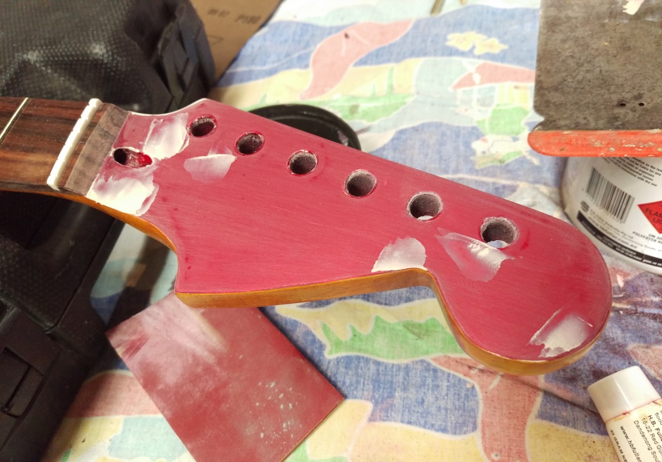

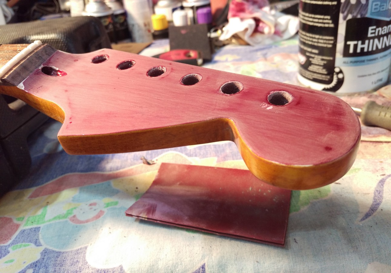

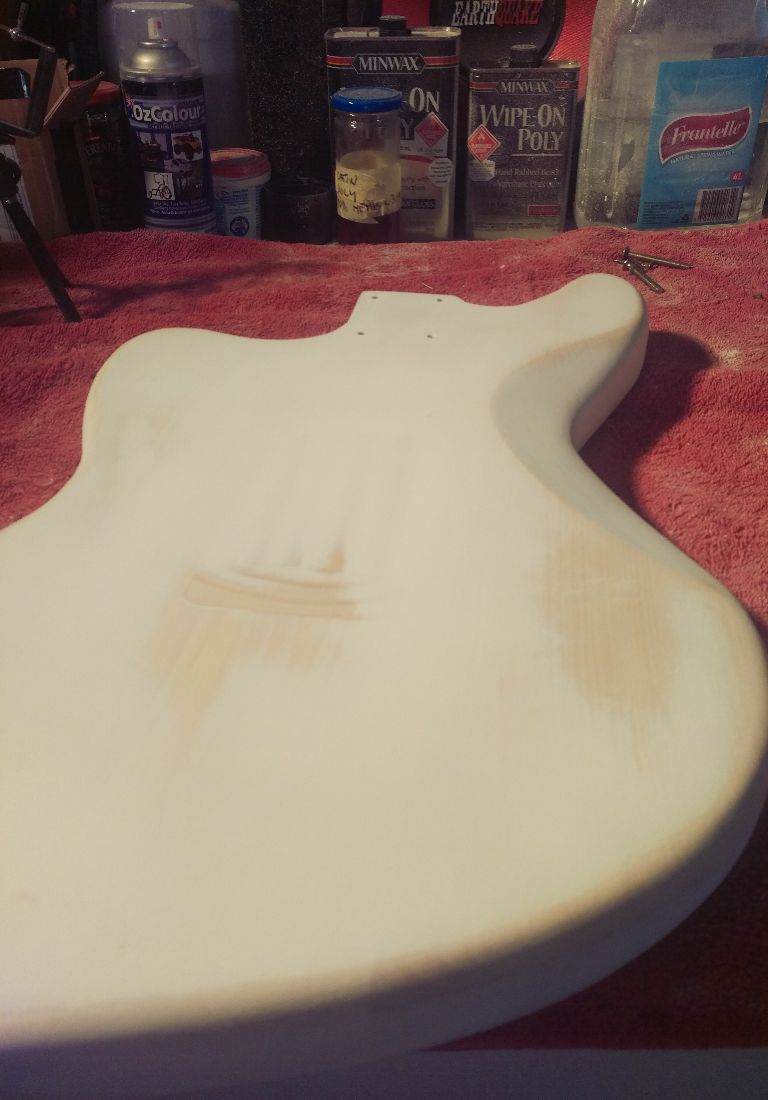

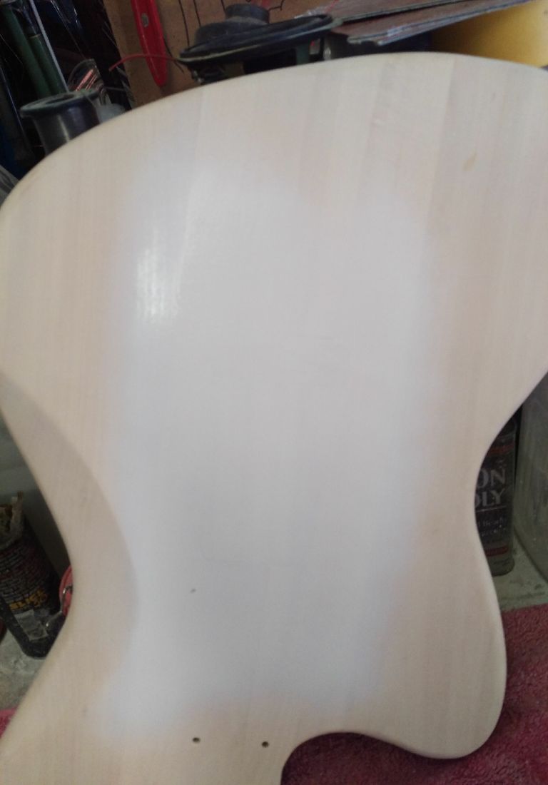

    Sanding the body
    Next stage.....

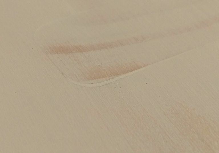

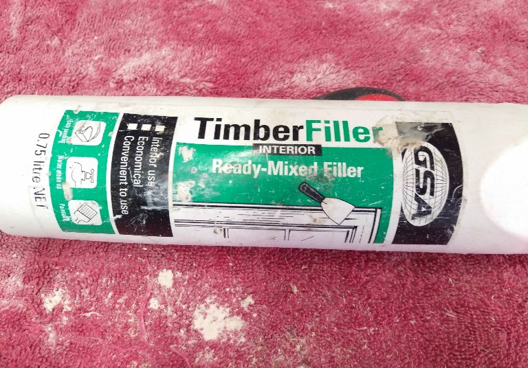

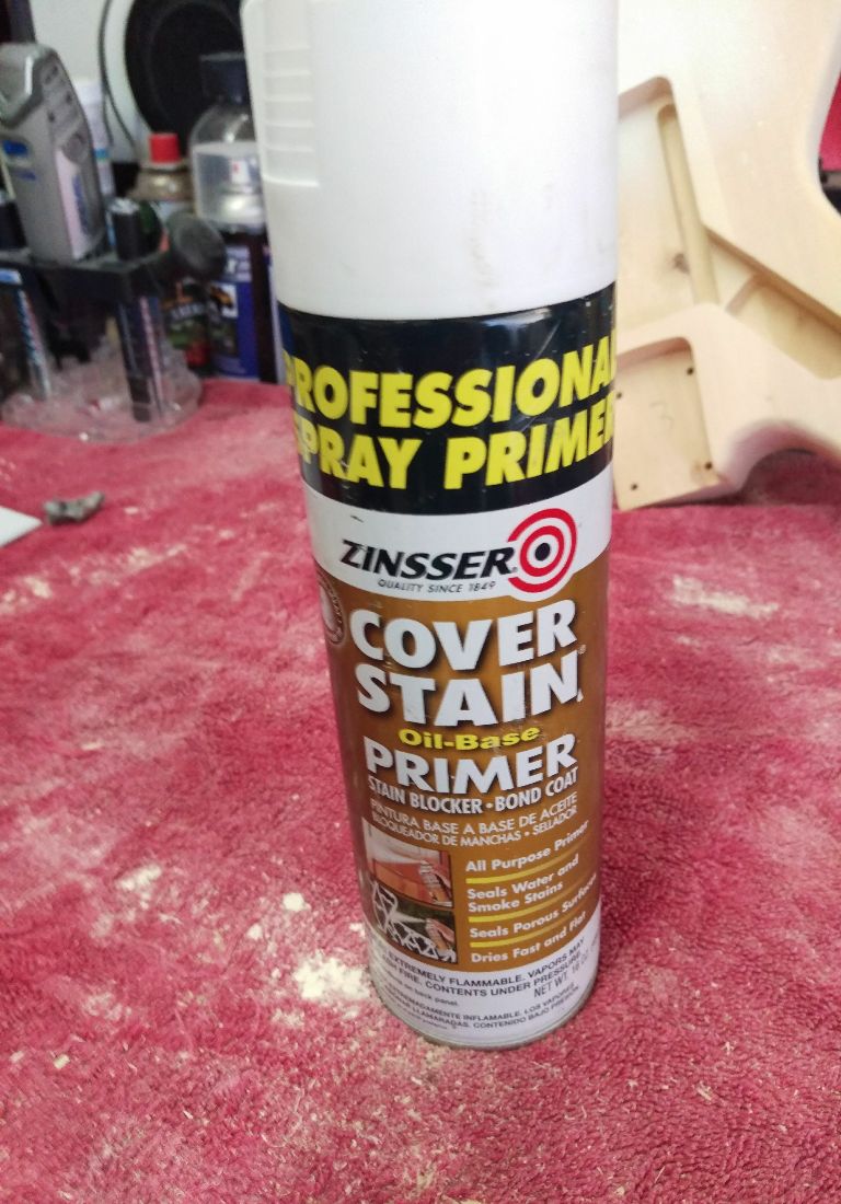

    After sanding the filled cavities i sprayed a good coat of sealer primer and let dry. This was done to show up any high or low spots when sanded. The low spots i filled with a ready mix timber filler that sands up super fine.

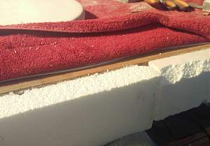

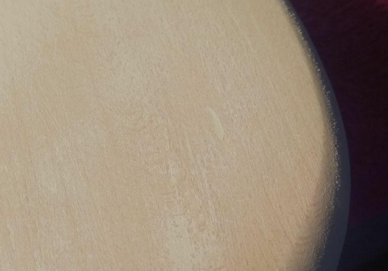

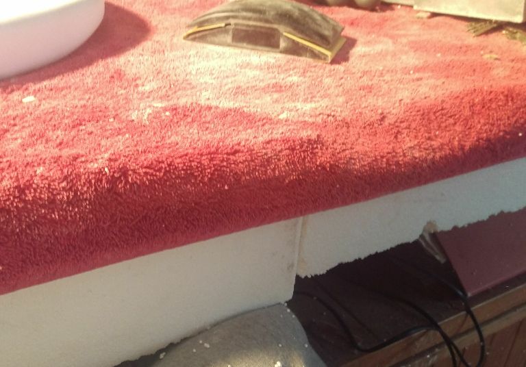

    I wondered why i kept getting dents on the edges of the guitar body ever time i sanded it..Duh... edge of bench! I soon fixed that.....polystyrene and a hot glue gun.

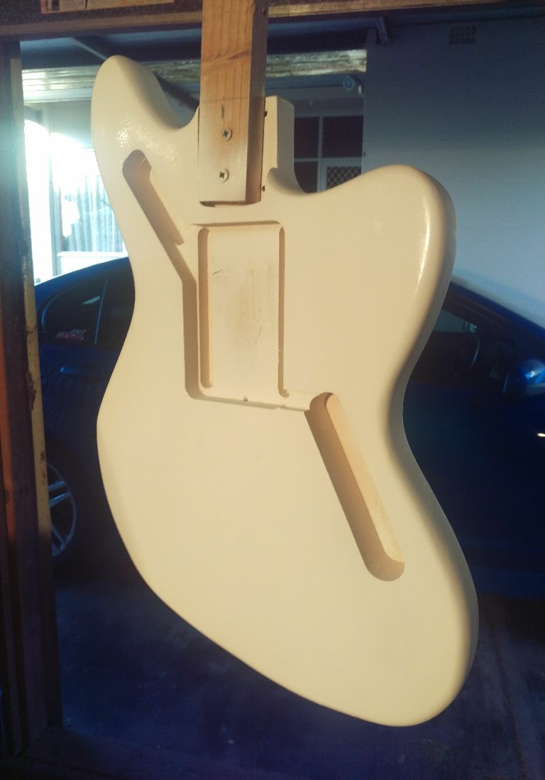

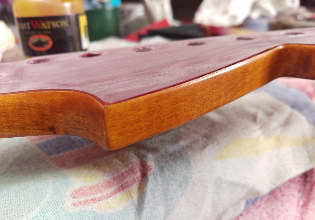

    Next... lots more sanding and a final few coats of primer.

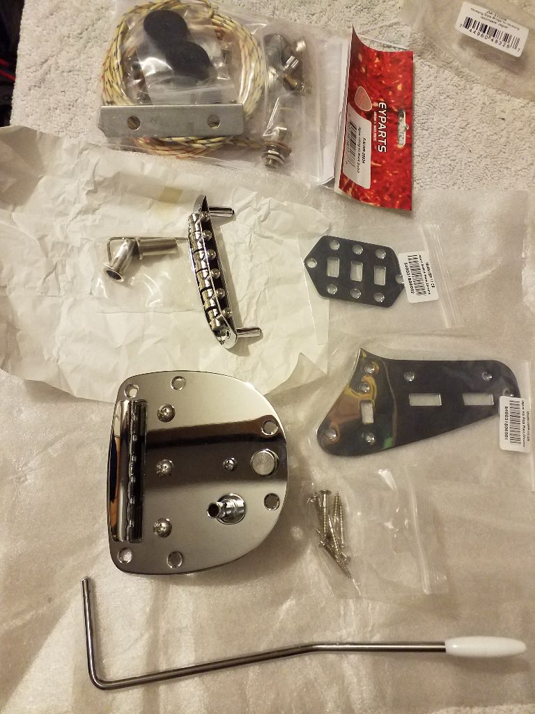

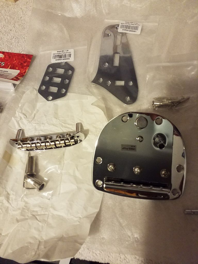

    And finally some more goodies arrived in the post today
