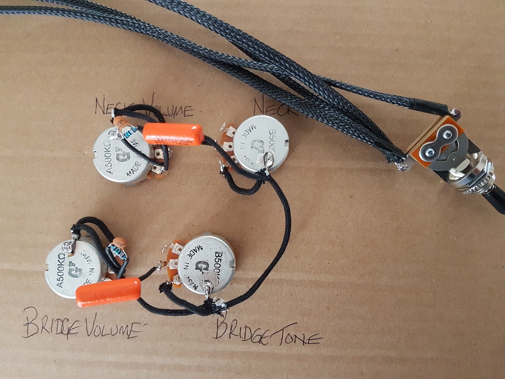

    looks ok to me Rossco but I'm no wiring expert at modified circuits. What does the resistor/capacitor combo do between the 2 lugs of the volume pots ?
    G'day, Its supposed to help retain tonality (if that's a word) when you back of on the volume. I seriously doubt it will make any difference to my ear, but what the hell, give it a go, its all a bit of fun.
    ah got it Rossco, sure you can buy a pre-made treble bleed circuit from Realparts.
    You can buy a treble bleed circuit here at PBG...
    https://www.pitbullguitars.com/shop/...elity-upgrade/
    Very easy to do your own though
    Yes, doing my own, got a Jaycar about 2 mins away.
    Need a path to ground on the lower lug (as drawn) of each tone pot.

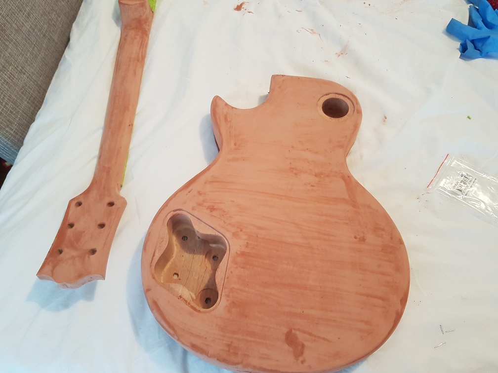

    Pissing down here today, so with the humidity not great drying day, so did some soldering instead. That and masking. May get round to timbermateing this afternoon if it looks like it will dry.

    Mahogany timbermate applied. Will leave it till tomorrow to sand.

    Nice soldering! And is that a glue spot on the back of the body?
