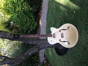

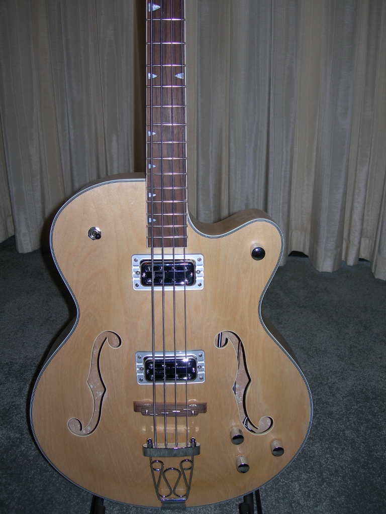

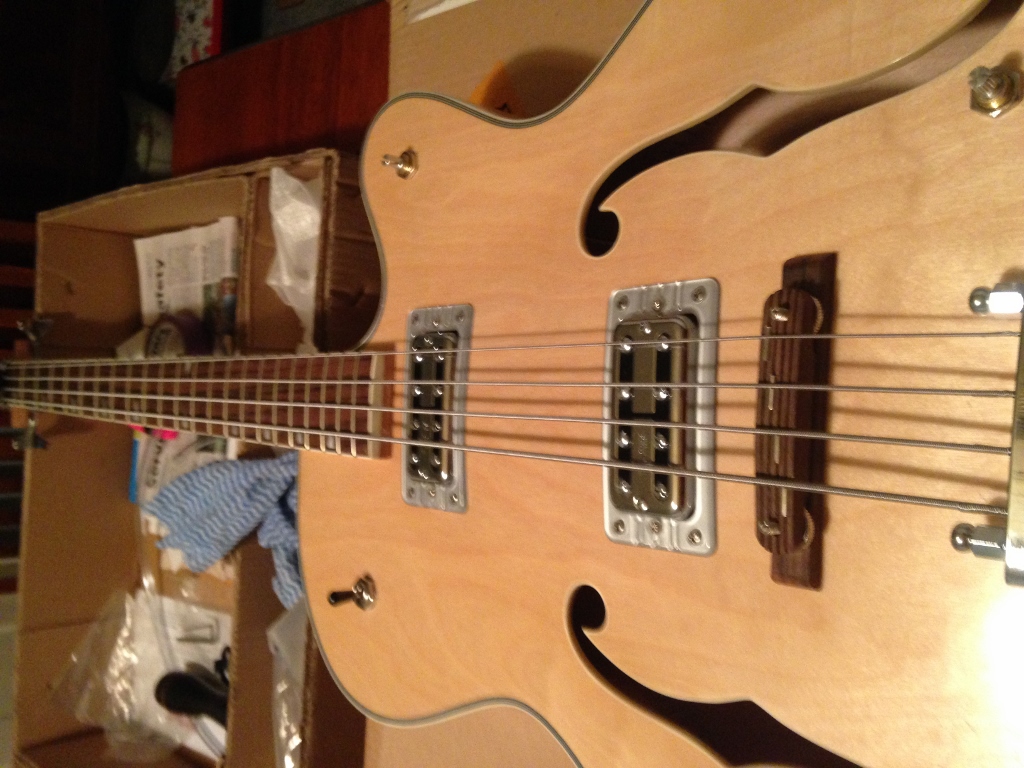

My first kit and first arch top. I have decided to go with the blonde look. Deciding on a finish was the hardest part so far, so blonde will allow for future changes of mind.

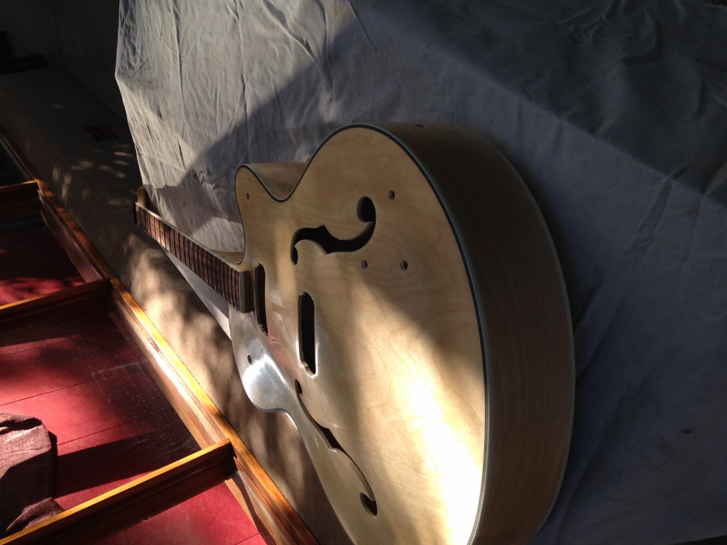

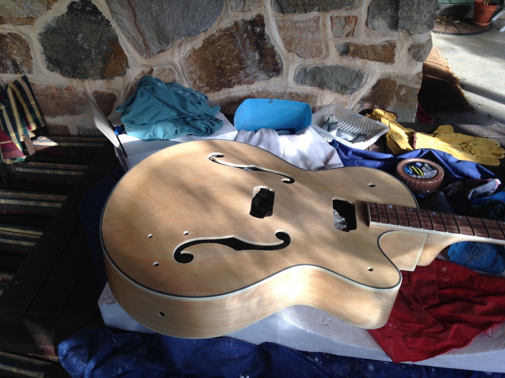

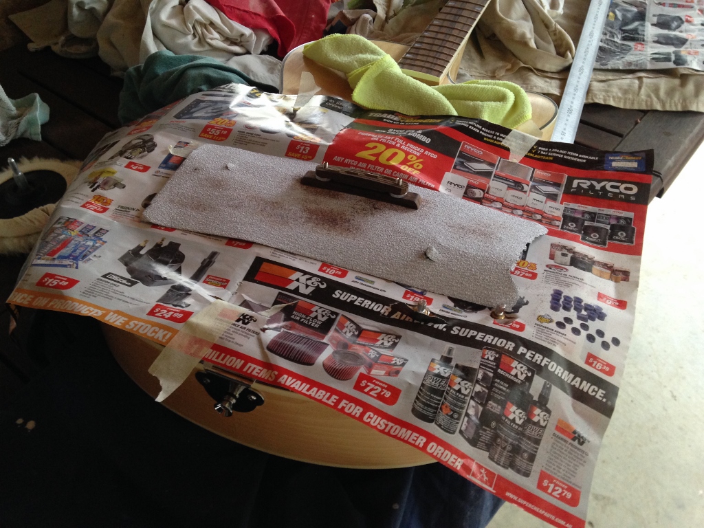

Sanded back with 120 grit, then 180, then 240. I sanded through the veneer at one point on the side. It adds to the 'hand built character'. So please be warned not to sand too far.
Sprayed a coat of sanding sealer then rubbed back with 400.

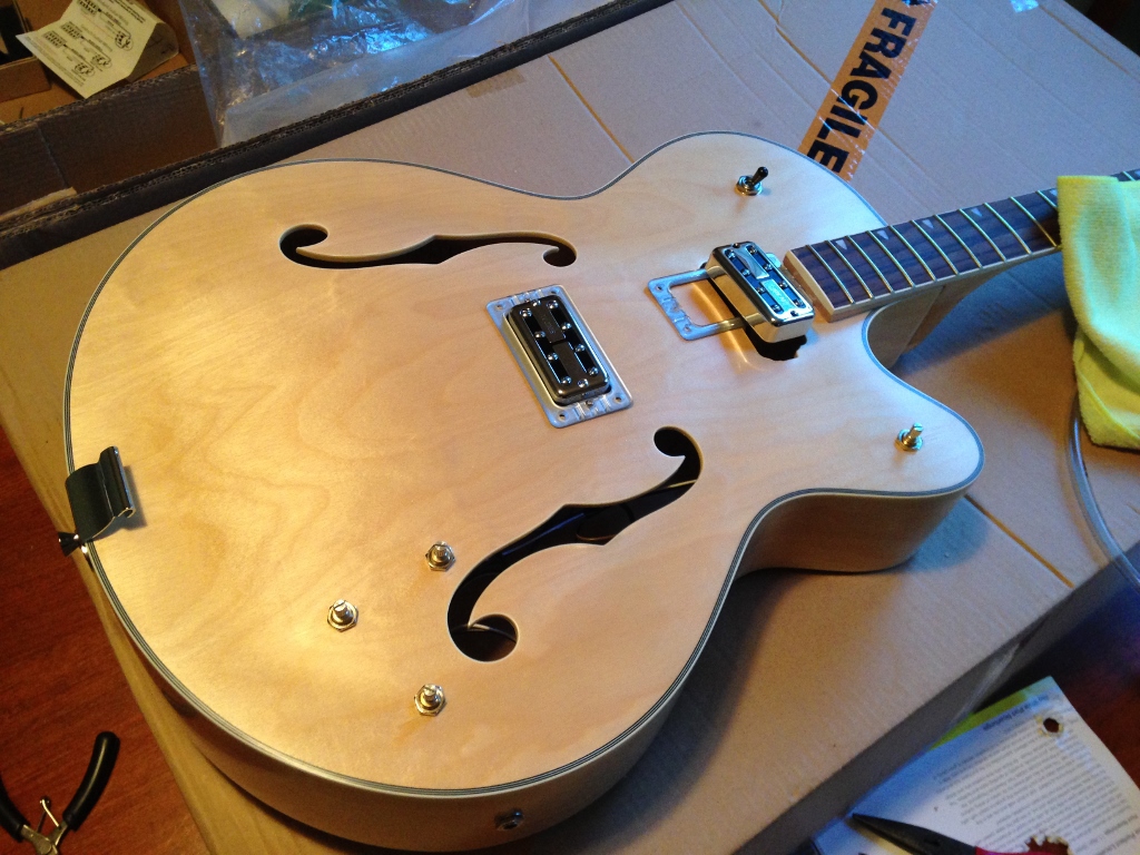

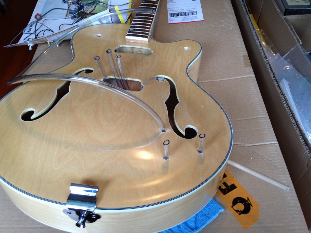

Today I applied the first coat of clear. I used Feast Watson Weatherproof gloss.Click image for larger version.
