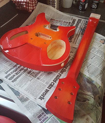

    Got permission to use the kitchen for spraying. All windows wide open and extractor going full blast. Done 2 thin coats and a rub down in between. Starting to get to where I want to be.

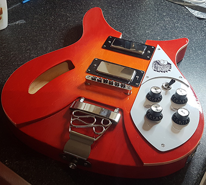

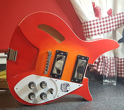

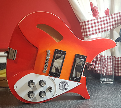

    Phew! Nearly there. Just got the neck to set in and it's done. Been a lot of work, due in part to rough finish of body when I got it. Plus there were no pickup ring screws in pack. God bless Amazon. All in all Been an enjoyable if challenging build. Hope it plays ok. Setting up is my department so don't see too many problems. (famous last words)
