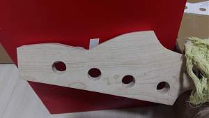

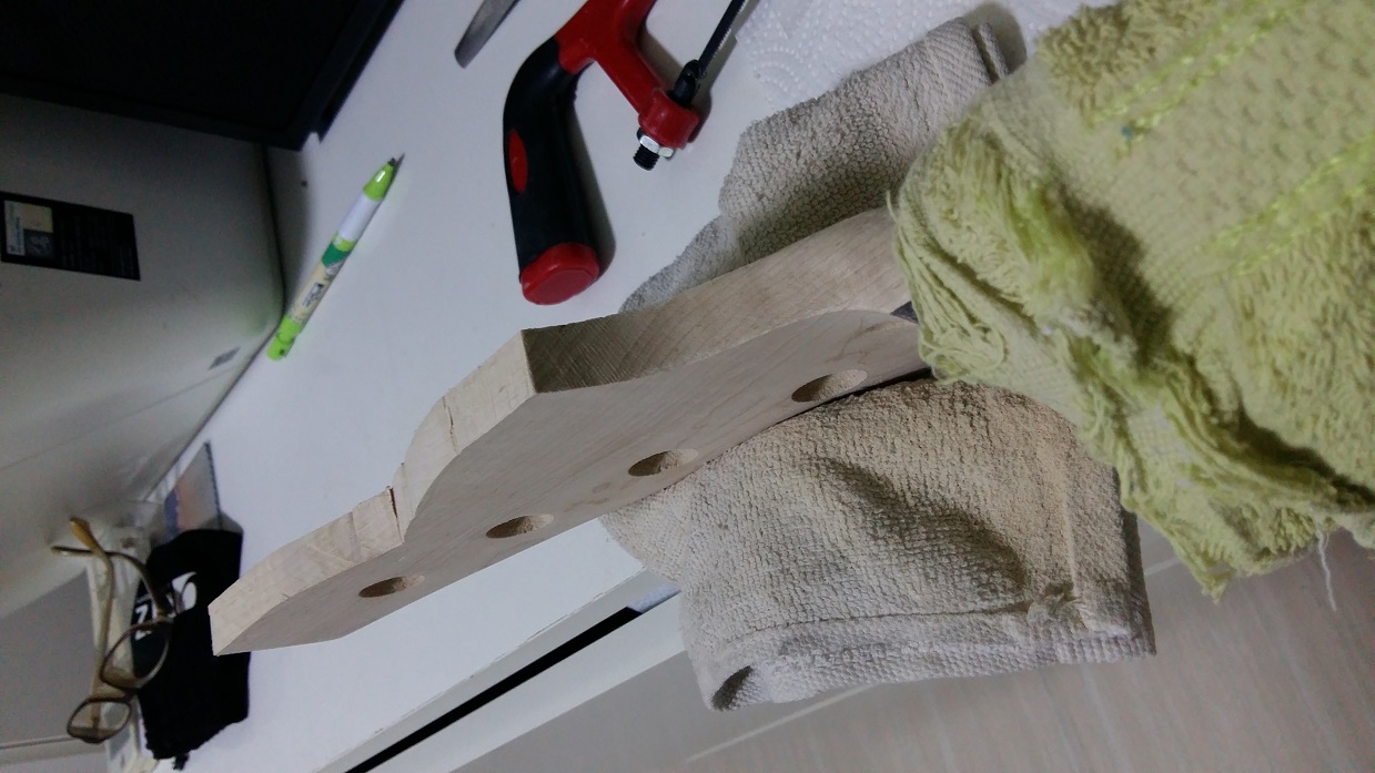

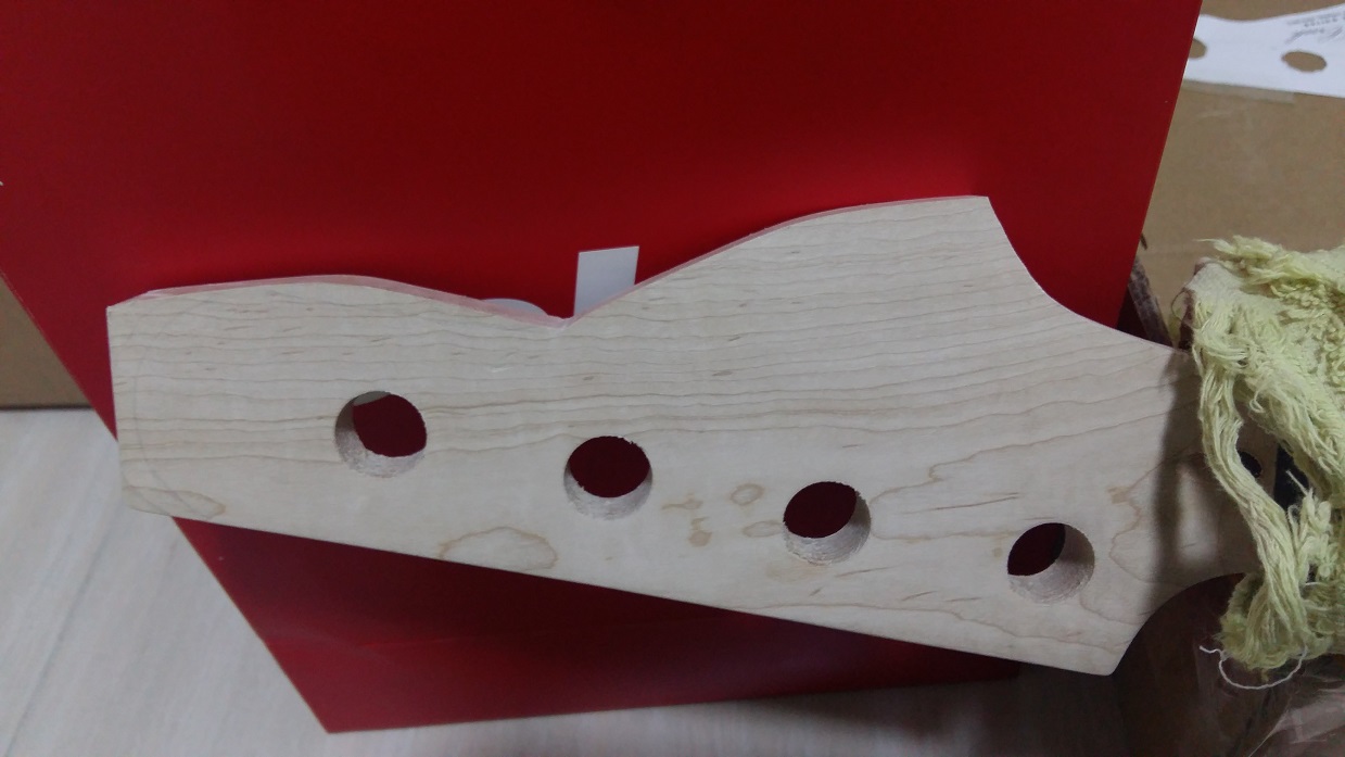

    While I continue sanding body marks and spots, parallel working on head stock shaping.
    I took reference from the one from Milancon guitar and drew the shape on the front and back of head.

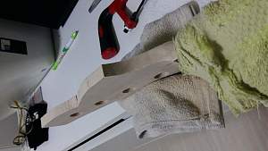

    have only hand-saw, slowly and carefully cut it out, taking buffer from the line. but very weirdly done...

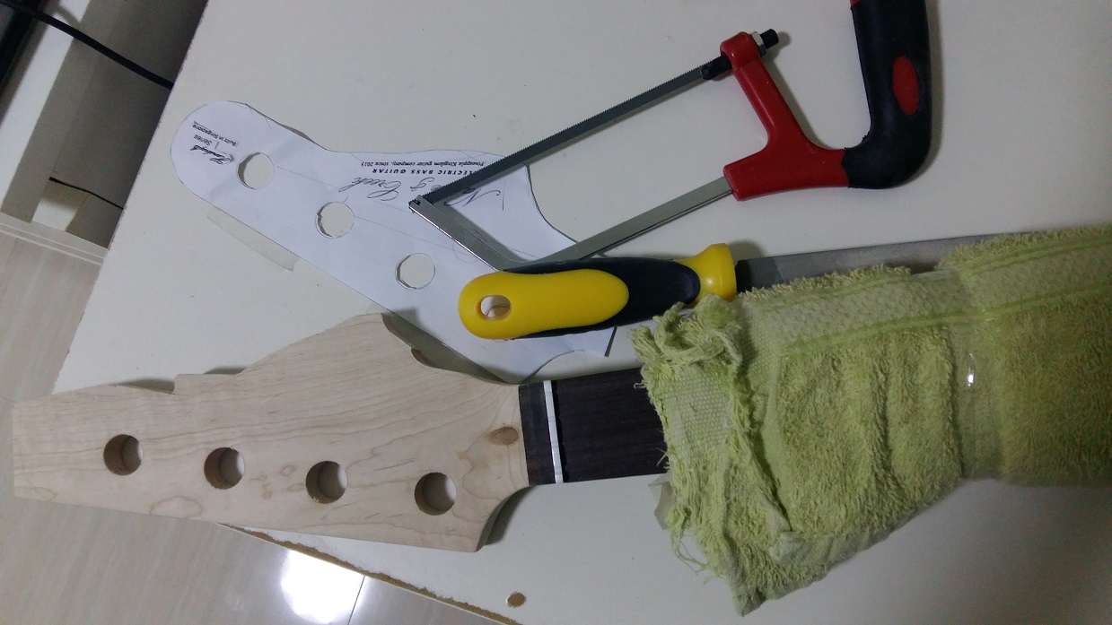

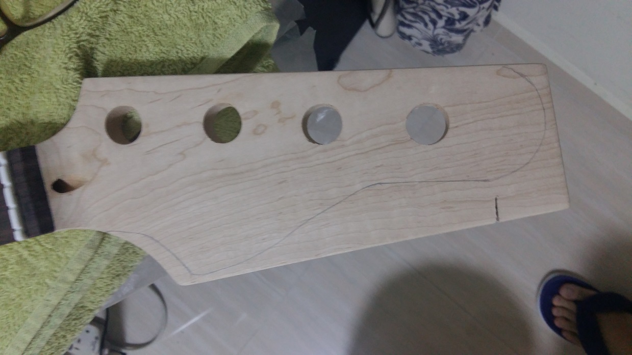

    bit difficult to cut small and thin part, have decided to go for using file to shaping head.

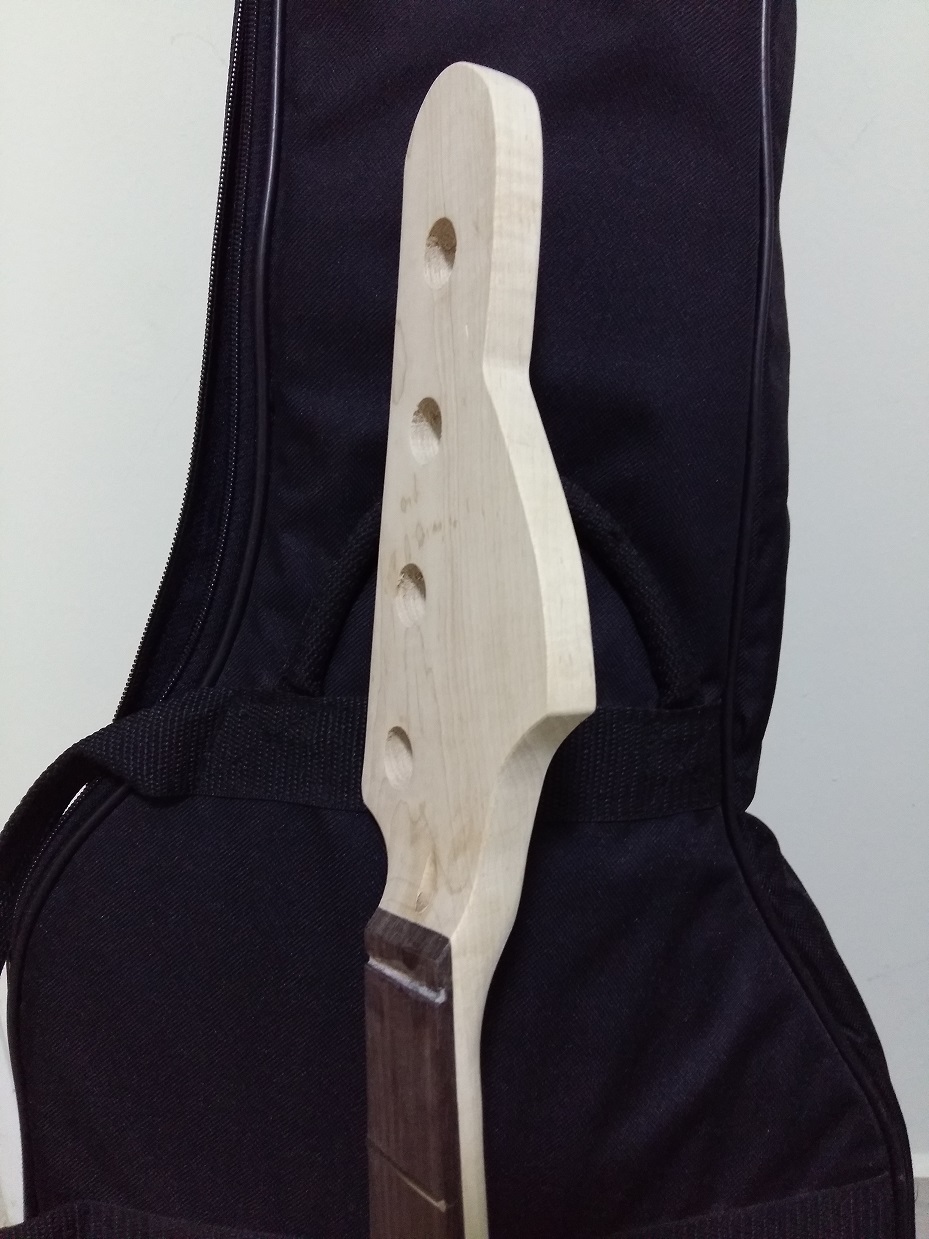

    After long and hard work, finally it became look like guitar head stock...still did not reach to my expectation though.

  7. #37
    original headstock shape Toshi looks pretty cool. I'd probably do a bit more sanding to get the curves flowing and try and eliminate any rounded edges that aren't round, if you understand what I mean. Sorry buddy but you will be a sanding expert after this build hhaa
    Another thing you can do is place the headstock over the body shape and I try and emulate some of the curves of the body and horn shapes.
    You have done a good job with limited tools and I assume in a small apartment where you can't create too much dust without upsetting the wife !

    Hi Wok, Thank you for your advice as always! Thats the direction i needed. hahaha hope to be good sanding expert. yup, I would place the headstock over the body shape and amend little by little to make it as nicer as possible. wish my wife patience last longer.

  9. #39

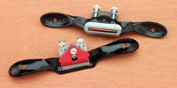

    I believe we ALL wish for wife's patience to last longer!
    If you can get a hold of a small spokeshave:Click image for larger version.
    a cabinet scraper: Name:  Scrapers.jpg
    or just a Stanley knife blade and some good gloves: Name:  Stanley knife.jpg
    then you may be able to use them adjust the curves slightly to get it exactly where you want it.
    I've done a lot of headstock shaping work with scrapers and they can be handier and less work than files, as with files you've then got to smooth out the file marks. Don't know if this helps but I thought I would suggest it as an option for you.
