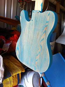

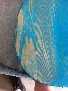

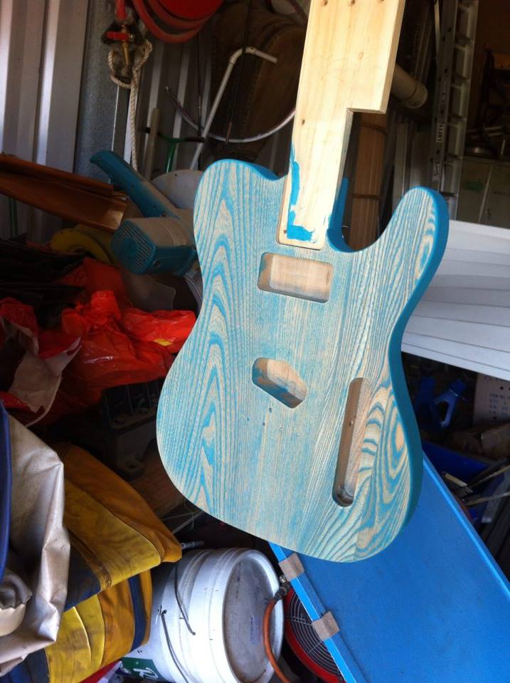

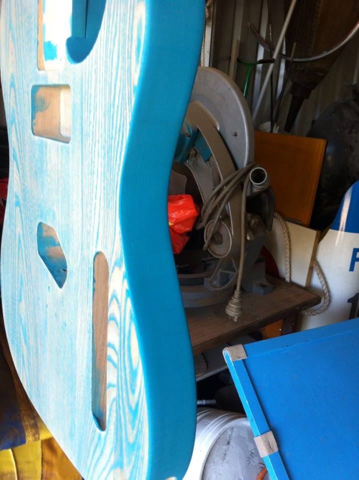

    Thanks for all the help with neck/fret work stuff. I'm hoping to get onto starting the leveling process soon
    In other news, was preparing to put clear coat on the body and decided that I really wasn't happy with how the paint had gone on. Decided to sand back quite a bit and apply another coat to see how that went. So, I was slowly sanding away and this emerged:
    And I thought, 'that's kinda cool, I'll do some more and see what it looks like'. Basically, long story short I sanded the front and back back until it's just the blue sitting in the grain, and then put another coat of paint along the side so it is a really solid blue. Heaps happier with this finish (still clear coat to go) and happened upon it totally by accident haha. Looks like this so far, just a little bit of cleaning up around the very edge to go before clear goes on

    That's the beauty of Ash grain shining through. Too good to hide that grain pattern under a solid colour.
