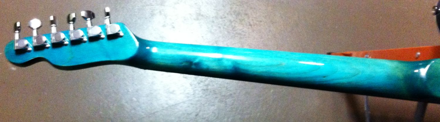

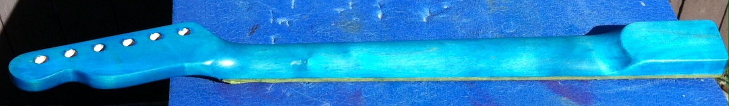

    Maple grain can also throw a bit of a shaded look too with a stain on top, just like the effect on shag pile carpet where from one angle it looks flatter and less dramatic whereas from another angle there is much more definition.
    Check these out as examples of what I am talking about....apologies for the resolution as just using iPhone 4to take shots.
Name:	photo 1 (5) back of neck.jpg
ID:	16045Click image for larger version.

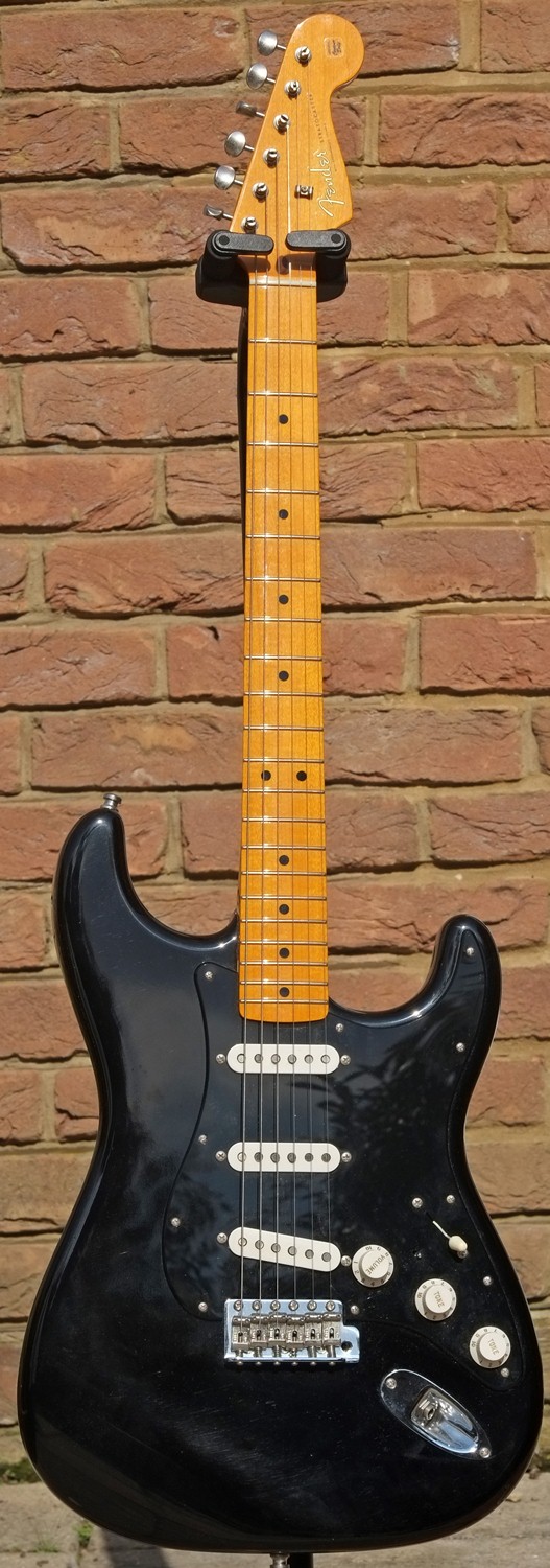

    I like it. It's probably just a slightly lighter tint than the neck on my DG Strat, so it's in good company.
