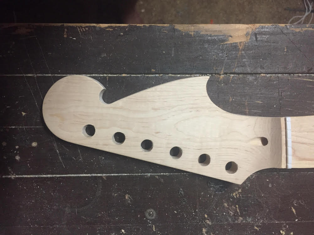

    Oh, and I took a little more of the headstock to give it a better wave feel!
Name:	130117 headstock final shape.jpg

    nice stock shape Chuck that will fit in with the surf theme nicely !
  6. #35
    Quote Originally Posted by Chuck View Post
    Yep, yep that's looking fairly surf right there. Love it!

    Absolutely killer headstock mate
  10. #39
    I think you could do some damage to someone with that headstock...or catch a fish. Looks cool Chuck

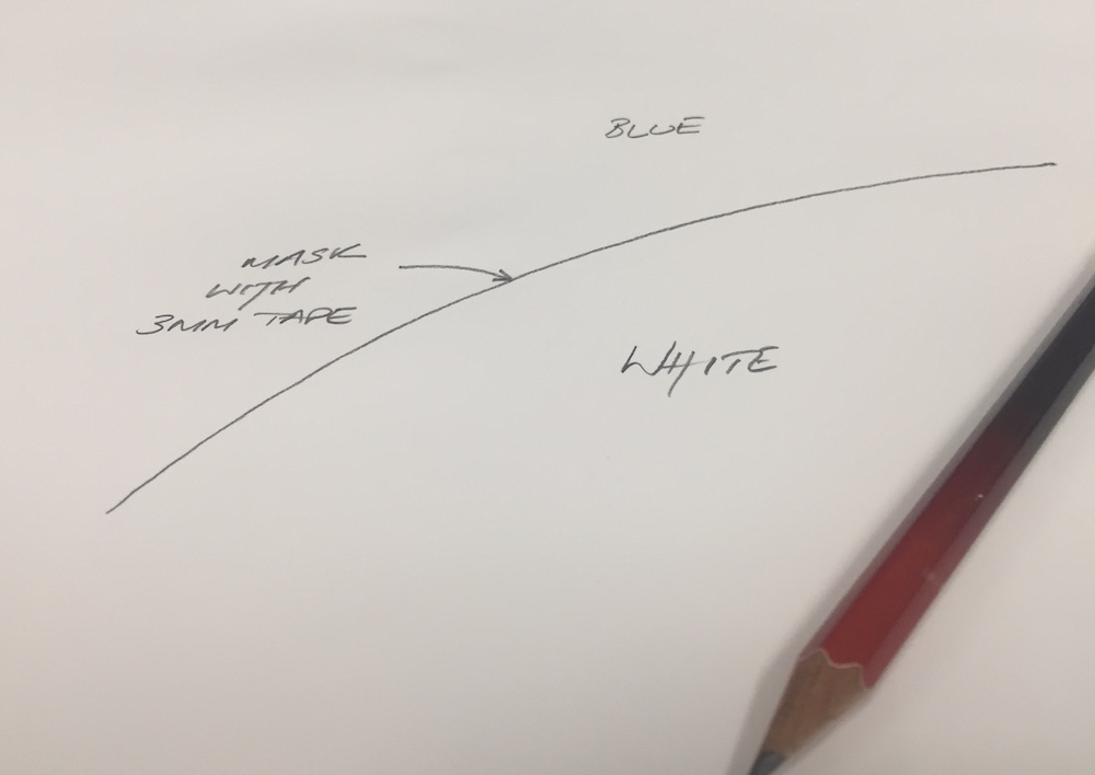

    Slowly making progress. Body and pickguard are primed and another coat will have the white base coat done. But now question for the painting experts as anything more than a single colour finish is new to me!
    The illustration shows what I’m doing – the body is painted white, and I’ll have the centre section painted blue. I figure I’ll use 3mm pinstripers masking tape to create the curve, then wider tape and newspaper to create the mask. The thing is I want a black keyline between the two colours.
    I figure there are two options: 1) leave the masking in place, then create a second masking line 1mm wide on the blue part, cover all the blue with paper, then spray the line with black. Option 2 would be to finish the blue section, then take all the masking off, then mask .5mm on either side of the paint “join” line and then spray that bit black. I think the advantage of this is that I won’t be building up two layers of colour next to the white, but on the downside it will be a bit fiddly.
    What say the brains trust? Or any other ways of doing it?
