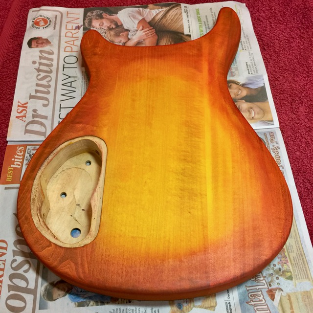

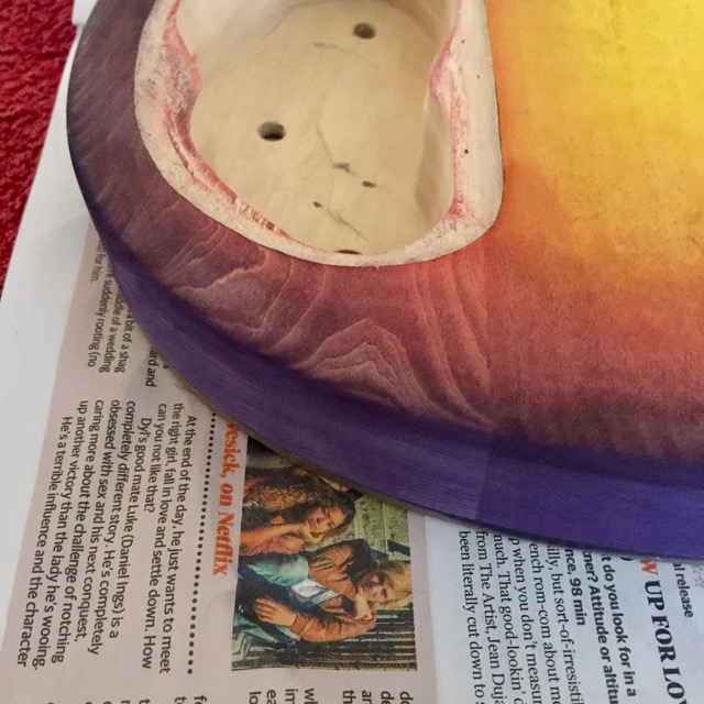

    Staining the Back

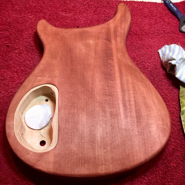

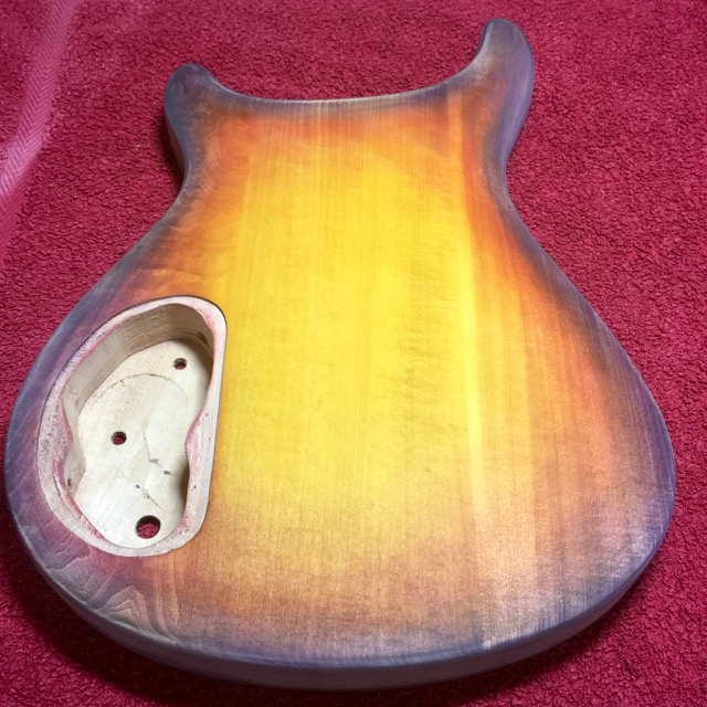

    I figured I'd start with staining the back. That way if I needed to sand back to wood as I learn how to use the stain I could. I did and I did.
    The original idea for the colour scheme was to be purple on the sides transitioning to red on the back with yellow in the middle as a red to yellow burst.
    I started with a coating of a colour called cedar to highlight the grain under the red and yellow. Sanded that back and it had highlighted the grain as I wanted. Next, I applied the purple, red and yellow. I wasn't happy with the way the end grain soaked up the purple and was very dark, the colour of the purple or the blend from purple to red.

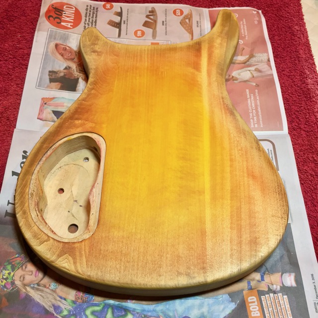

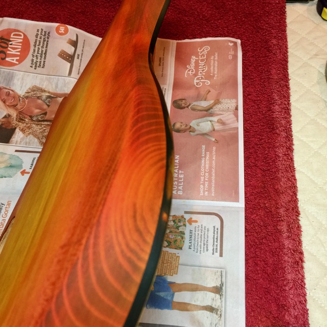

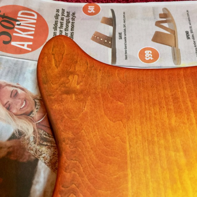

    the purple had to go.
    After sanding as much of the purple off as I could - there are still dark patches in the end grain - I started again with a more simple red to yellow burst.

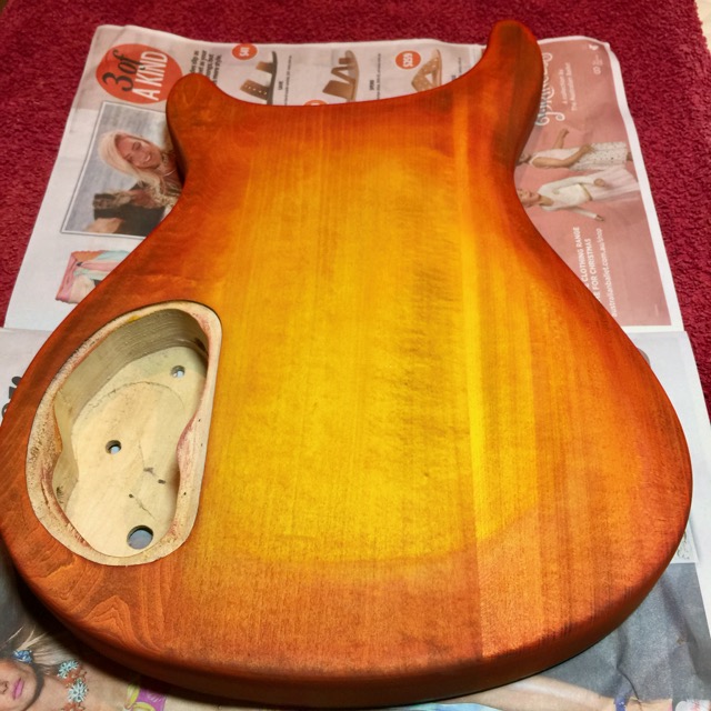

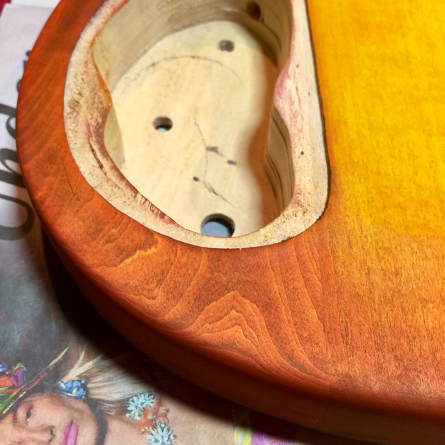

    Although it's not a professional job, I'm not completely unhappy with the outcome given I am still learning how this stuff works. The grain has certainly been highlighted.
    No on to the front/top...

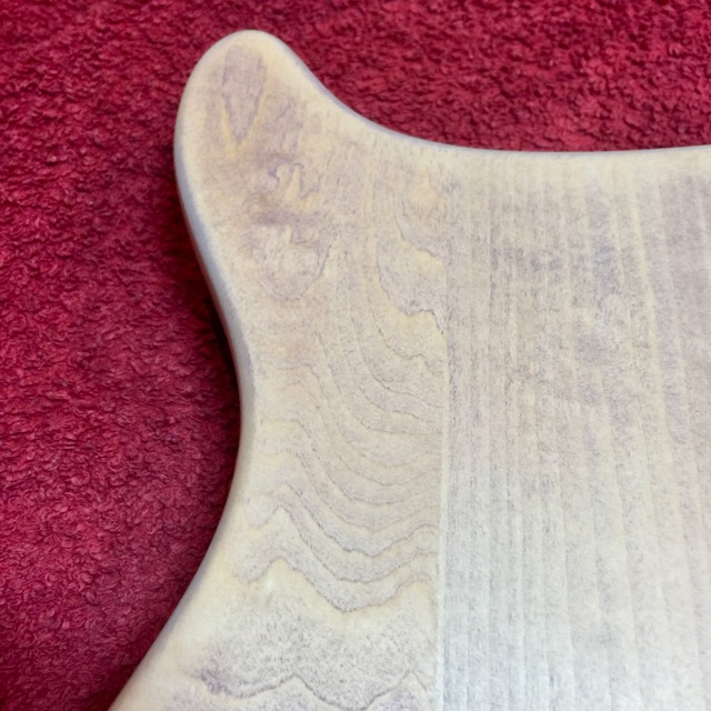

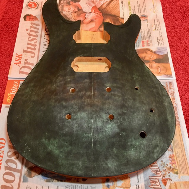

    The front starts with a coat of green/black for grain popping. I seem to have found the small amount of glue which I will attempt to scrap off.
