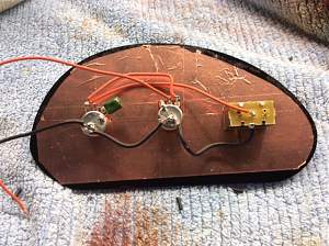

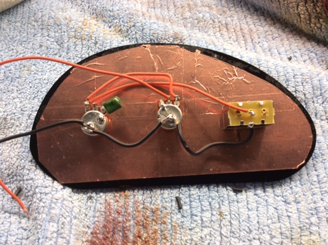

    Wiring as rk4004 with single volume and tone 3 way switch

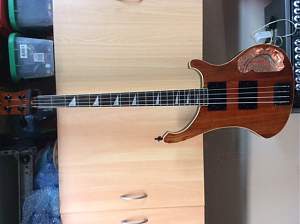

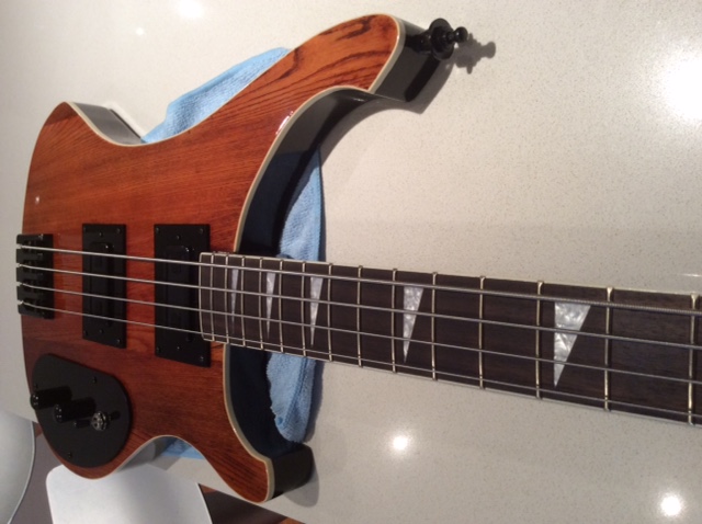

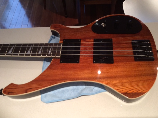

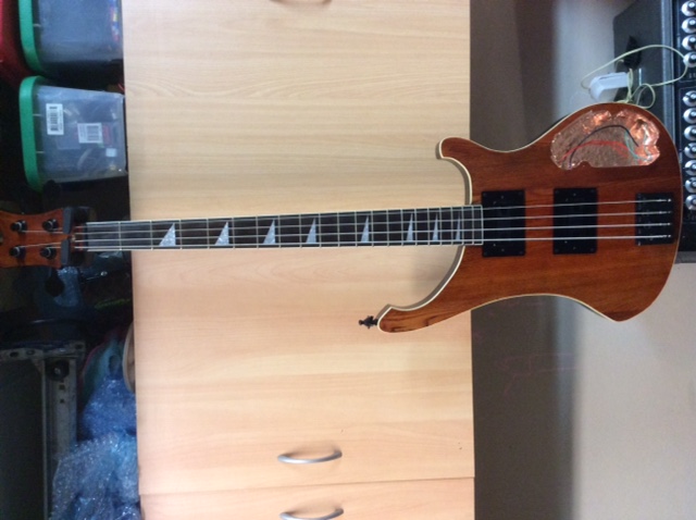

    Assembly complete. Now lots of work to do on the setup!

    come up a treat Andy well done, do both pickups work ok and you got any hum ?
    lots of setup but should play well after that
  9. #39
    Mentor Andyxlh's Avatar
    1,206
    Actually the setup isn't too bad. The bridge is not great, it doesn't have the necessary range of adjustment so I will have to adapt it by filing down the base of the adjusters which cannot be seen when fitted.
    I think the 5th fret is high and buzzes on the e and a strings between frets 2-4. The bow on the neck looks pretty good, it is close to straight with a slight concave bow. I haven't measured exactly what this bow is, but I don't have the specs for this neck, does anyone?
    The intonation was pretty good straight out of the box which was nice.
    I'll fiddle with the bridge and play it a bit before doing anything too drastic.
    No buzzes or hums from the electrics, but some wonderful tones through my guitar amp! Will look forward to wheeling out the SVT sometime over the holidays,,,
