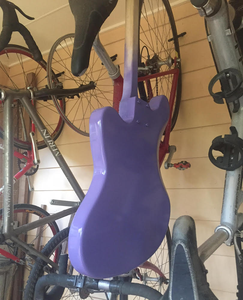

    Final gloss coat (of 10) went on yesterday. I think I did a much better job this time around in keeping the coats light but even, and using the "double header" technique more effectively. I also paid particular attention to spraying the edges of the body. First time around I realised I sprayed directly on the body, and directly on the sides, but left the edges potentially a little light on. This time I did a pass at 45 degrees to the body, directly targeting the edge all the way around every second coat.
    With some nice weather in Sydney I managed to find a good undercover but outside spot hanging off the brake lever of one of the bikes! Already a pretty decent shine on it before any cutting back and polishing.

    Last time I waited just 10 days before starting on the finishing, which I know as way less than many recommend. My key criteria was when the body stopped smelling of paint! I may have got a little lucky. I'll assess things the weekend after next ...

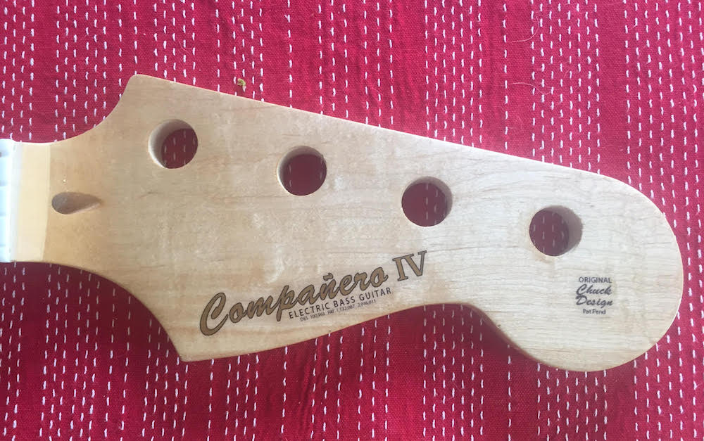

    Got the logo on last night... In case you're interested all the numbers on the patent pending stuff include my birthday, postcode, date of build etc etc - effectively an elaborate serial number!

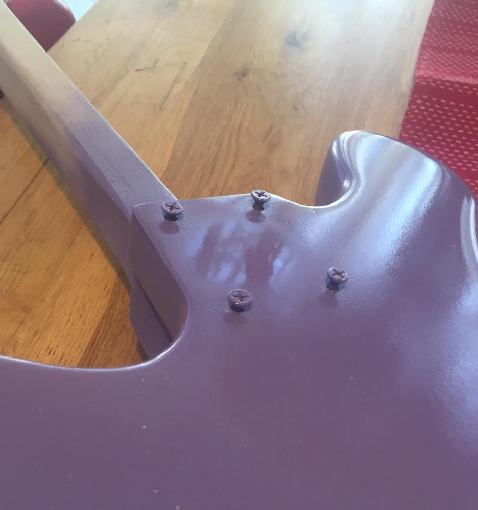

    Today marks 10-11 days since the last gloss coat so I did a quick test wet sand/polish (light rub with 1200, then with 2000, then a bit of Meguiers) - but only on the patch that will eventually get covered by the neck plate (just in case it's not as ready as I'd hoped!). I've just done that and it looks good (pic doesn't capture it that well). So now for some serious wet-sanding! The other interesting job I'll start on is a new pickguard. On the last one I just had to reshape a bit of the existing one, this time around it's a whole new one.
