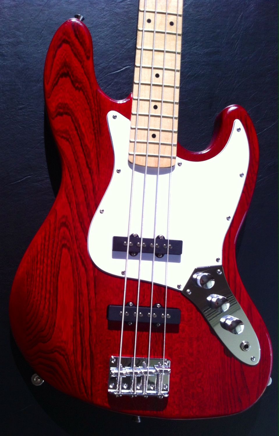

    Hi Greg, that natural finish on the Mahogany looks great.
    For a Dark Wine Red colour were you chasing something like this?
    This was achieved with mixing some Color Tone Cherry Red with a deep red fountain pen ink. There are plenty of fountain pen inks to be found on eBay if you go down that path as the supplier I used seems to have gone out of business.

    waz your red looks close to my mental image. I would be happy with it. I have found the ink is still available on the web. I have a supply of colortone which I will play with but know I have a backup with the ink.

    Cheers Greg. The Color Tone Cherry Red I used was watered down rubbish from the DIY Guitars closing down sale and on its own looked way too dull and washed out. Hopefully you have ended up with the full strength stuff.

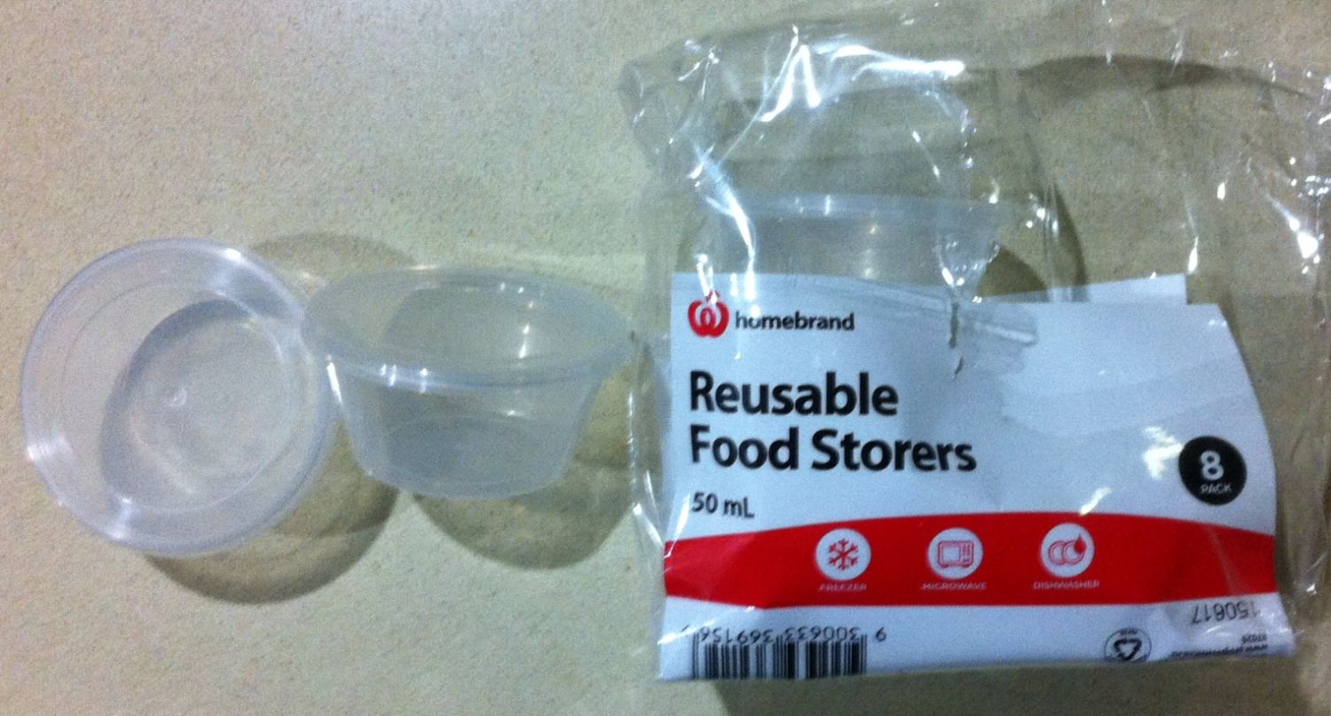

    Hi Greg, just a few tips to keep things really simple.
    The color tone swatch colours are not a good true representation as I also ordered their mahogany and it turned out more dark brown than red and ended up gifting that along with some unused DT to Andy for his SGD612.
    Other than the EX-1 all my other builds have had a fair amount of experimentation involved and best to have a decent sized piece of scrap timber to do some test samples on.
    How I did this was to purchase a few packets of the cheapest thin paint brushes, the type that kids use and come in a pack of about 10 or 12 at $2 shops for about that or less per pack. Also bought several syringes from Chemist Warehouse plus a few eye droppers, and at Woolworths they have these neat small round shaped containers that come 8 in a pack for $2.50 per pack or 3 for $6.00 which is better value and you end up with 24 of them. Here is a shot to help you find them in the store...
    Next is to label spots on the timber for the different samples - I started off with one drop of full strength and then moved on to samples with a drop of water added and some of the ratios were 1:1, 1:2, 1:3, 1:4, 1:5, 2:1, 2:3, 2:5 and so on, and if blending different colours as I did on the Red Bass just repeat the process and allow things to dry. A few hours later, or maybe next day, closely inspect the samples in a good light, not direct sunlight as that can wash things out too much, to see which ones look ok and which are crap. On the good ones add one coat of finish as they can sometimes add their own hue to end result and leave to dry. Next day you should be able to zero in on at least one or two that you like the look of.
    Once you have ratios figured out use the syringes to measure quantities to be placed in the small containers. For the Orange EX-5 I think it was 5:1 Cooloongatta Gold to Outback Sunset. Don't forget the minimum 30 seconds shaking the brew to blend properly before application.

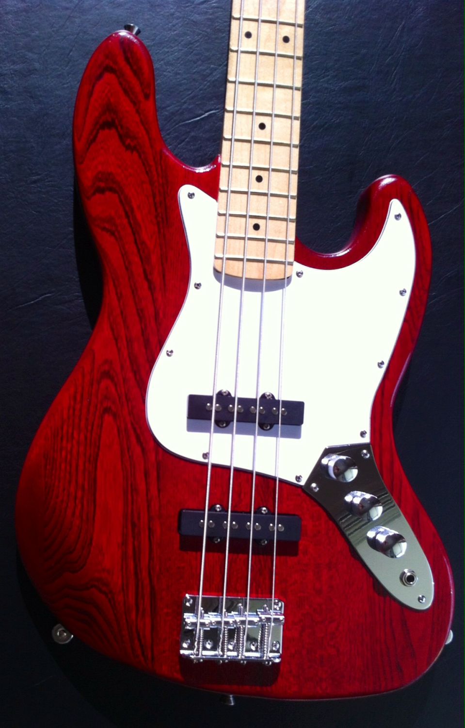

    The build thread for the red bass has the ratios used on the first coat and as the timber was extremely thirsty next day things looked a bit more crimson than what I hoped and for the 2nd stain coat dialled in just a little bit more of the darker fountain pen ink and thankfully nailed it.
