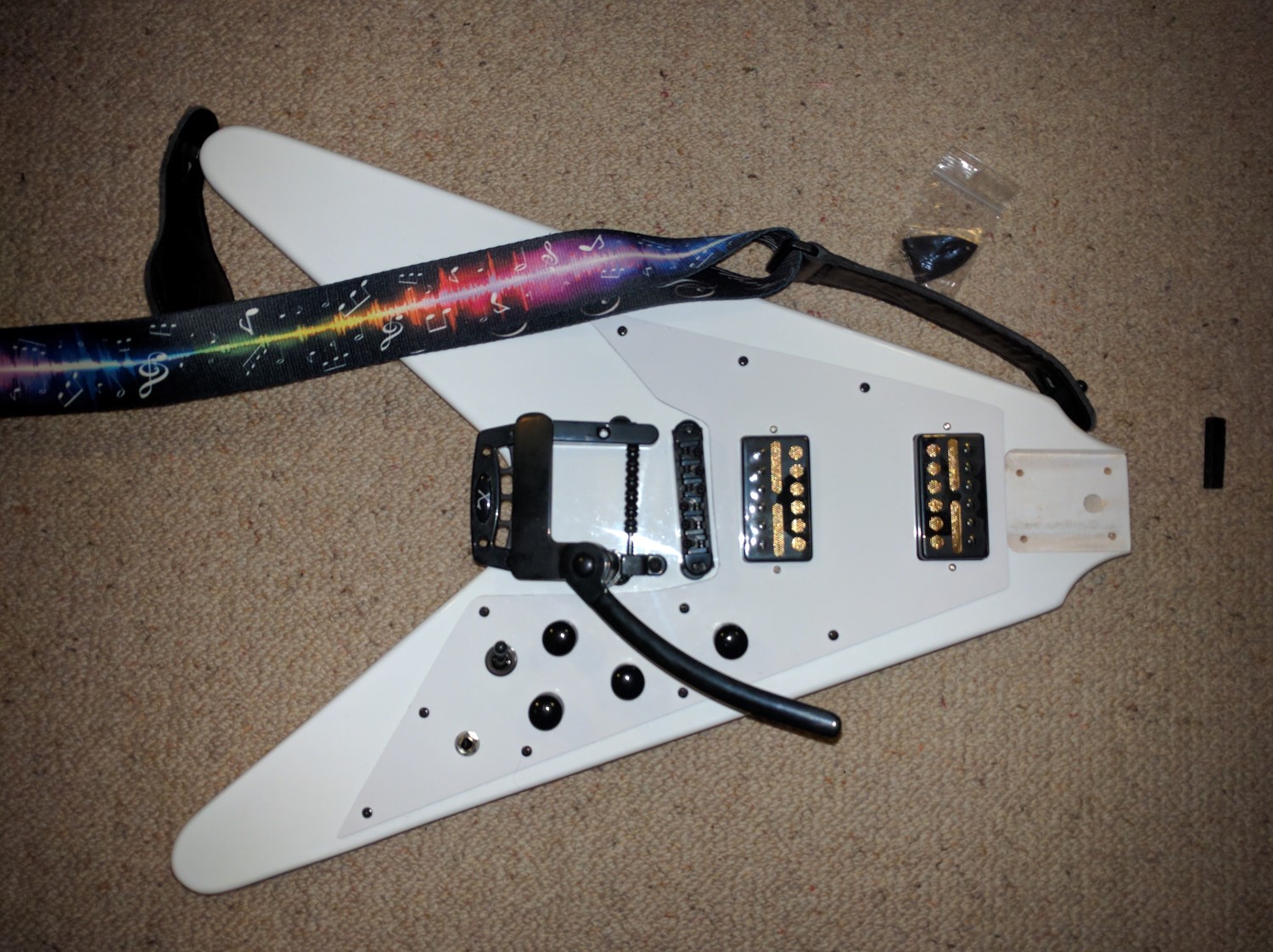

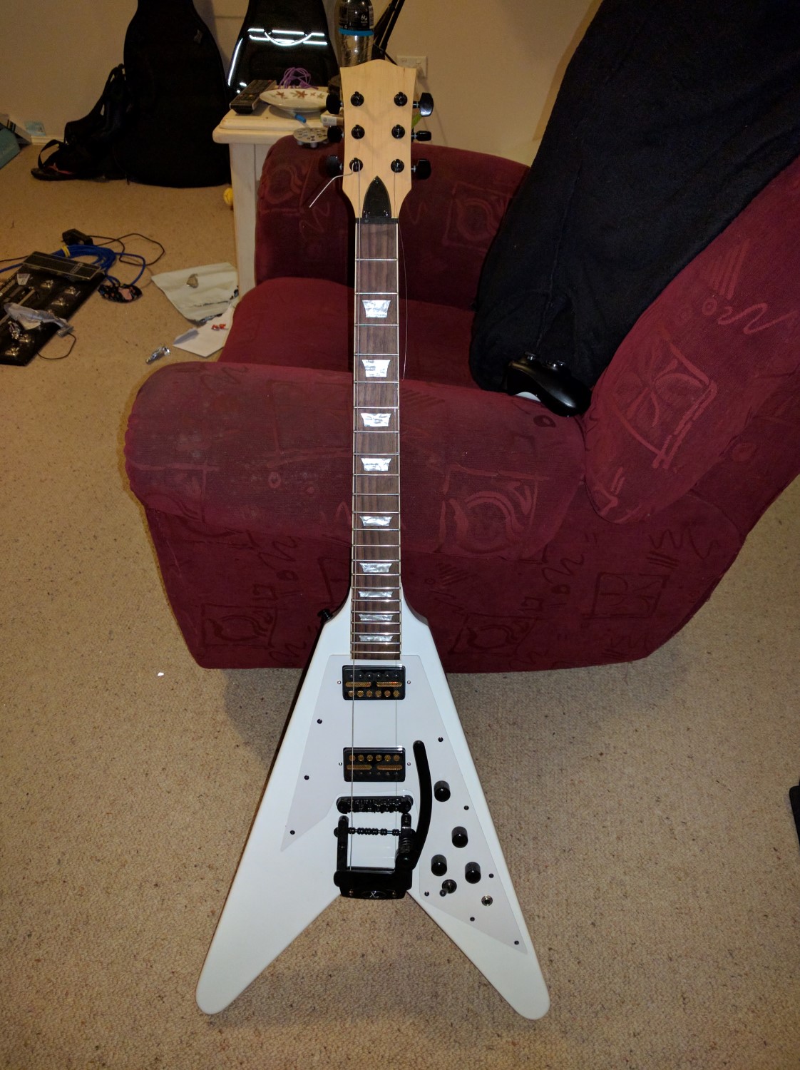

    Painted up the stud holes and it looks much better. Very good call Dedman!!
Name:	IMG_20160903_191136 (Custom).jpg
    Also popped my straplocks on too, and chose my strap. Unfortunately I don't have a B/W Checkered strap, and I think that'll have to be on the list of things to get.

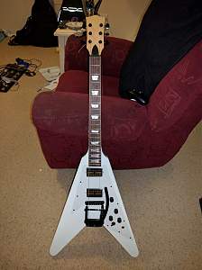

    And it's together!!
Name:	IMG_20160905_175807 (Custom).jpg

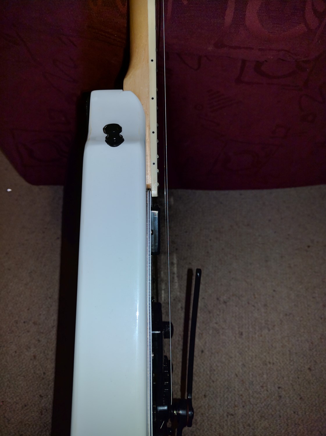

    Not completed yet. Pots still haven't arrived, and I will need to shim the neck because the action is super high even with the bridge set all the way down
Name:	IMG_20160905_175839 (Custom).jpg

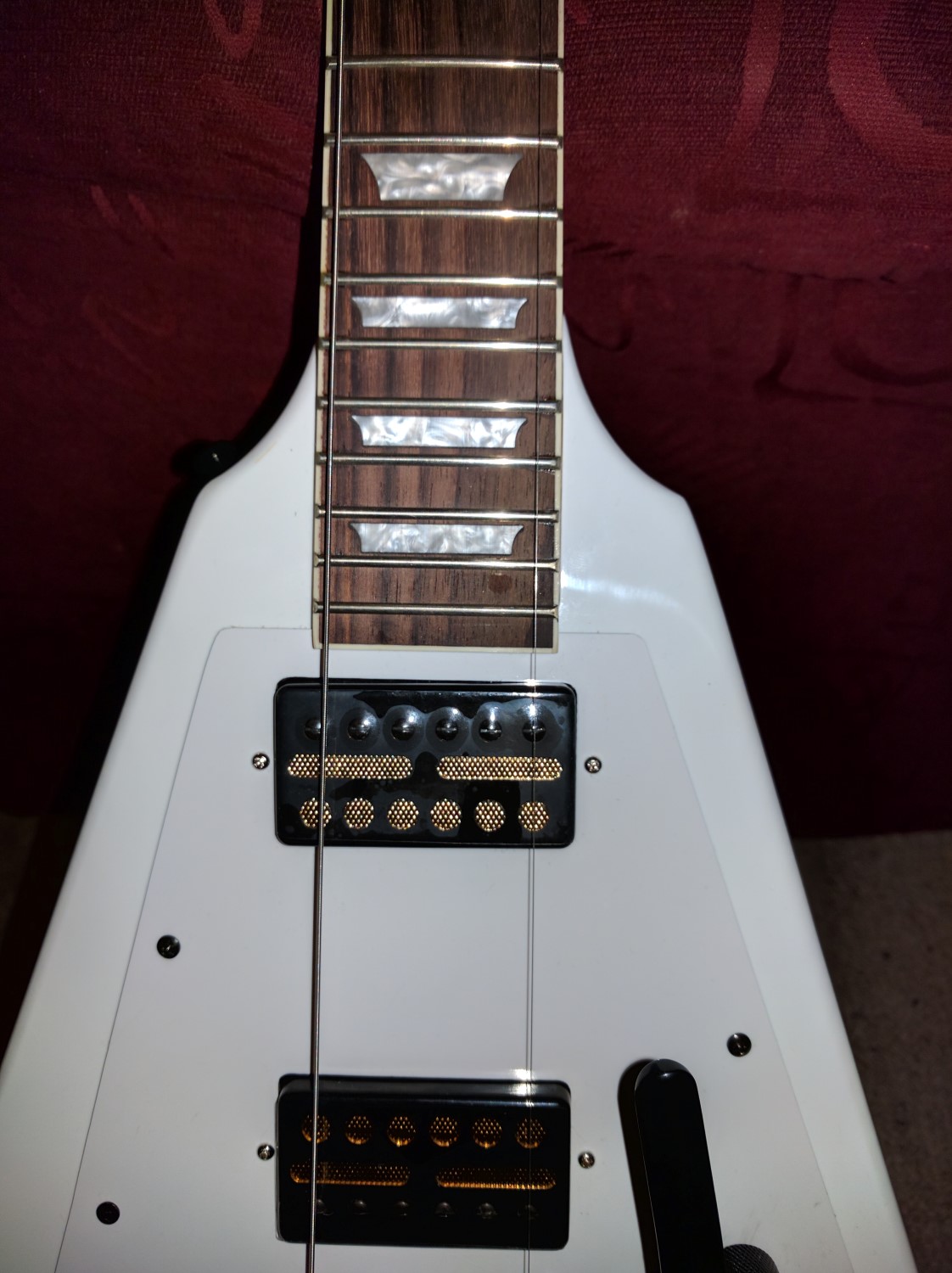

    I also noticed that the pickup is cut such that the neck pickup ends up off-centre, but that will be something to fix when I cut the replacement pickguard down the track

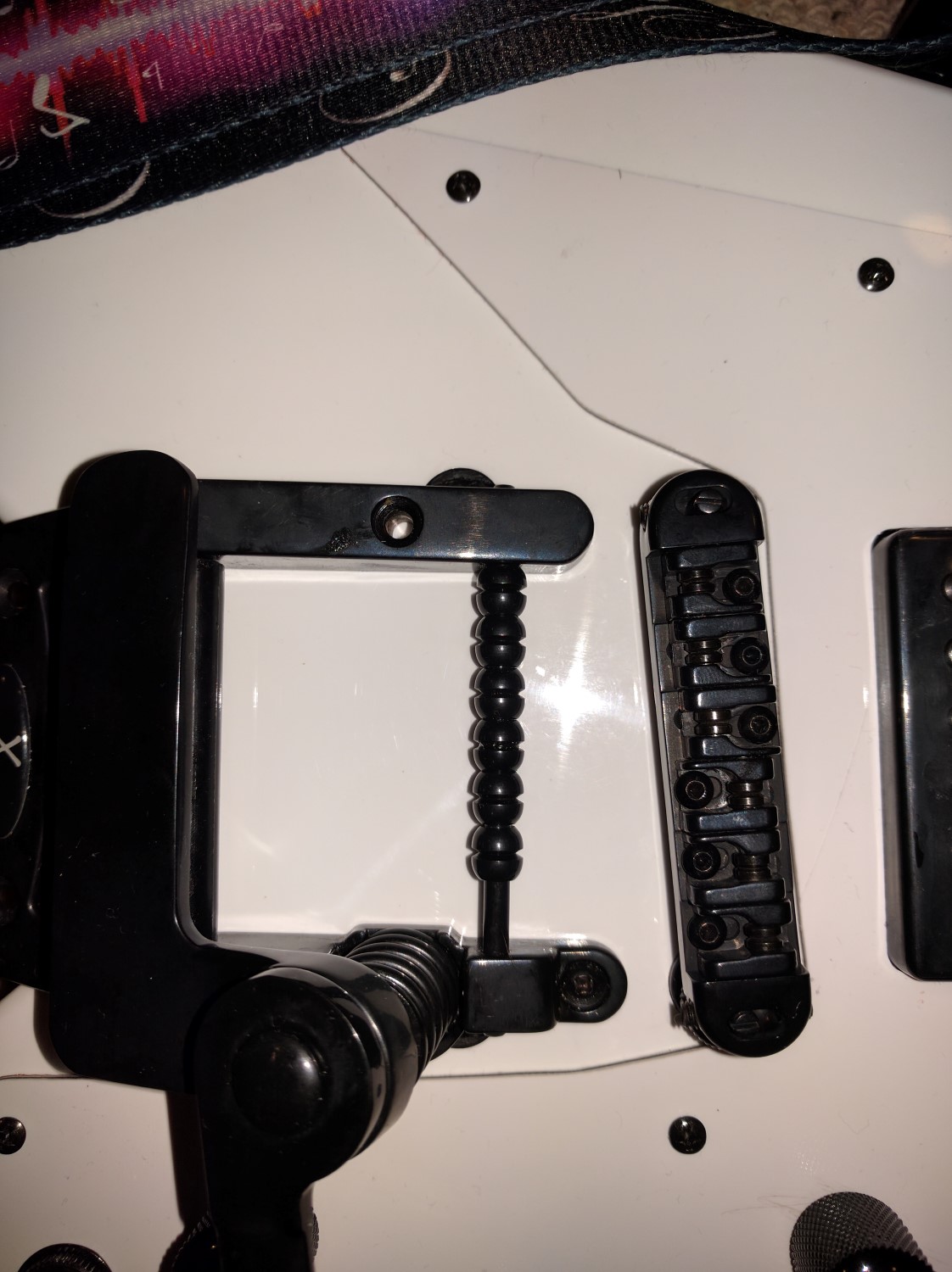

    Oh and for all the guys wondering about the trem, I gave it a quick go, it felt pretty smooth and nice, and in terms of tuning it seemed to handle a little bit of a whapping fine. But I only had one string on it and didn't have a tuner or anything to see if/how far out it fell. But early tests look pretty good!!

    How is the neck break angle? Is it just a case of a flat shim to bring things up or are you going to have to add some angle to it also?
  5. #35
    Not so sure you should be talking about whapping your one string online dude, people get some funny ideas on the intrawebs.
    Well hey I never considered that, you're the one takin' things that way haha
    I did need to angle it. I'm gonna get some proper StewMac angled shims down the track, buuuut money...

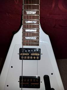

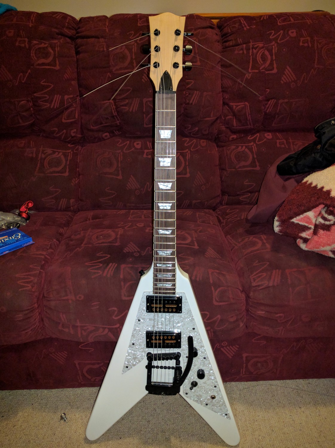

    Well now everything took longer than expected (shipping times + no money for some of the extra bits that I needed) but I've finally got this thing all together and totally functional!!
Name:	IMG_20161029_024039 (Custom).jpg

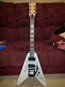

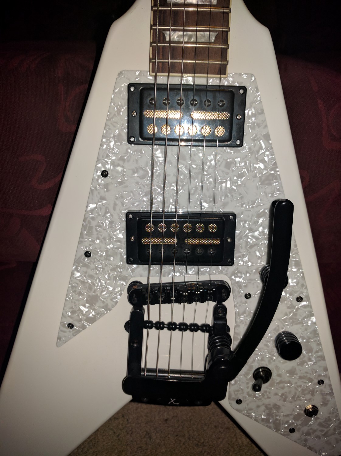

    As you can see, old white pickguard is gone and a pearl one has taken its place. Had to cut it from a sheet but that ended up being a surprisingly quick job.
Name:	IMG_20161029_024049 (Custom).jpg
    Also I popped pickup rings on top of the pickguard. The reason for that (as pointless as it usually would be) is that my neck pickup was not getting held up anywhere near high enough. The pickup springs were all compressed all the way down before, so I just couldn't raise the pickup any higher. The rings are not bolted down in any way right now, I'm giving them a test run as they are, if they end up wobbly I'll probably just pop a bit of super glue in between to keep them down, but early in it looks like it should be ok.

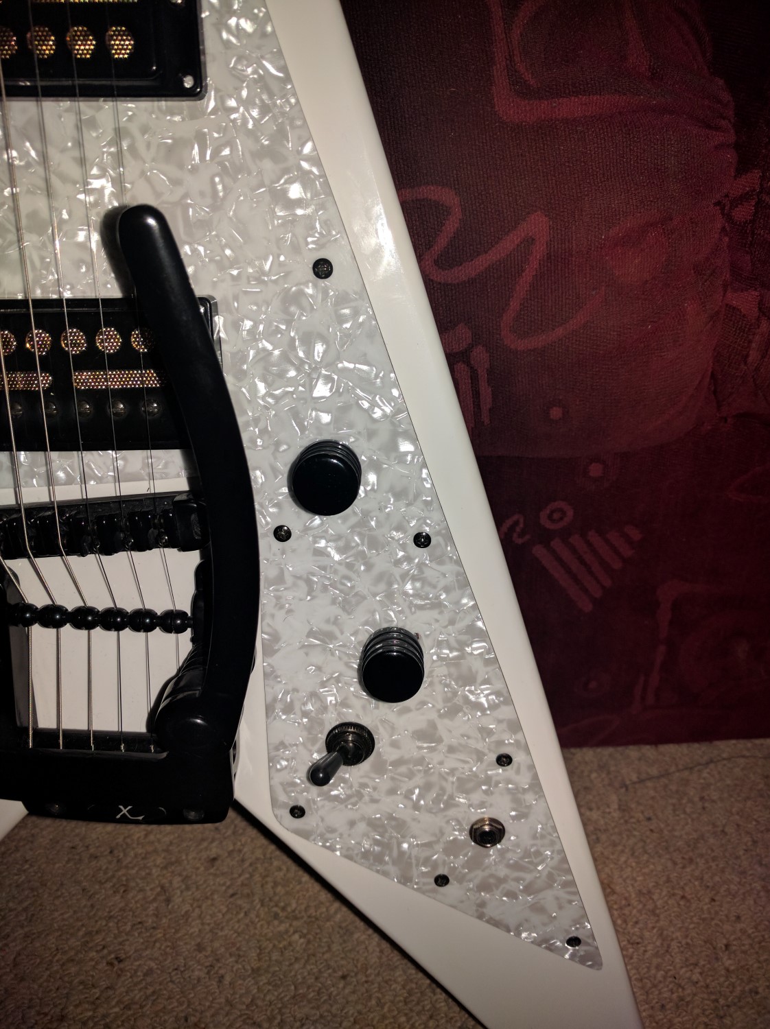

    Finally, I dropped all the silly switching and just went super simple. 1V, 1T and 3-way. Also because I was making my own pickguard it's much less cluttered now, which I really appreciate.
    Haven't had toooo much of a chance to test the pickups out much because the AC adapter for my POD has died, and my amp also seems to be broken. But I checked it out briefly in Rocksmith and they seemed to handle distortion fairly nicely, didn't get much clean testing in though (but having heard samples online, I have no worries at all about the cleans). I was amused that Rocksmith, when doing calibrations, said something like "Please make sure your volume is all the way up" even though I was already turned all the way up because the pickups are pretty low output.
