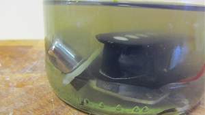

    Potting Pick ups,ITS WAX!!! not P*ss. All this is $2 shop Tea Light candles melted down in an old jar, placed on a hot sandwich press, or you can use a Electric frypan.WAX IS FLAMMABLE, dont use an OPEN FLAME, Place the pick ups in for 15 minutes or until the bubbles stop coming out of the pick up.. WAX must be BELOW 60 C, ie you can put your finger in it for a few secs.
    The REASON.... Potting the pickup forces the AIR out of the pick up and also stabilizes the wires inside the pick which can vibrate and produce En Harmonic feedback, not good Jimi Hendrix Feedback but bad feedback.This is common in Chinese pick ups and will make them sound heaps better.

    good mini tutorial HB
