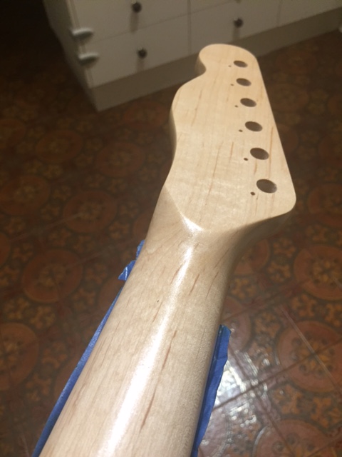

    If you don;t want to change the colour of the maple neck, you don't actually need to stain the neck at all, you can just use DT neck finish straight on maple. It doesn't change the colour at all. looks like this (thats not the final pick - just during the process. Click image for larger version.

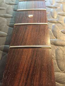

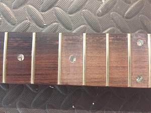

    exactly what wokks said. In the jar the wax really really hard. you just dig it out the wax with a knife and roll it in your fingers for a while till it becomes soft. Then put a bit on a rag and work it into the fret board, leave it for a bit, then buff to polish. Piccy of Dingowax vs no dingo wax
    mmmmm schinie
