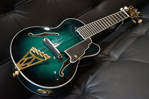

    no, using paint for the burst, sides and neck.I was going to do TO over the top, but I have a heap of black acrylic and a heap of clear acrylic and not much money atm, so, will use what I have.

    With the burst, can I make a suggestion - take the green all the way to the edge of the body. That way, if you start spraying the burst and decide a narrower burst is what you want, there wont be any gaps where you need to fill in the green, like around the f-holes.
    Here's a trick I used, get an offcut of timber and mark on it how far you want the burst to go into the body, for example 3cm, and as use it as a depth gauge to keep the burst even all the way around. Could wrap tape around a pencil or old ruler, whatever works.
    Might be easier to manage with the body laying flat rather than hanging. Some make templates for the burst but I'd prefer to be able to see how it's working out as I go. Just my 2c worth. (hope that made sense)

    thanks Grant, I'm using the body contour (the arch ) as my outline for the burst so the green goes a bit past where it flattens toward the edges.I'll spray it free hand as a lot bursts I've seen using a template don't have much fade, I've got 3 different size air brushes so there will be much testing before taking to the body. Yea, I like to live on the (faded) edge :P

    trying to copy this burst

    What is that thing? Only 4 strings but looks like a very short and small body? Bass Uke perhaps?
  8. #37
    no idea, I found it on a google image search for "hollow body guitar"
  9. #38
    I think it is probably a normal sized uke. The strings are too thin for it to be a bass uke.
