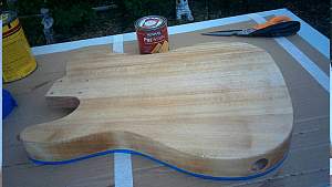

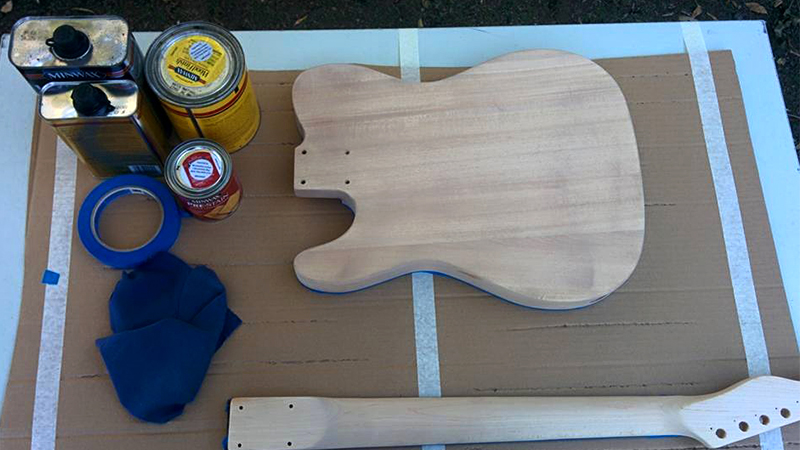

    1. Set up the work space to start doing the back of the body. I masked off the binding to avoid having too much oil stain to clean off it later.

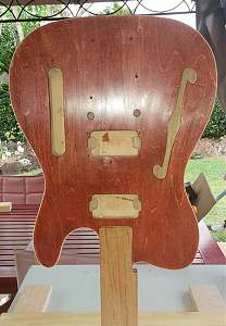

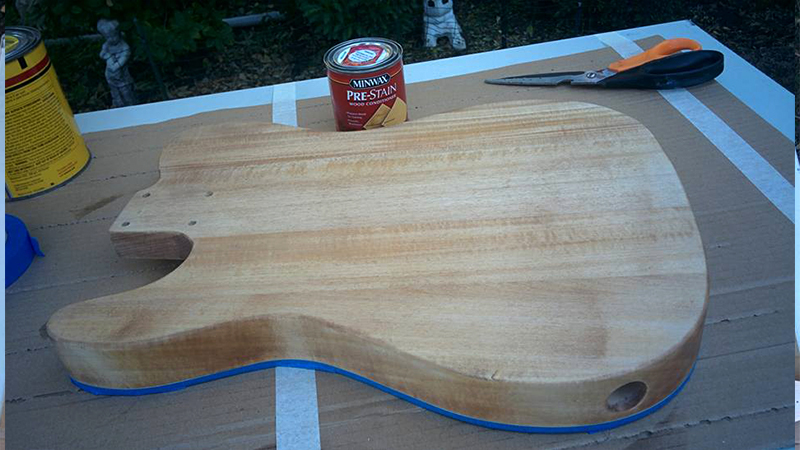

    2. Applied the prestain. This prevents the stain itself from looking streaky or blotchy (Evident that it works in the post stain pictures)

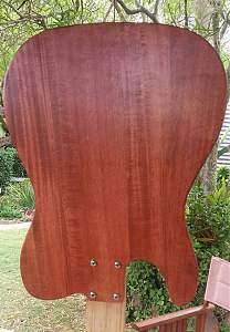

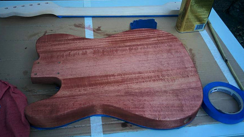

    3. First coat of the Minwax Sedona Red on the back.

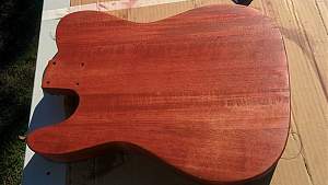

    4. Second coat:

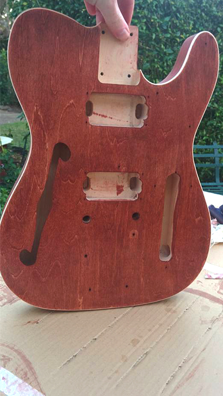

  4. #34
    Thats looking great!.
    I had to notice the "next time" .......no one stops at one
  5. #35

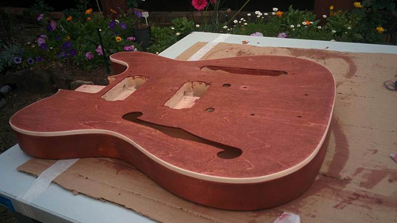

    5. Flipped it over and removed the painters tape:

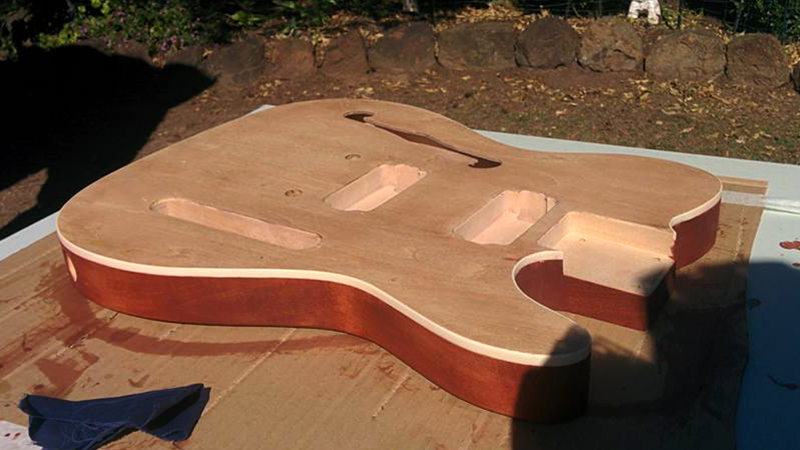

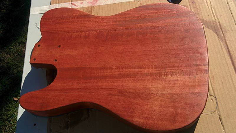

    6. This was the end result, To wood on top actually took 3 coats in total (Didnt take pictures inbetween because?)
    7. Front on view
    Excited to do the gloss coats now.

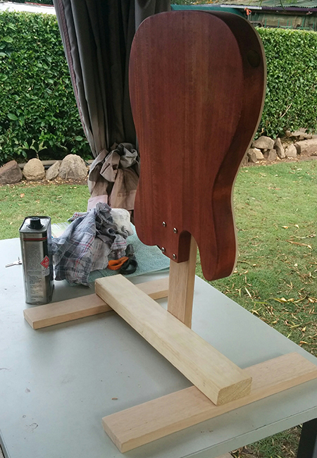

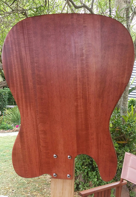

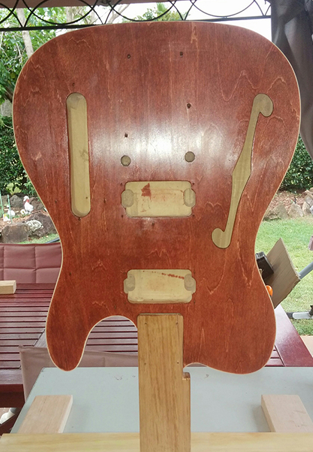

    colour looks great Storm well done. Easy fix for staining/clearing the whole body at once drill a scrap piece of wood (about 300-400mm long, up to 50mm wide) into two of the neck screw holes of the body and drill a hole in the other end and it can be hung up to cure. If you have a vice you can clamp the hanger in the vice and stain/clear each side of the body
  8. #38

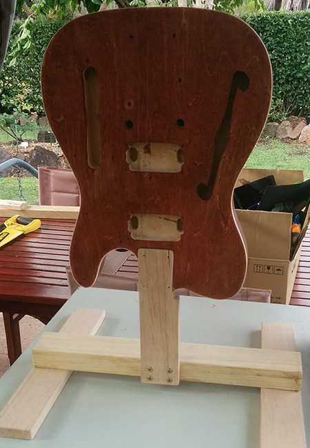

    Built a stand to hold the body so I could finish staining both sides at once. Was just a simple cut a basic sized neck piece, and attach it to a base.
    I used Minwax Satin hand wipe poly x 8 coats on the body. These pictures are from when I started doing the work, I didnt take later shots (Sorry ><)
