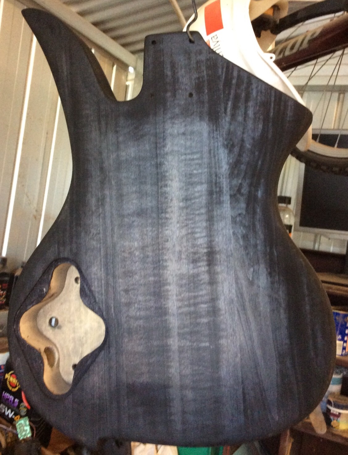

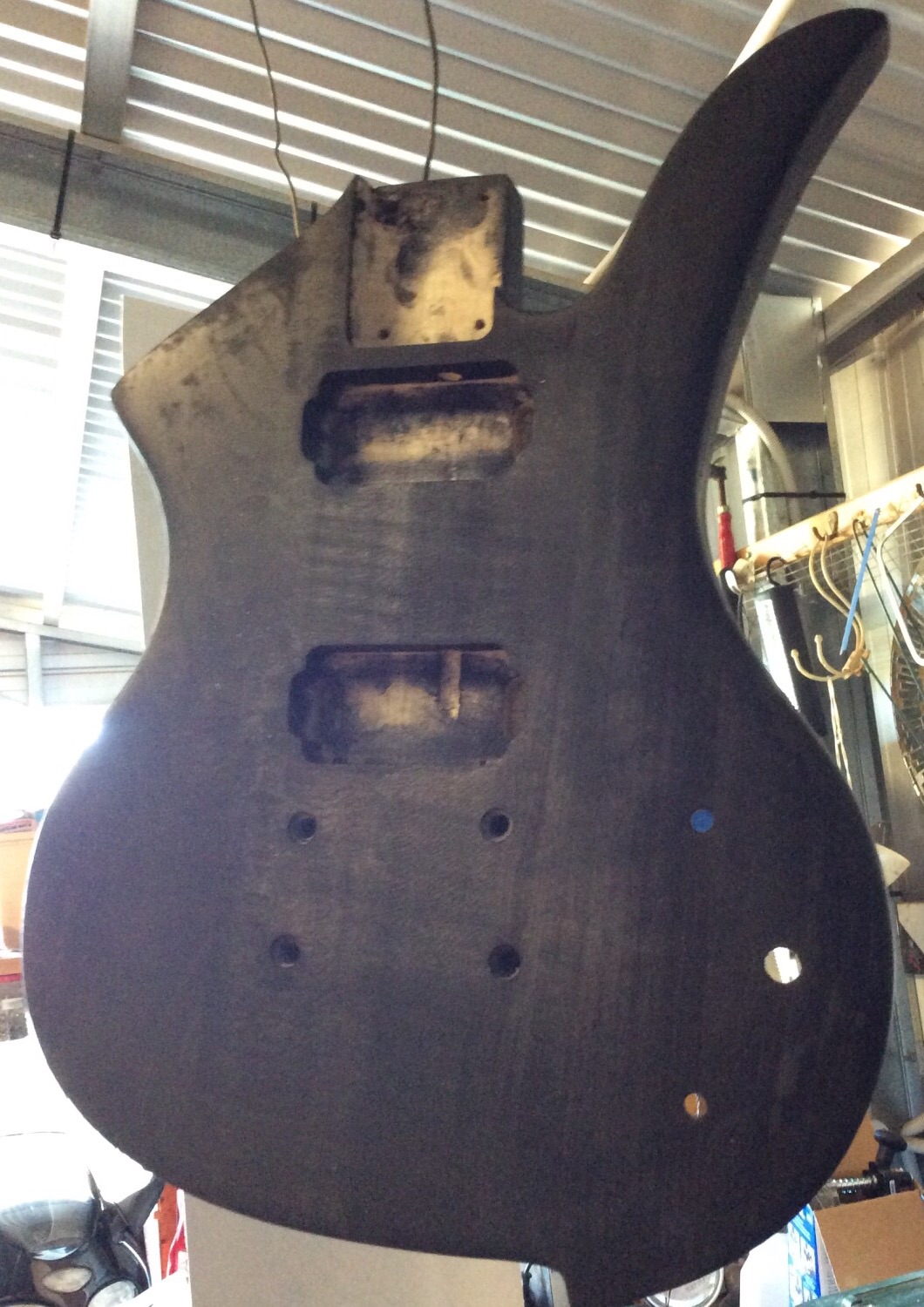

    Quote Originally Posted by AndrewA View Post
    Hi Andy, thats just the first coat. In the last photo, the patch that looks like a flash reflection is bare wood showing through where the stain didn't take. Hopefully a few more coats will fix it.
    That is pretty normal with 1st coats as invariably there will be parts that take stain less than others. Subsequent coats with a bit of concentrated effort around the 'bare' patches should do the trick. If the bare patches look a bit shinier than others that could be one of the reasons stain is not taking hold too well and therefore require a bit of scuff sanding.

    Looking very nice, I'm itching to get into my build now!
    In regards to the sections not taking stain, are they glue spots perhaps? If so, you can use some very fine wire brushes to scuff up the timber a fraction so the stain has a path to soak into the grain. Using 0000 steel wool will compress the grain and polish it, essentially making it harder for the stain to soak in.

    Thanks Andy, Waz and Zandit for the info. There is one spot that looks shiny that didn't take any stain at all that I might try scuffing with 320 paper, just to give the stain something to hold onto.

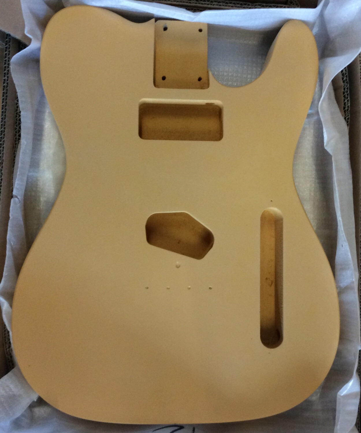

    There are some long drying times coming up as the finishing coats go on... I need a new guitar project, so I've bought a non PBG Telecaster kit to fill in some time.

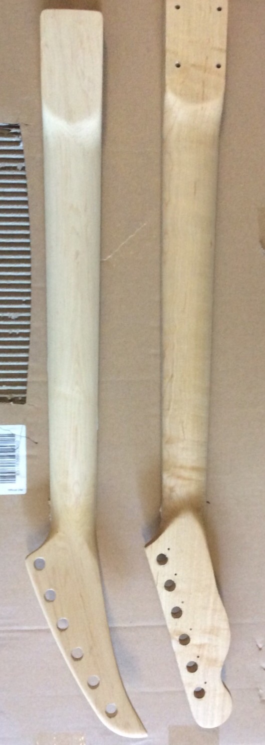

    That's a great idea Andy. I put the stain coat on the 2 necks today, the dingotone will take extra time to dry, but it will dry eventually. 90% humidity this morning, 71% now, rain forecast for tomorrow, Monday, Tuesday, Thursday, Friday.

    Update photos

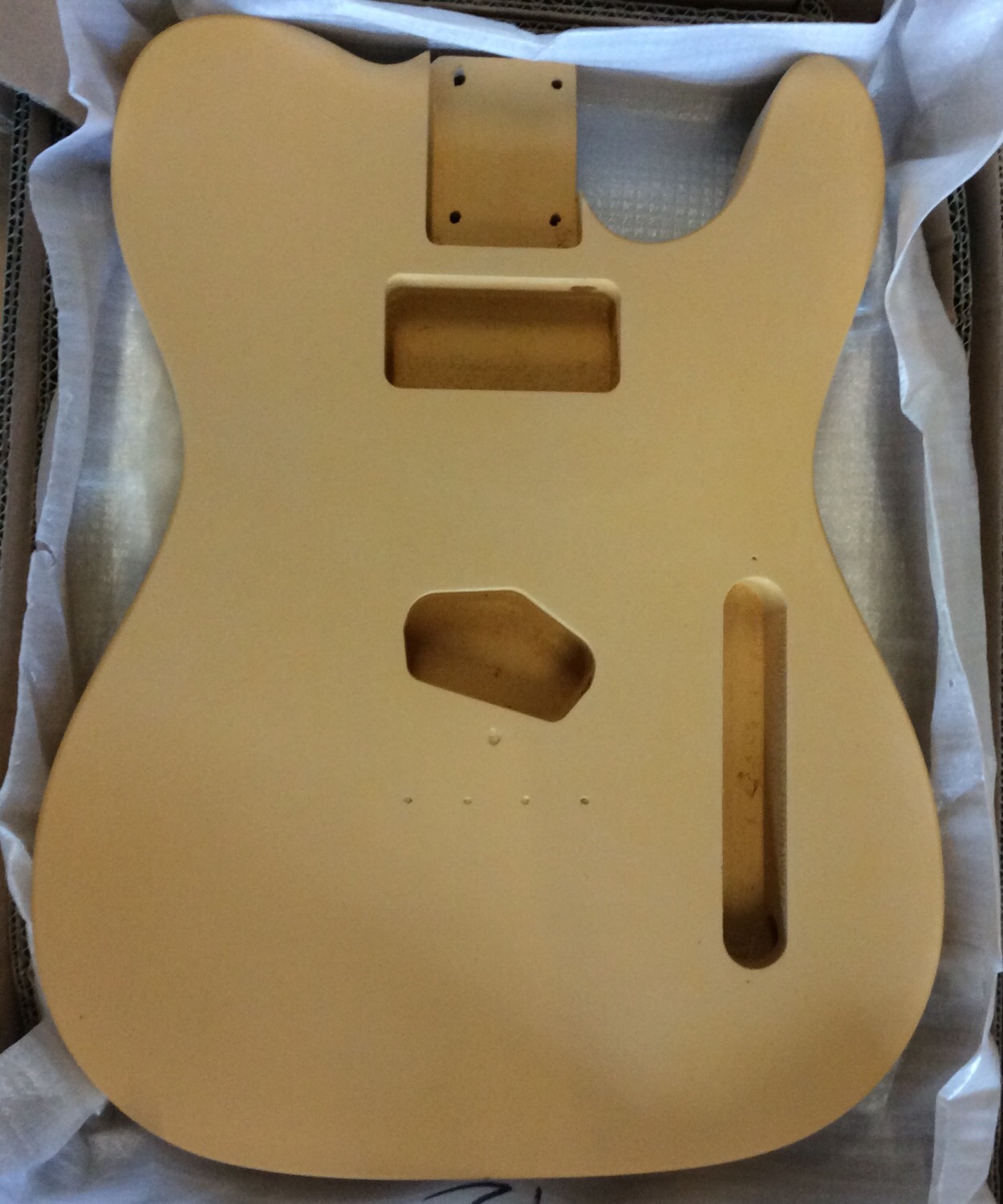

    both builds are looking great Andrew. The PBG1 is getting nice and dark. What sort of paint are you using on the gold tele ? looks just like mine. I am on the home stretch with mine
