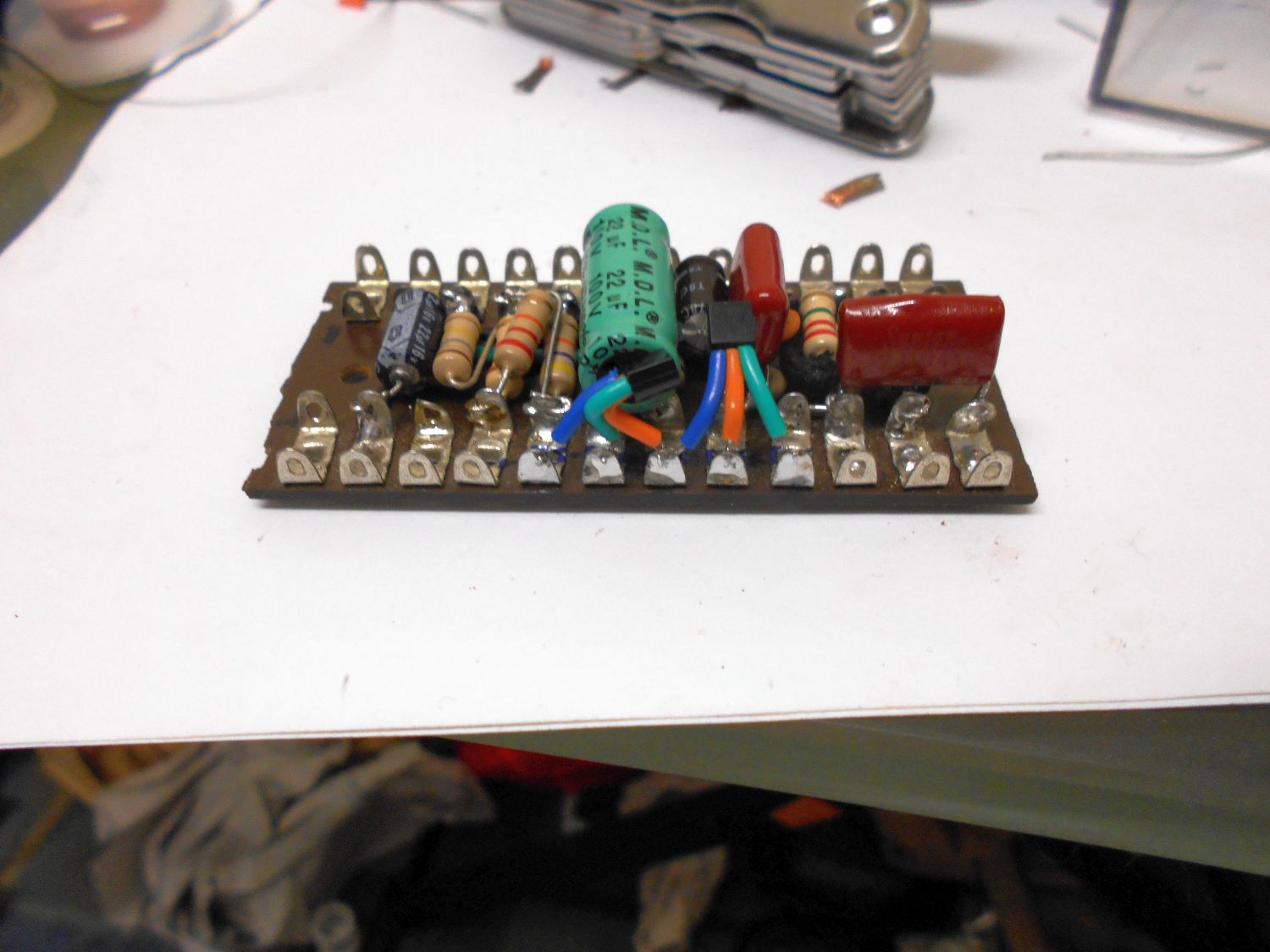

    Here's a pic of the two transistors soldered in place on the Tagboard, you will notice that I have put some coloured plastic insulation on each of the transistors legs, this prevents any short-circuits and also indicates which leg is which, the Tagboard is now complete and ready for installation in the Aluminium box housing:

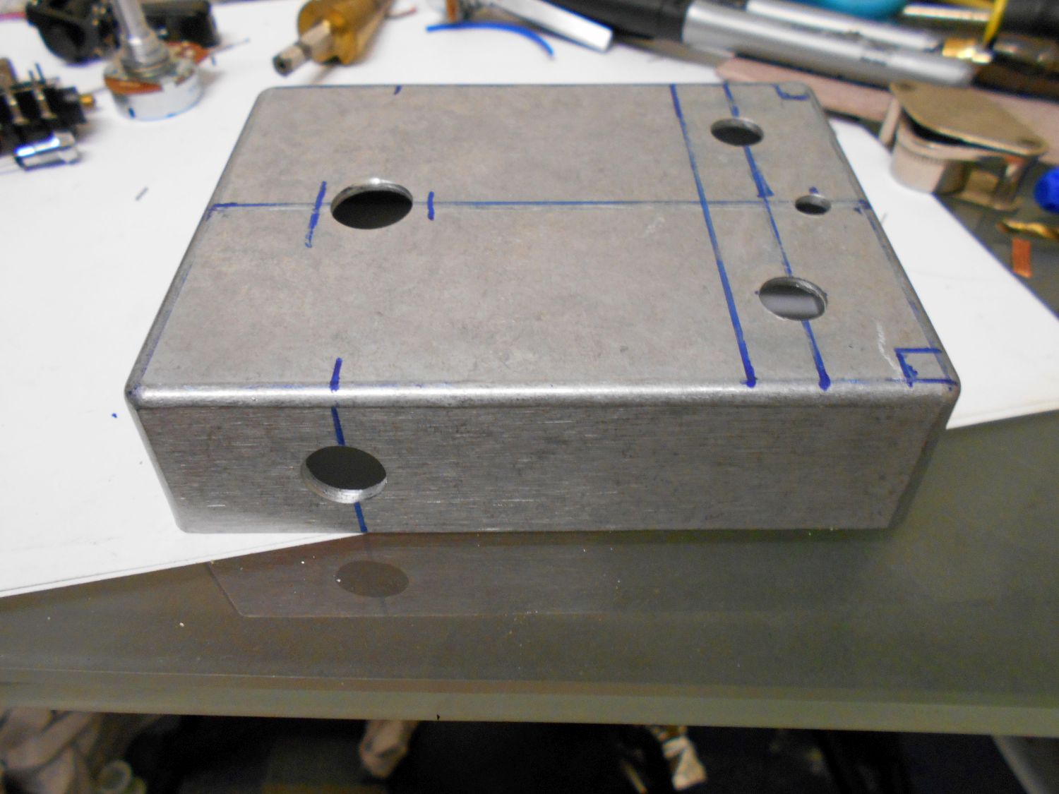

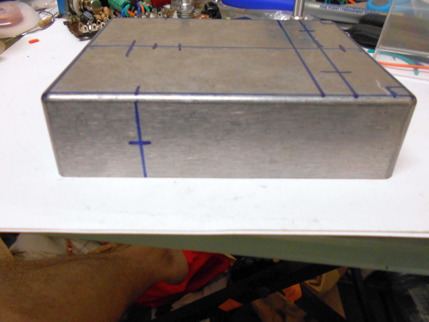

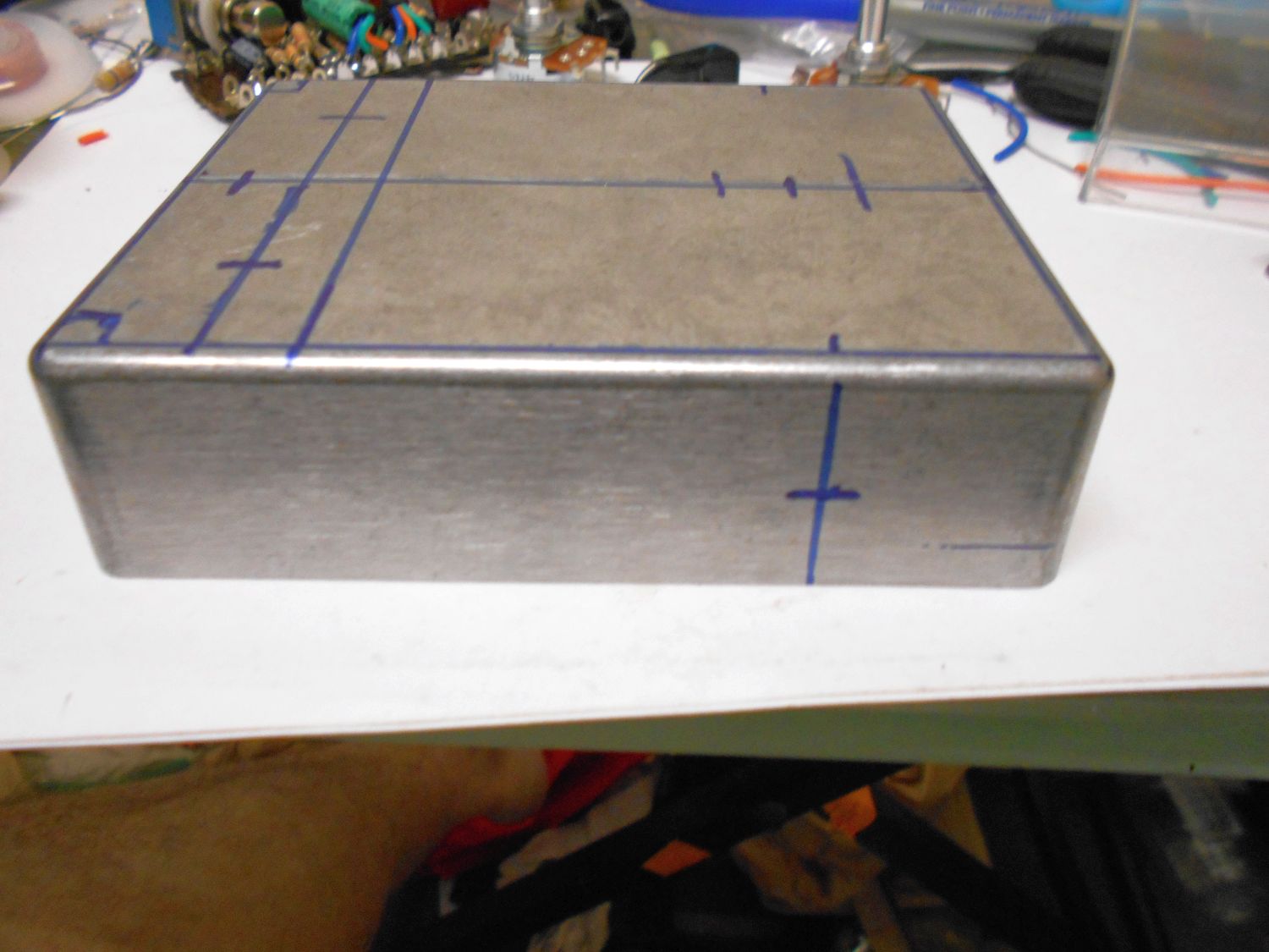

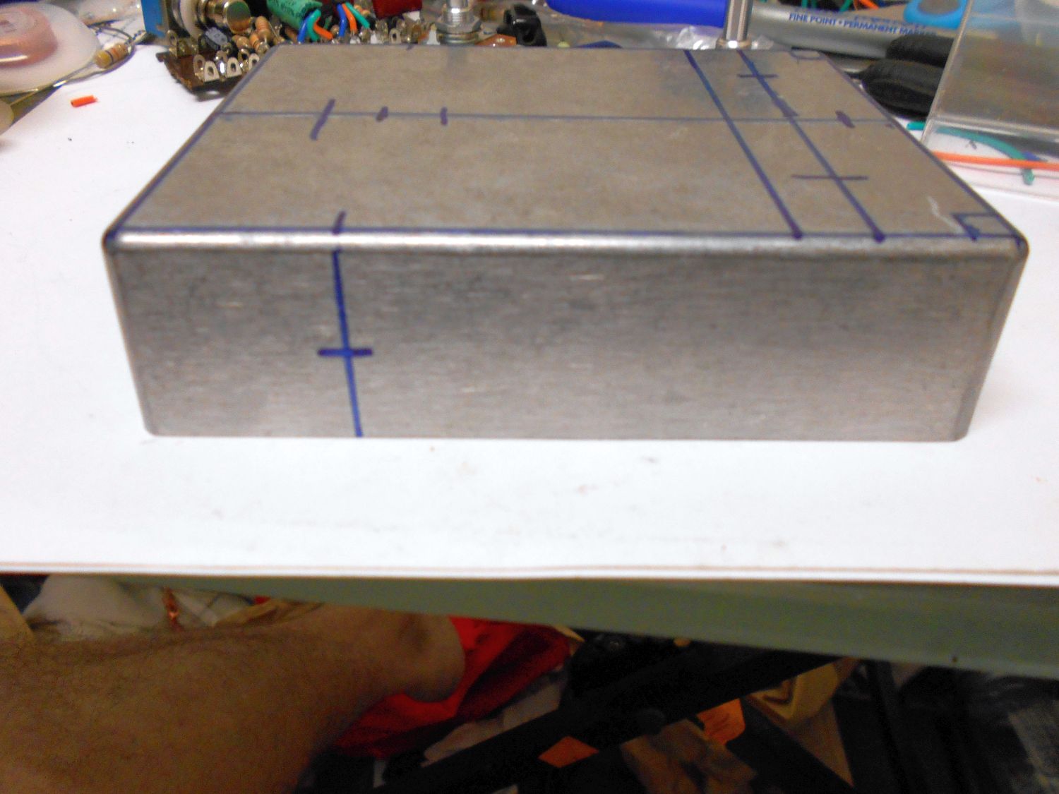

    So the next step in the Axis fuzz build process is to mark out all the centres for the mounting holes for the pots, footswitch, Led, and the in/out jacks on the Aluminium box:
    Top Centres marked:
Name:	Top Centres_resized.jpg
    These are where the mounting holes for the pots,footswitch, and Led indicator.
    Left Centre marked:
Name:	Left Centre_resized.jpg
    Right Centre marked:
Name:	Right Centre_resized.jpg
    These are for the mounting holes for the in/out jacks.
    All that's needed to be done is to Centre-punch and drill all the holes to the correct size and then the Aluminium box will be ready to be wired-up prior to installing the Tagboard.

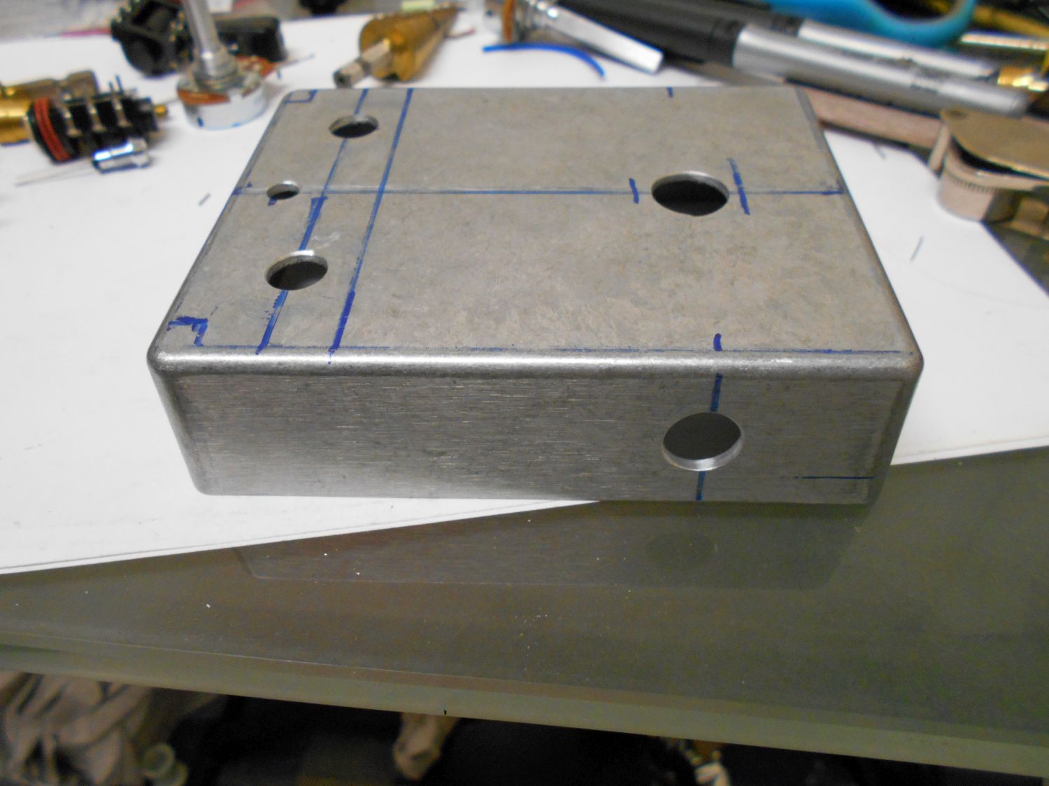

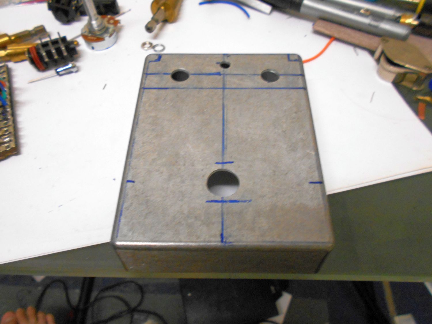

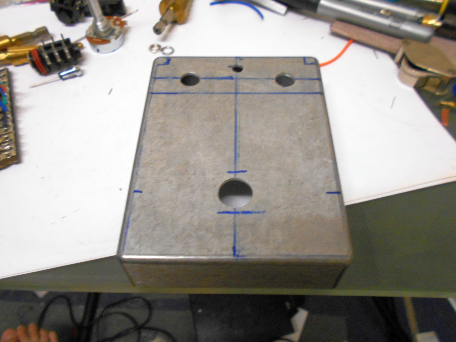

    Okay, so I've done all the Centre-punching and have drilled all the mounting holes out to the correct size, all that's left to do is to cut the pot-shafts to size, do all the wiring for the pots, footswitch, and in/out jacks and then install and wire up the Tagboard, after a quick check out with my multimeter it will be ready for trying out with one of my guitars and my Peavey Backstage Plus amp, I'll see if I can do a demo of the pedal a bit later on once I know it's working correctly, for now, here are some more pics of the build process:
    Top Holes drilled to size:
Name:	Holes Top_resized.jpg
    Right hole drilled to size:
Name:	Hole Right_resized.jpg
    Left Hole drilled to size:
Name:	Hole Left_resized.jpg
    And a quick test-fit to check if everything is going to fit, fortunately it all looks good:
Name:	Test Fit_resized.jpg

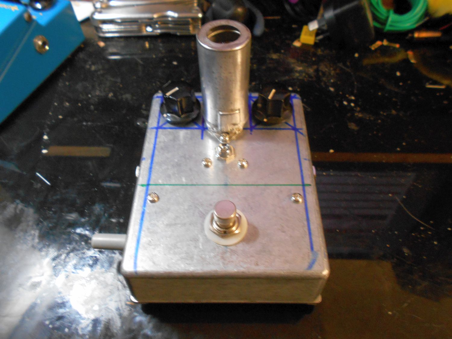

    The blue dots on the pot shields are just to indicate the most anti-clockwise position of the pot-shaft so I can correctly wire the pots up so that they work like they're supposed to, there's nothing worse than having to de-solder the wiring to a pot because it's wired back-to-front, i'm sure some of you have done that at least once, I've been there and done it too.
