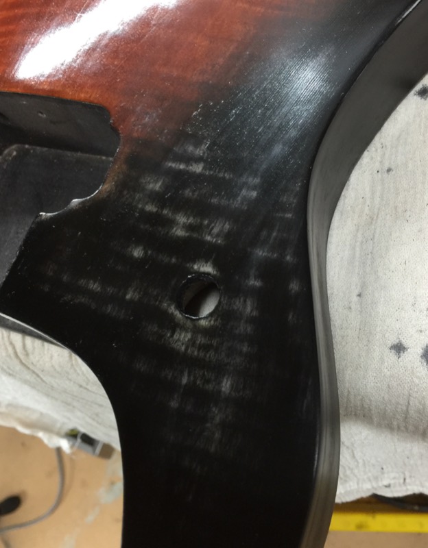

    By the way, this is the finish I'm going to attempt - but with gold hardware.
    It's a Maton BB1200JH. I own this guitar, not the one pictured, but it's identical.
    I can't justify owning a $4k guitar at my age/ability. Hence the attempt to copy the essence of it. I'll be selling the JH in the near future if anyone's interested.
    Attachment 8296
    My first 2 builds (both PRSs) are practice runs for my third build - which will be an ES-2V. Inspired by the above Maton. All my builds will have the same finish for the following reason...
    Attachment 8303
    DO NOT SELL THAT BEAUTIFUL GUITAR!!!!!!!!!!!!!!
    From personal experience, you will regret it.

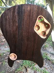

    This is after 4 coats on the body and 5 on the neck.
    Is it going to go black, do to think? I thought maybe I hadn't shaken it up enough, but I really gave it some.
    How will I know when I can put a few more coats on? Instruction sheet says 5 days, Dingo's video says 3-4 days.
  11. #40
    ok Muzza I see it's not really that black. Have you used the stain coat and given it at least 3 days curing between coats ?
    better wait for DB to see if he can suggest anything.
    I will get in trouble for suggesting this but Feast Watson Proof Tint Black will give you darker results
    the shade of black you got is similar to wudtone black magic woman, it's not really a black black
