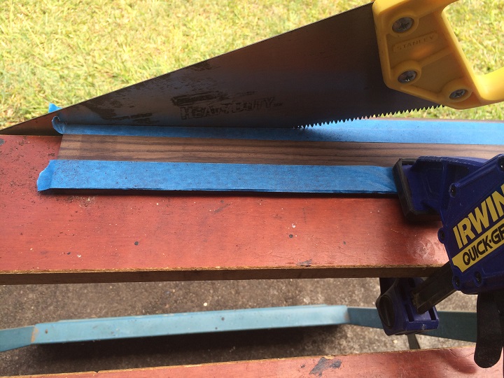

    Managed to get a bit more done on the fingerboard.
    Got the old hand saw out and roughly cut the fingerboard (fb) to size. It was really hard to see the pencil line on the Rosewood so I had to use painters tape to contrast the line. I also noticed how fragrant Rosewood is. I guess that’s why it’s called Rosewood.

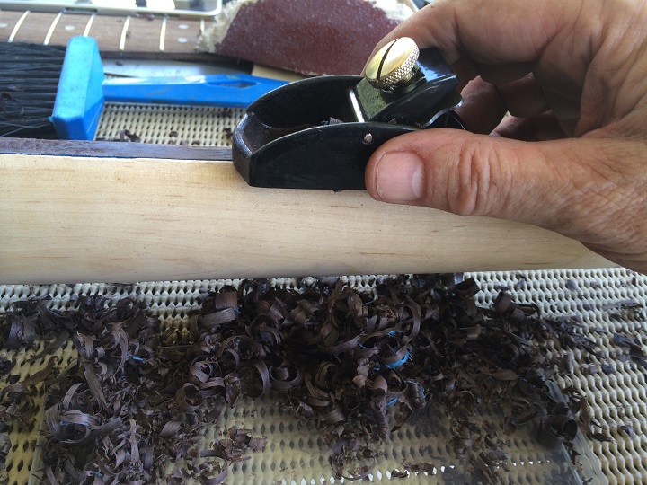

    After rough cutting I clamped the fb to the neck and started the final shaping. It gave me a chance to finally use my mini plane that I bought for $10 a few months ago. I didn’t think that I would ever have a use for it, but it was perfect for the job. Unfortunately in my wild enthusiasm I got a bit carried away, the clamp slipped a bit and I cut a fraction too much off the fb, but it should be OK.

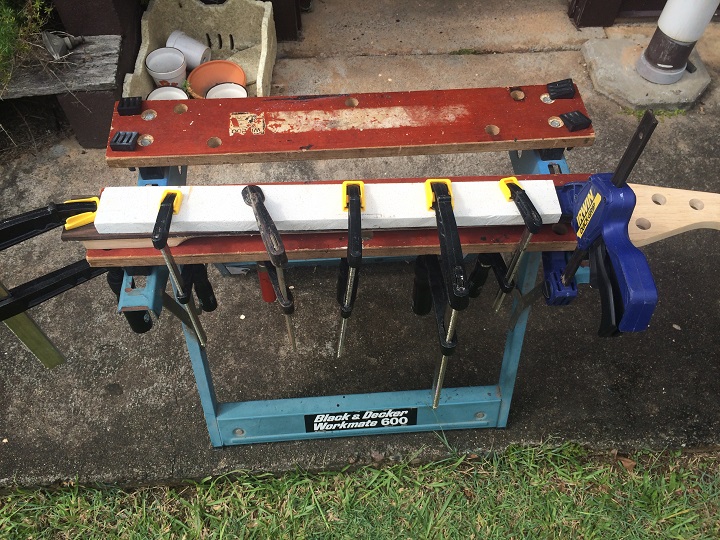

    I then put 2 small locating pins (one at the nut end and the other at the heel end) in the neck and fb to stop the two from squirming around when I glued and clamped them together. Lesson #1 for noobs like me, put the locating pins in BERFORE the final shaping and I wouldn’t have made the mistake of shaving too much of the fb.

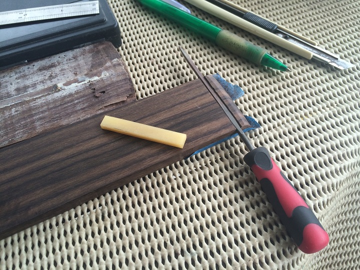

    I wasn’t too sure when to cut the nut slot, but figured I had better do it before I glued the fb in case I stuffed it up. I use a Tenon saw to make the initial cuts and then tidied up the “floor“ of the slot with a small square file.
    Glued and clamped the fb to the neck. Lesson #2 don’t use too much glue!
    I made a right mess, but I should be able to clean it up. I have now got to wait 24 hours before I do the final sanding and then on to putting a radius on it.
    Pic 1 – rough cutting the finger board to shape. Painters tape was used as it was hard to see the pencil line on the Rosewood.
    Pic 2 – I think it’s a bit big to be called a “thumb” plane but it worked an absolute treat. I love it!
    Pic 3 – The pins I used to locate the fb on the neck. They are only round toothpicks but they seem to work OK.

    Pic 1 – The nut slot. I am using a small square “hobby” file after initial cuts with a Tenon saw.
