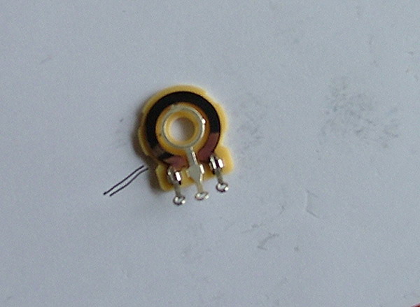

    It sounds like the conductive carbon has lifted, and is causing grit on the wipers to sound like sand being crunched under it.
    The carbon comes away very easy when i scrape some away to make no load pots, but it shouldnt come away like that on a new pot.
    Heres a 500k pot i have taken off some of the carbon to make a no load (where the 2 lines are), that ring is where your problem will lay.

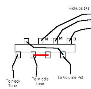

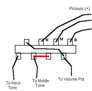

    When wiring a strat, as you are probably aware, the strat bridge pickup has no tone control on it. What i did for a mate recently was a piece of wire across from the middle tone on the switch to the vacant lug in the middle, right next to it, i then put a no load in the middle pups volume control, this gave him a no load on the middle and bridge, he keep the stock 250k in the neck, he liked the tone on the neck pup with some load on it.
