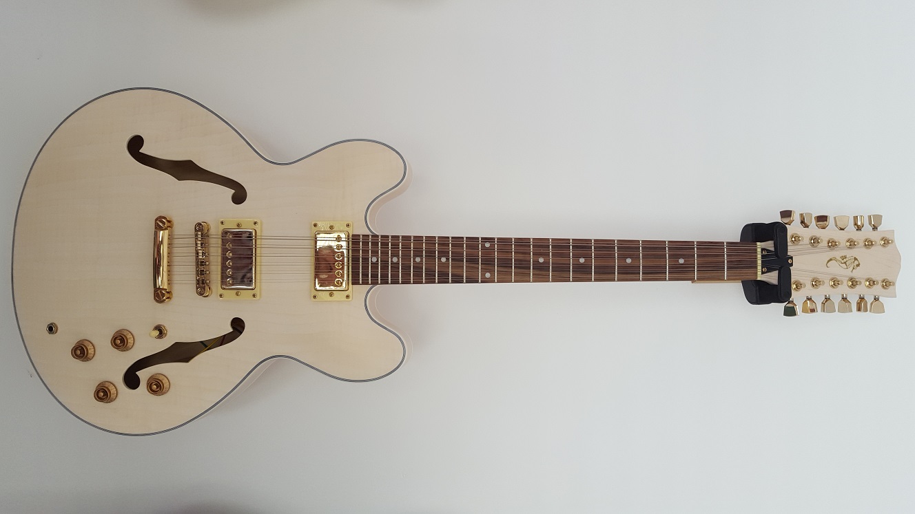

The ES-12G kit arrived in great condition, thanks Aust Post, and thanks to all at Pit Bull.
Three start up questions ...
1, To check neck pocket machining, with outer strings running from nut to bridge it looks like I'll have to fully insert the two serrated pegs that locate bridge. Is this correct and is it OK to fit and remove these bridge fixing pegs, or are they a one time only fit?
2, I've used a building strength glue called AV515 with amazing results. Any comments on this product (or recommendations) to glue the neck?
3, This guitar is for my wife and therefore her call on finish. She wants a simple "satin oil" finish the same as on her Seagull Merlin and my oiled ash Strat. Any recommendations on the product choice?
She wants this guitar to be a work tool, not a case queen so I'm thinking of following Paul C in his Rc-4 build thread and glue the neck before any other work. Any comments on this appreciated.
