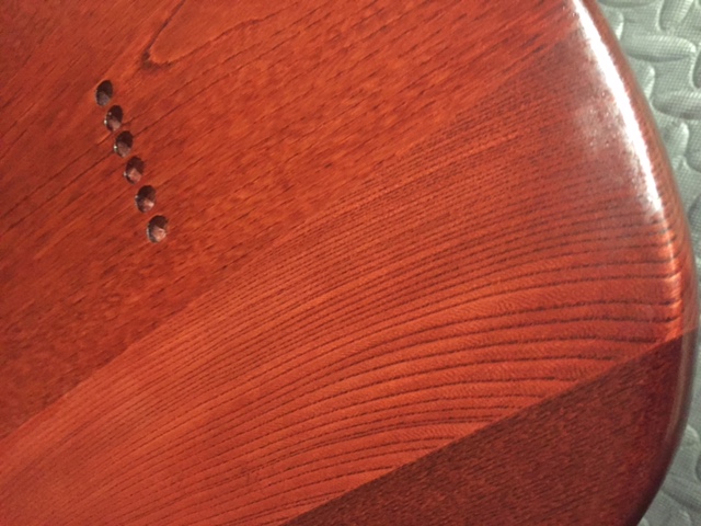

    You win some, you lose some...Scrap wood string through fail
ID:	8386Click image for larger version.
    The inaccuracy stems from having to clamp the drill guide to the wood drill one hole, then unclamp, re-clamp drill the next...each time reclamping alters the tilt of the base plate which i did not measure with a spirit level each time. The scrap wood is also smaller than the body would be so it will be less stable than actually clamping to the body. nevertheless test 2 will follow sometime this week.

    Mount the bridge to the scrap Andy, and it will stay in place, if thats what i am thinking is going on?
