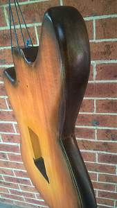

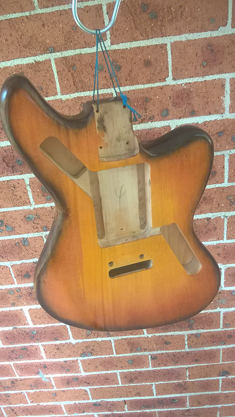

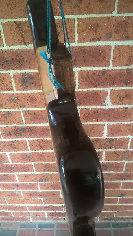

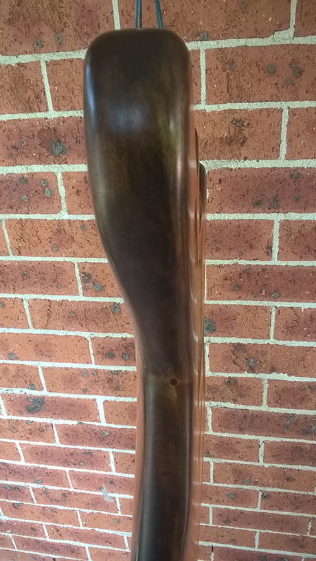

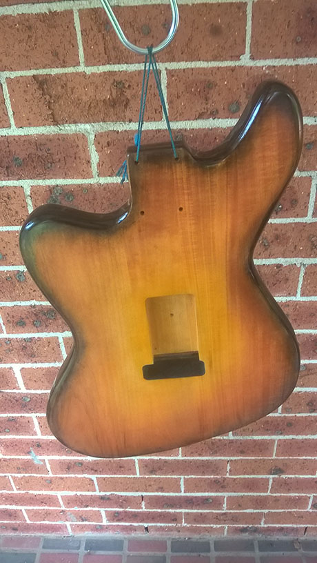

    It was swelteringly hot at the start of the week, so I took the opportunity to get another round of stains done. I really didn't like how the left edge of the body was looking, so I sanded it back to wood (just that one edge) to see if it would make any difference in regards to taking stain. It didn't.
    So I tried staining the bare edge with orange (Outback Sunset) but that didn't have much more luck than the black. It was so hot that the stain was drying fairly quick, so I spent probably an hour just going over that section with black slowly darkening the colour and also put another layer of stain across the rest of the body.
    I don't have any photos from during the week, but today I opened up another bottle of black stump and did another full stain coat and tried to darken those edges some more.
ID:	7667 Click image for larger version.
    This patch up by the neck joint just won't take any more stain.
ID:	7670 Click image for larger version.
    These shots are of the edge I sanded back. There's actually a hint of orange in the light patches that the camera doesn't pick up. The crappy phone actually makes it look better than in the flesh.

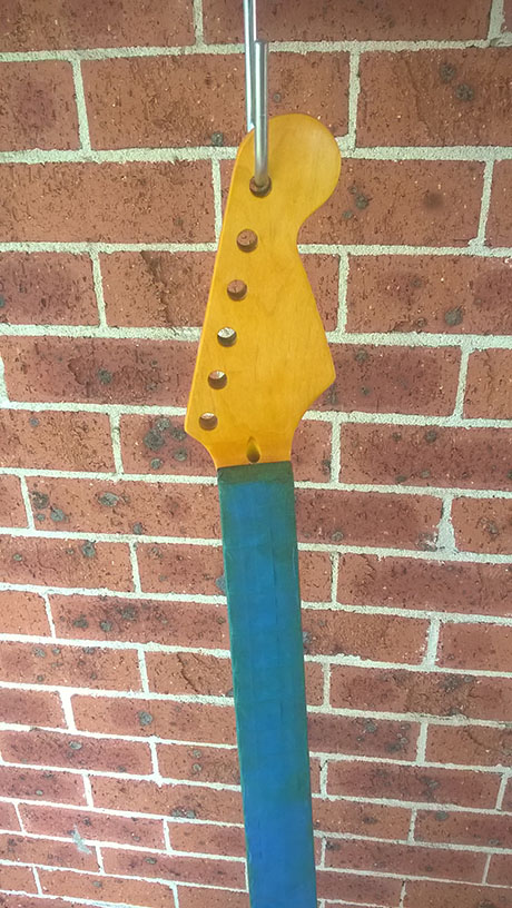

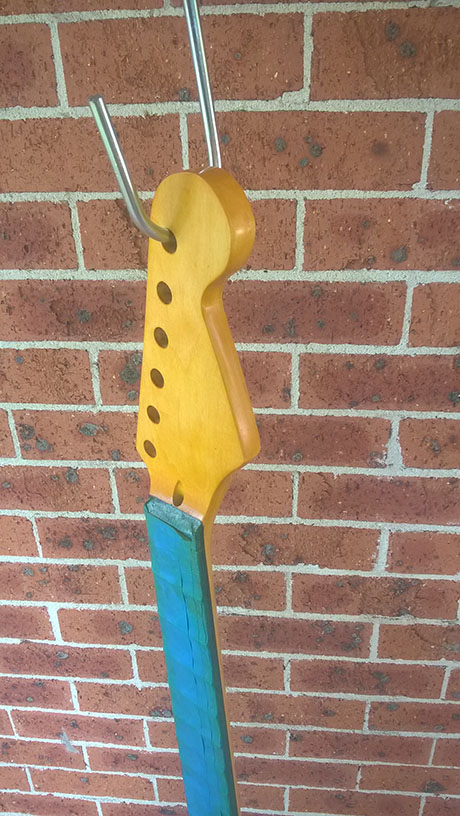

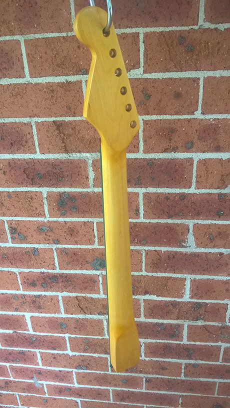

    Here's the neck with 2nd intensifier coat
ID:	7672 Click image for larger version.
ID:	7673 Click image for larger version.
    I'm reasonably happy with how it's looking, it's a nice golden vintagey looking yellow. The secret has been the otherwise unused bottle of Bondi Blue I had laying around.

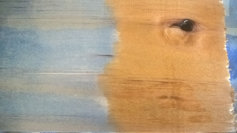

    After the Mission Beach stain mix, I used a similar mix of DT intensifiers: equal parts Outback Sunset and Bondi Blue to make a dark pooey brown and then Coolangatta Gold to lighten it to a... lighter pooey brown.
    This is the intensifier mix on pine:
