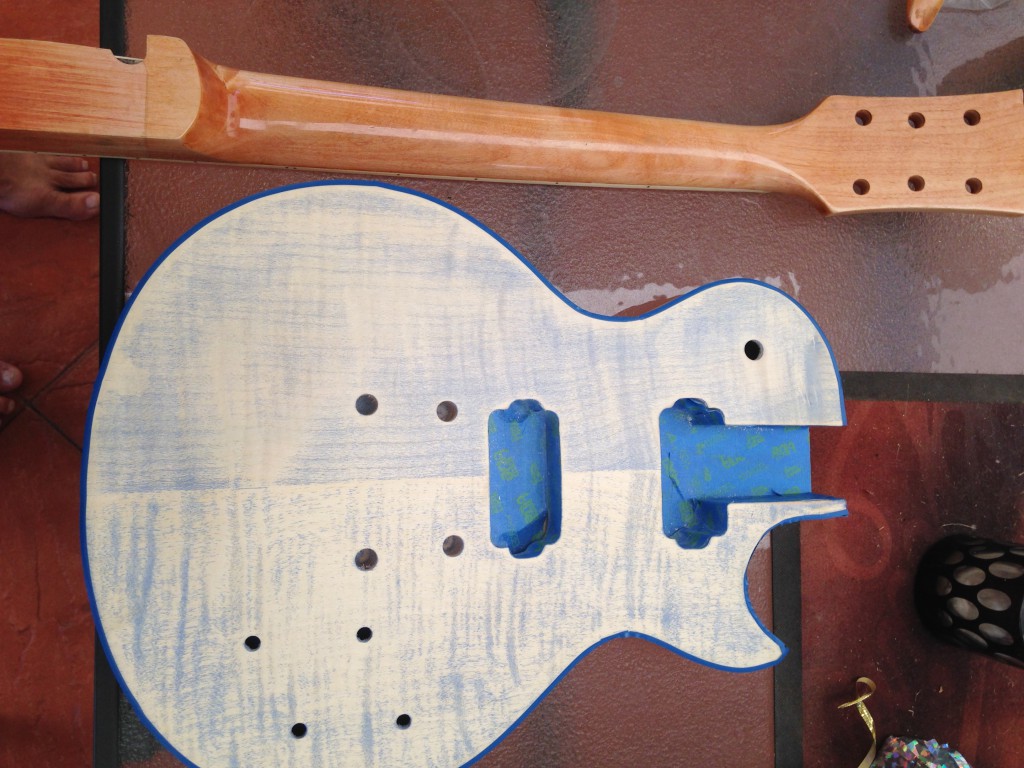

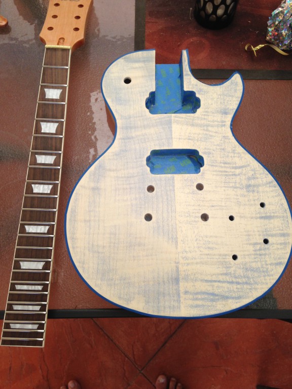

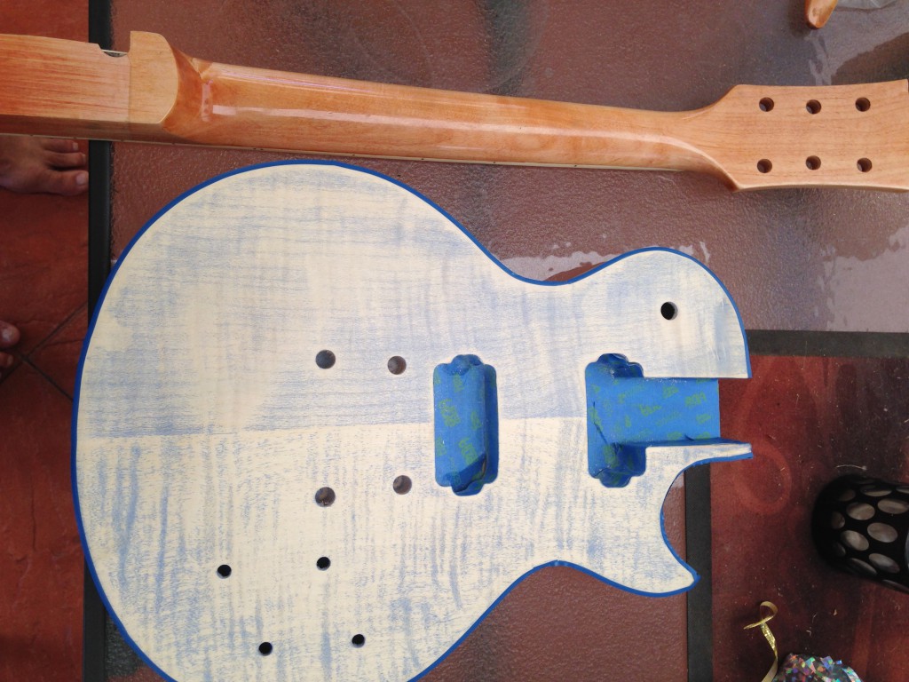

    Well after 2 weeks of work I've finally got it down to as much wood as I can get. I've applied a sanding sealer and rubbed it back to 1200. Waiting for lacquer to arrive.
ID:	7439 Click image for larger version.
    The neck is finished after a fret level, fret crown and polish. Given that I've rubbed the body to 1200, will I need to rough up the surface to apply the nitro lacquer?

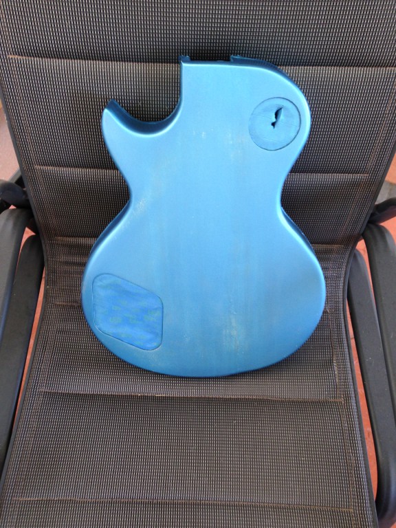

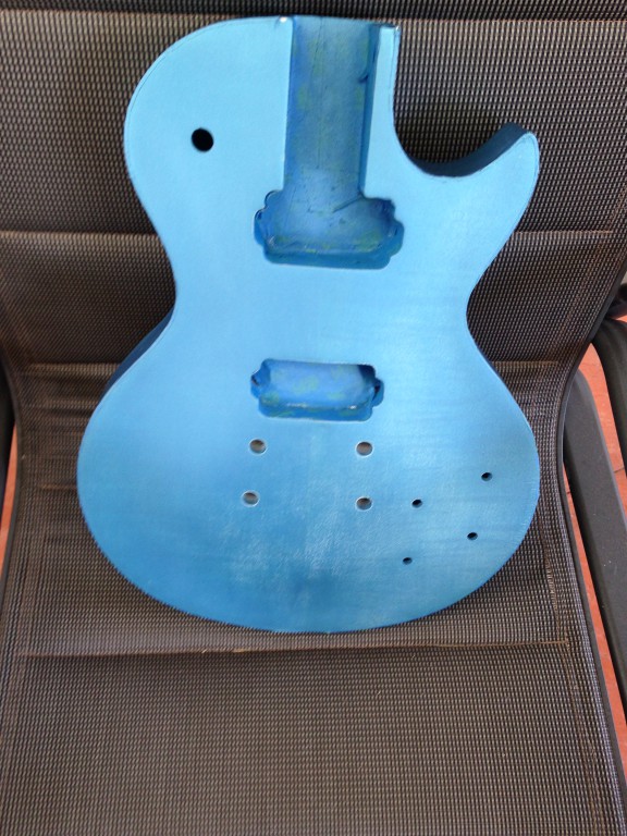

    Paint has finally arrived. Here is what she looks like after one coat of Lake Placid Blue.

  6. #36
    Hey Salo I like the colour. Have you put any primer coats on ? Can still see some grain in parts. Also would be important that you grain filled before the primer coat or you will never get a flat finish.
  7. #37
    Member Salo's Avatar
    Nov 2015
    Padbury WA
    61
    Hi Wokka. I've used sanding sealer. Where it's a bit grainy is where there is some of DT is in the grain that I just haven't been able to get out. I've applied a second coat couple hours ago and it seems to have covered really well.
  8. #38
    no worries Salo, after a 3rd coat the colour should be solid

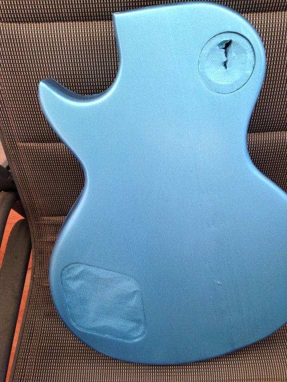

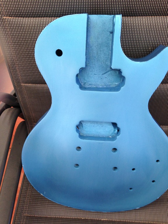

    Well here she is with a third coat and sanded down for the last coat.

  10. #40
    colour is looking better Salo and more consistent.
    Look forward to seeing it after the final coat.
    If I had a dollar every time I thought the last coat WAS the last coat I'd be well retired haha
