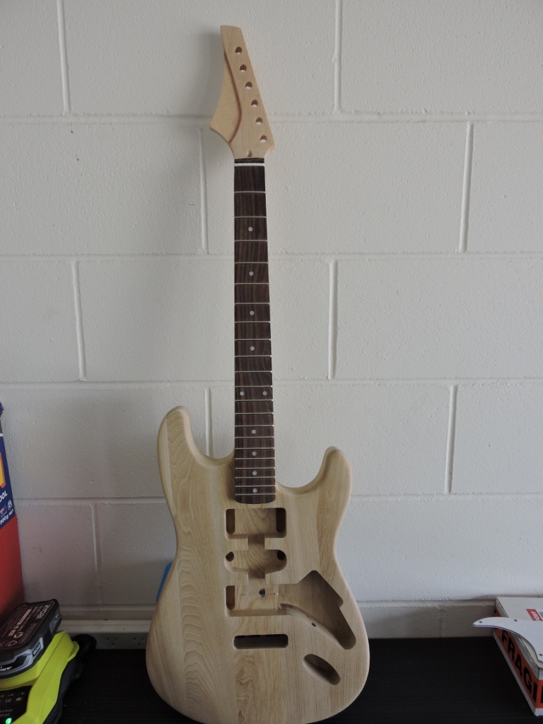

  2. #32
    Mentor vh2580's Avatar
    Cleveland Qld
    1,184

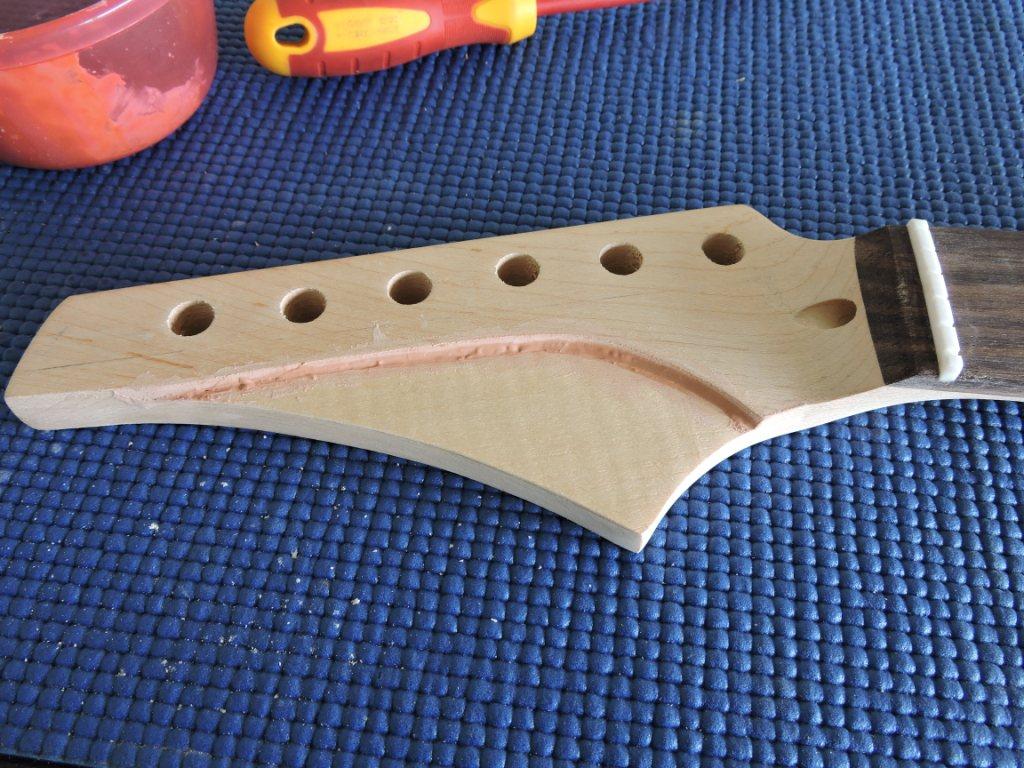

    Trimmed the veneer edge off with router and rough sanded again. Have put some maple timbermate into the undercut join area to close the small gaps. Once sanded back will be near invisible.
    Happy with how this looks against the guitar body.

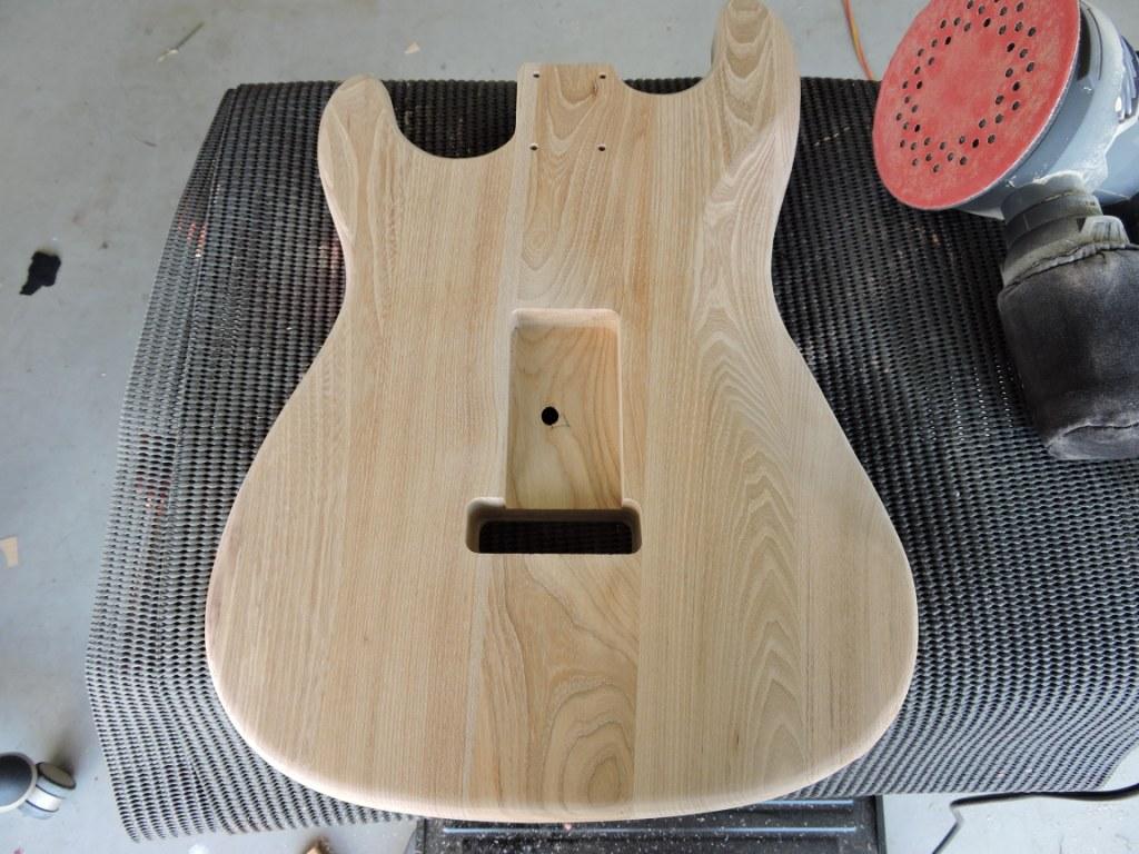

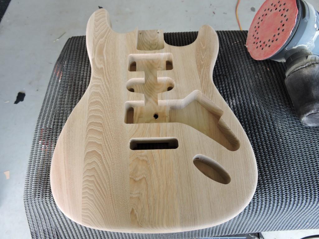

  3. #33
    Cleveland Qld
    1,184
    Starting to sand the body back and the grain is really starting to come out. Cant wait to get some colour on this.

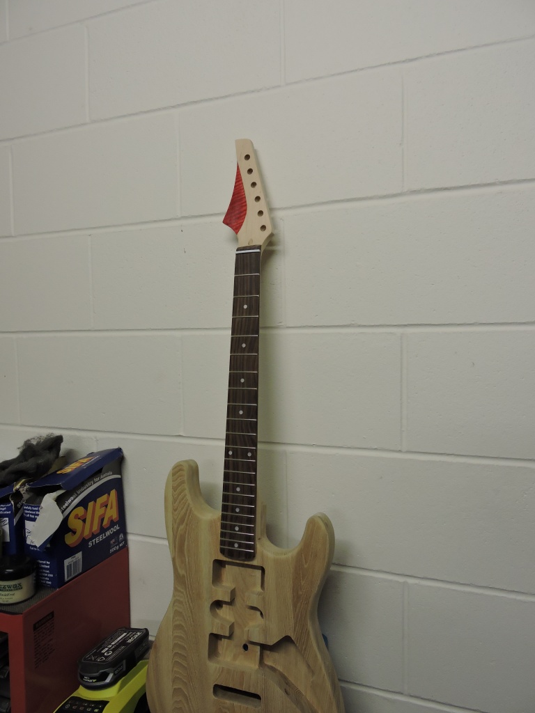

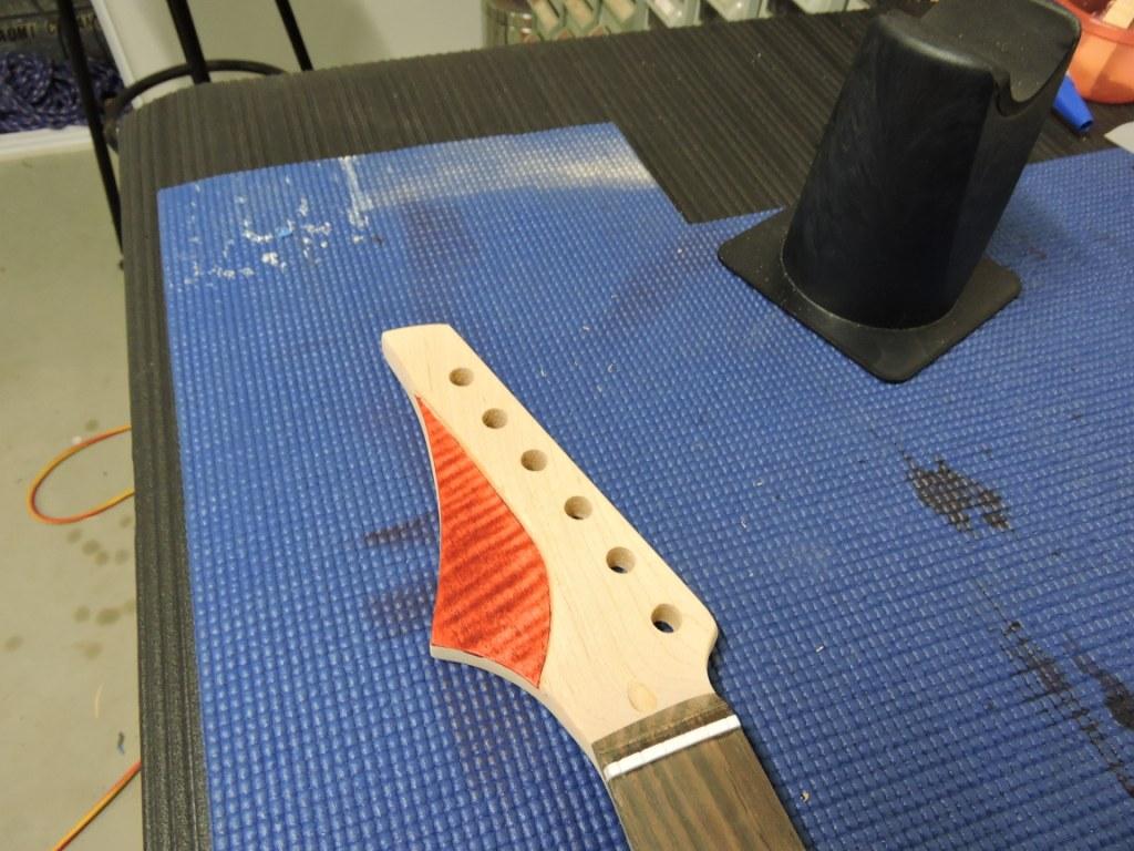

  6. #36
    Cleveland Qld
    1,184
    So headstock cleaned up and neck sanded to 220 all over. Masked up and 1st coat of Karijini applied to maple.
    Once done past intensifying coat will sand entire neck to 360 and start with clear.

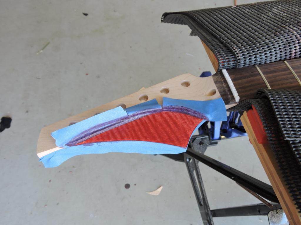

  7. #37
    nice one Tony that flame maple pops with the karijini. Whack another coat on and it will look the biz
  8. #38
    This build has awesomeness written all over it, I especially like the headstock & the Karigini looks stunning. Not to mention the tasty ash grain!
  9. #39
    Cleveland Qld
    1,184
    Quick Update. Two coats of colour and three of intensifier.
    A little bit of bleed through the tape but nothing a couple minutes with some sandpaper wont fix.
    So for first time using Dingo tone and gotta say it goes on easy and in this hot muggy weather dries pretty quickly and takes additional coats easily.
    If the body comes out this colour will be stoked.
