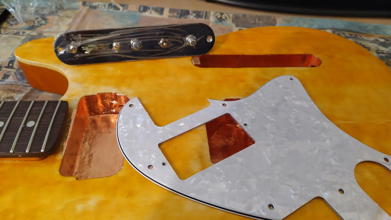

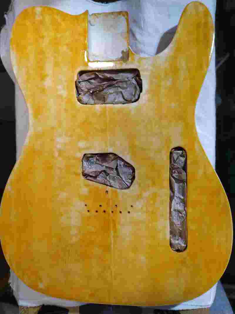

    Hi Scott @WeirdBits & Simon @Simon Barden , now I resume our previous March posts
    i'm on the way to finish my telecaster.
ID:	37980 Click image for larger version.

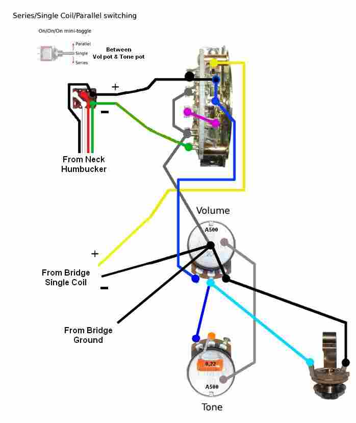

    Now I have to prepare the control plate with the right wiring.
    So to confirm that everything is right I put here the Scott diagram to which I made some small changes, I put two Bourns potentiometers of 500 for tone and volume with an orange of 0.22, I changed the connection from tone to volume as that of the 50s.
Name:	Senza titolo 2.jpg
    Is it right or do you have some advice to give me in particular also for the orange cap?
    Also a question: but in this case it is necessary to put a resistance of 470 for the bridge single coil to see the pots at 250?
    Anyway tell me everything that goes into your mind .... and thanks for the suggestions.
    Cheers Stefano

    Your changes to the diagram look correct. The modified tone will give a vintage 50’s style control, just make sure the capacitor connects between the lug and the back of the pot (can’t see the back of the pot connection on your diagram). The key element of the 50’s style layout is that the tone link connects to the middle (output) lug of the volume pot.
    The 500K vs 250K volume pot is always a compromise when you’re mixing a humbucker with single coil. The humbucker should sound better with the 500K pot, and I think particularly for the bridge + neck series setting on the 4-way. You can compromise and try to get a lower spec 500K pot with a value closer to 400K, or permanently add a resistor across it to give you a custom value but that alters the taper of the pot. I’d stick with the 500K volume pot at first and see how it sounds across all the different pickup combinations, as you can always roll off some tone if it’s too bright but you can’t passively add treble if a sound is too dark from a 250K pot.
    Your question “necessary to put a resistance of 470” I assume is about adding a switched resistor across the pot for the bridge position so it has an effective 250K value? Unfortunately, with the way the 4-way switch is wired to give the series position you can’t add a resistor that is only connected in the bridge position, it would have to be in the circuit for all combinations with the bridge pickup. As stated above, I’d stick with the 500K initially and then decide later. You can always temporarily clip/connect a 500K resistor across the volume pot to see how it would sound if it was 250K.

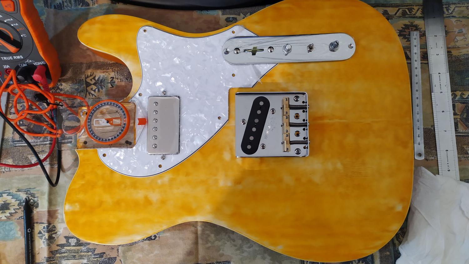

    Well, I went on with the project as in the previous msg; yes the 0.22 capacitor is soldered to the back of the pot and the central lug (Right?)
    Now, after shielding the cavities and attaching the neck to the body,
    I'm connecting the pickups:
    Neck Humbucker and Bridge Single.
    I attach photos with the polarities, As you can see from the neck to the bridge the polarities are:
    South North (Humbucker) South (Single) .... is everything okay?
    Or should I check something else?
    Again thanks to all of you.
    Stefano

    The wires of my Humbucker: Black for - , green for + , Red/white for Series/Parallel (Black with White & Green with Red)
    Stefano
