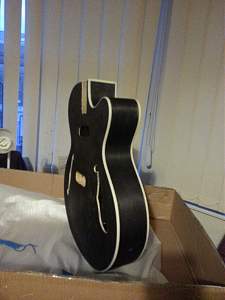

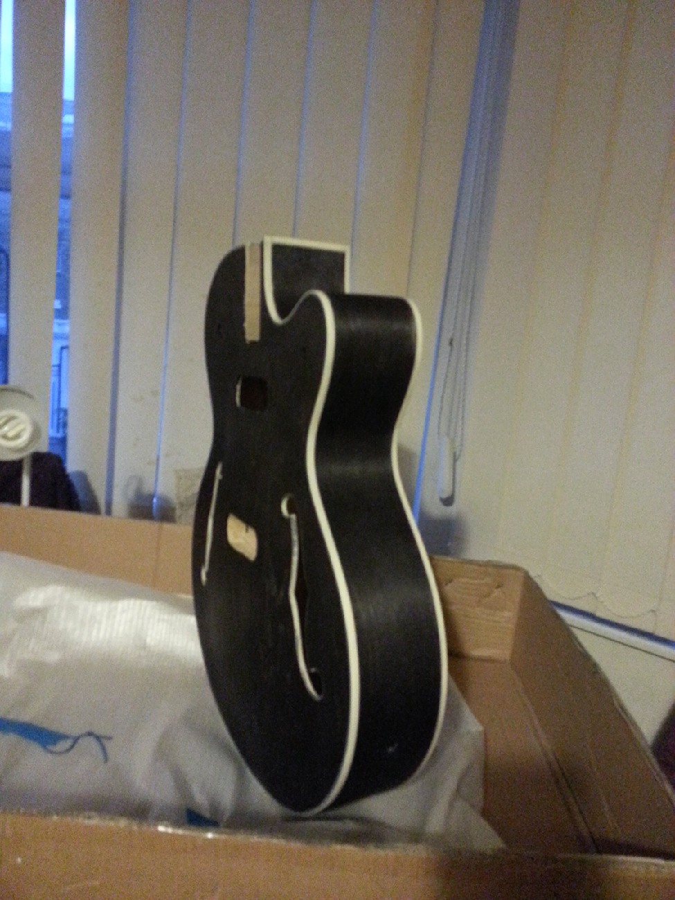

    I have finished the staining and took the masking tape out.
    Note to self: buy a better brand of masking tape next time. The masking tape left a huge amount of glue on the binding and it really was a b**** to clean up. I also realised a few touch up are required here and there on the back and front but nothing much. I am waiting for the TO to arrive before I can start the clear coat.
    On to the next step, I am looking forward to put 75 coats of TO on.
    Quick question for the experts. Should I do the front or back first put all the coats down then move to the next part or do you guys usually do Front, Back and side at the same time?
    I am possibly going to start the wiring as well this week.
    Quick photo for you guys. I am liking the look so far.

    Looking great! I remember cleaning my RC binding about 4 hours after the staining and I share your pain. Its good to coat either the top or back/sides and same with the neck at the same time. This way you get to do the sqnding between layers the same time on both and see the progress. 75 coats is alot and I think that after 25_30 you see that you have achieved about enough for a high gloss if that is what youre after. I'm now at about 10 on mine and about to do first TO sanding hopefully tonight or tomorrow. I've been less generous on my coats this time so gonna start with TO and 1000 grit just to be sure I don't go thru the coat. 75 coats is gonna take about 20 days and the start over again for the other side - I bow to you if you have the patience for it. I would not right now anyways.
