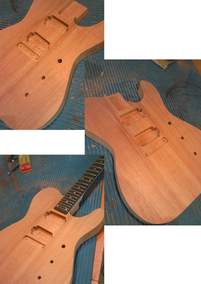

    Got all the top routing finished and the holes drilled this morning, just have to clean up the sides a bit more then it's time to start carving.
    I changed my mind at the last minute and opted for a Les Paul style toggle switch in favour of the Tele 3 way, hence the third larger hole.

  5. #35
    nice job Barge, gee you don't muck around.
    So TOM bridge and trapeze tailpiece ?
    I have the same problem with a router the lock button won't stop the shaft spinning when trying to loosen the collet. Oh well will keep using it till the router bit is blunt

  7. #37
    hey Barge, just so i understand, TOM bridge inset due to low or no neck angle? how did you work out how much?
  8. #38
    Stan, presume Barge got a long ruler and placed from nut to the TOM on the body and roughly worked out how much lower it had to go so the strings rest on the 24th fret when bottomed out
  9. #39
    Banned bargeloobs's Avatar
    Mar 2014
    1,700
    Yep, there's no neck break angle on this hence the recessed bridge. I based most of my measurements off the "Bladecatcher" since there's very little difference in the overall height of this neck and the PBG Tele necks at the heel.
    Neck pocket depth, and bridge rout are the same as the Bladecatcher. I did a dummy run with a couple of strings when I worked out my lateral bridge position and the string height is looking good, once the bridge is dropped the 6mm it should be pretty spot on (fingers crossed).
  10. #40
    sounds good Barge sure the heights will work out. I'd drill your bush holes and work out the thickness of the bush might raise the bridge couple of mm in its lowest position
