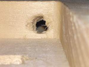

    Checking that the pup leads reached to the small PCB on the balance pot I noticed the bridge pickup sticking out much too high. I hadn't noticed when I did the original parts layout.
    Turns out the hole from the pup route to control cavity is misaligned.
    The normally the pup would have to lift a little to let the lead out from underneath. This lifts it another 3mm.
    I filed down the hole to let the lead run flush to the floor of the pup route.
