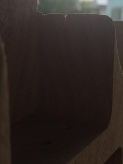

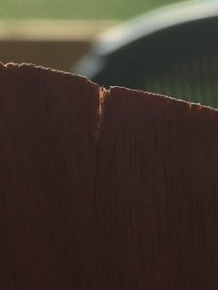

    Noticed a small crack in the neck pocket the other day too.
ID:	4726Click image for larger version.
    Hopefully when it's all glued together that won't matter.
