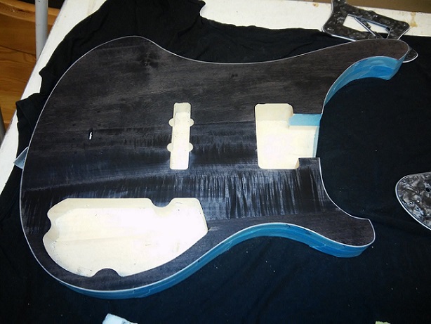

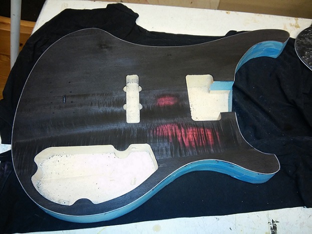

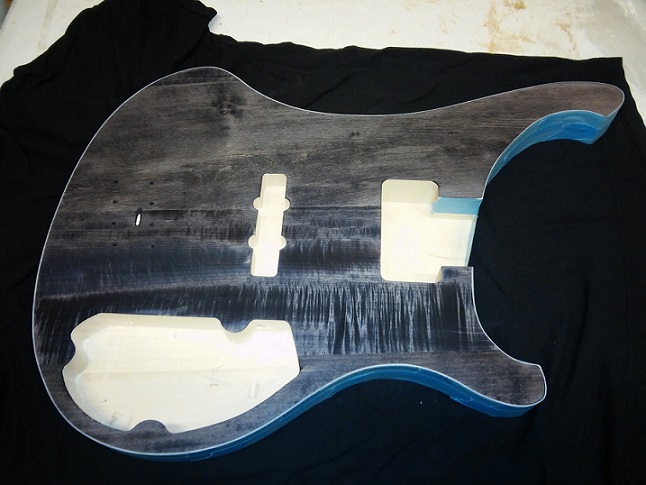

    a bit of an update at last. So I stained the body and neck with Keda Dye Black Cole. These are pics of 1, 2 and 3 coats of stain and sanding with 180 to 240 grit in between coats.
    After the black was ok, I sanded the flaming and applied one coat of Fire Engine Red on the sanded part. After it had dried, the red had left visible edges on where it was applied - so I sanded the edges and faded it with a piece of cloth just dampened with the black and wiped from edges to center until I was satisfied with the results.
    The dye is very powerful - I only needed to make less than 2dl of stain for the whole body and neck. Using about 1/4 of the powder.
    As you can see - the red mixed a bit with the black creating a bit pinkish/purplish color. Maybe I didn´t let it dry enough...
    More to come...

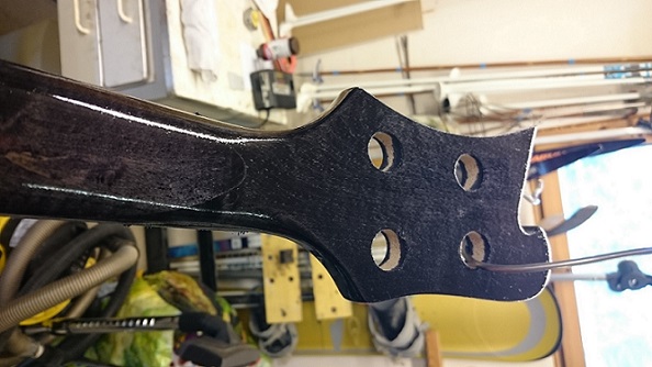

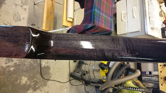

    abit after TO...
    So, applied with a cloth - 2-3 layers a day with 4 hours in between and seems that the garage I´m working in is very dusty and this is problematic. Also the TO layers are so thin that this will take a lot of time and layers... If I try to get an even surface and maybe polish it some day. On the good side - the TO is very easy to apply and user friendly in terms of unwanted vapours.
    On the top it looks quite nice and the neck has some nice grains on it. Different but I like it. But as you might see - from another angle the top is full of small dust- and other particles.
    I have buffed it gently with 00 steel wool about 4 times now and even tried to make one slurry TO layer (after 6 layers) to even it up but didn´t work too well. So now i just put very thin layers upon layers and hope that it will come more even at some point - steel wooling between 3 layers.
    Did not use any grain filler on the wood so this is probably the main reason for the TO not becoming even more quickly. The grain fillers that are available here would have caused problems with the staining so I skipped the part.
    Any tips and opinions on these?
    Arzi
