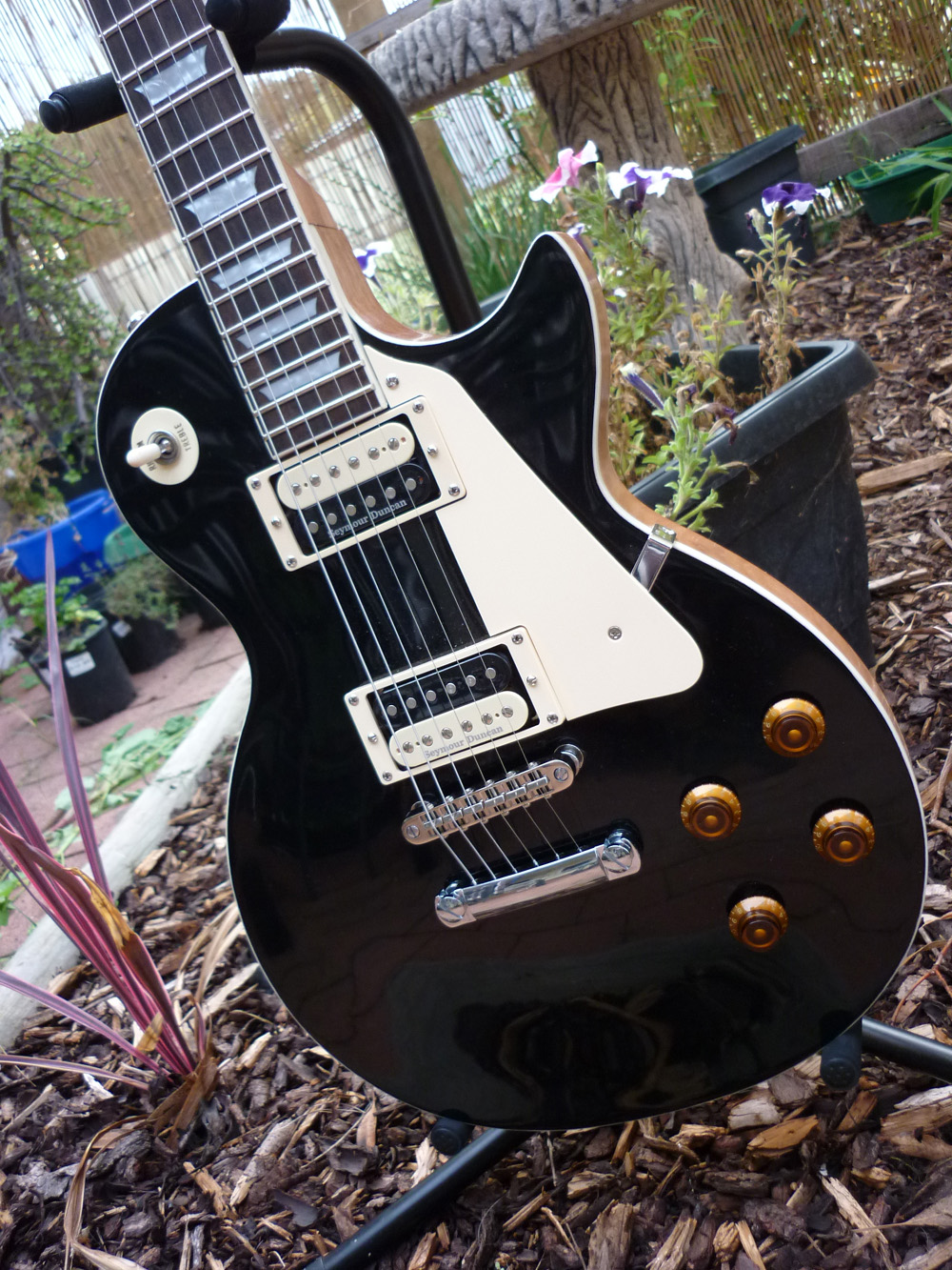

    If you're looking for a "deep", "traditional" look from lacquer I'd have to put my vote in for Nitro Cellulose. It gets a bit of a hard time round here from certain luthiers (who shall remain nameless), but there's a good reason why it's been used pretty much since the birth of the electric guitar. It's hard wearing, doesn't have to go on super thick, it expands and contracts with the instrument and best of all can be bought to a beautiful high gloss finish (see pic).
    I've never used Toneriders but all indications point to a really solid pup and hey, great thing about electronics is you can swap em' out for SD's further down the track without any noticeable alterations to the instrument. The one that always gets me is tuners, as if you decide to go with the stock ones if you ever want to swap out later on you're gonna be left with spare drill holes....yuck. Just something to contemplate if you're building a keeper that you want to use as a daily instrument.
    You can get as picky or as relaxed as you want to with your builds but as the quality of the guitars on the forum become increasingly higher, if you want to seriously be in the running for GOTM consideration you really have to get a little bit OCD.
    If you are as you say "hopelessly competitive" you'll find it hard to settle for anything less than perfect and as a consequence end up with an instrument to be truly proud of.

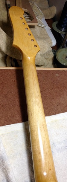

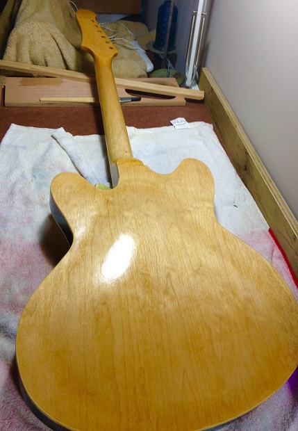

    Getting there, nearly done with the shellac. Will let it cure for a week before sanding and polishing.
