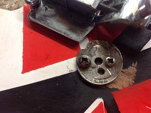

    I have a floyd as well, and have ordered a black 3 ply scratch plate to hack up. Need to find a 1971 quarter, I have a stack in my toolbox so I'll see if I have the right one, might get close, and I have a cheaply bridge humbucker and single coil to put in it. I'd expect to replace the humbucker with something better down the road.....
    Need to source the hooks eyes and the reflectors as well as a correct metal 3 way switch for the middle pickup position.
    Will use the Schaller knockoff tuners which come with the kit, unless I can get the correct ones at the right money.

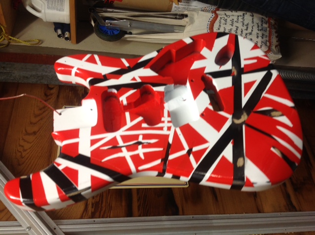

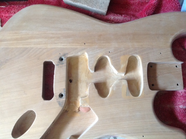

    Well I have done a bit more on my evh Frankenstein...
    Here's the body I modified from hsh before paint...
    And here's the body after paint. I used a Bunnings epoxy enamel for the white and black and a straight enamel for the red so it did not cover as well which was what I wanted. There's no primer as it would show through in the wearing process, so I used a lot of coats of sanding sealer to get the ash body smooth first.

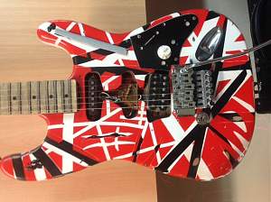

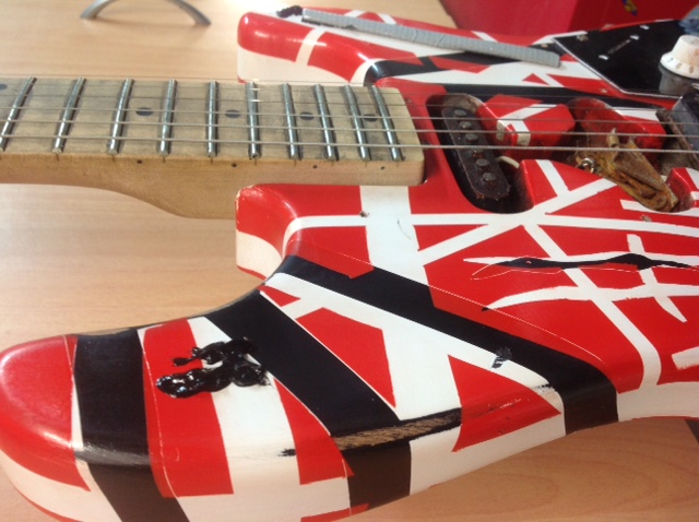

    Here it is today. The front is close now, most of the markings and lines are in the correctish places!
    The pickup is a real cheapy, as is the floyd. I replaced all the Allen bolts with USA ones so it holds together ok and stays in tune.
    Unfortunately I can't play it like Simon so I'm not going to embarrass myself with an audio demo 😊
    Attachment 18065

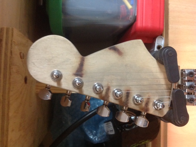

    looking good Andy. Is there supposed to be anything on the headstock any logos or the same paint theme as the body ?
    Mentor Andyxlh's Avatar
    1,206
    Thanks mate! Not in this guise. This guitar had all sorts of stuff bolted to it over the years, but originally it had a plain neck with a Tele style heel and a strat headstock. For a while v h had a Gibson sticker on the end of it too!

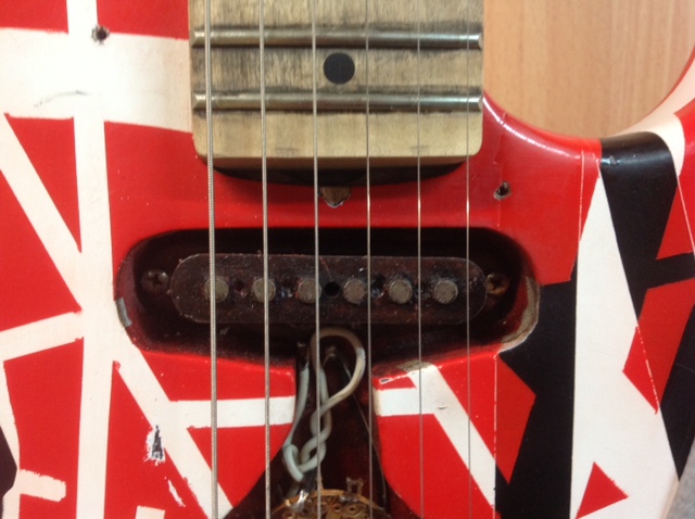

    Here's that neck joint, with a .96mm pick for neck tilt and a few layers of al foil in there to get the angle right. It is a Tele style neck in a strat body cavity so it is not supposed to fit right.......!
