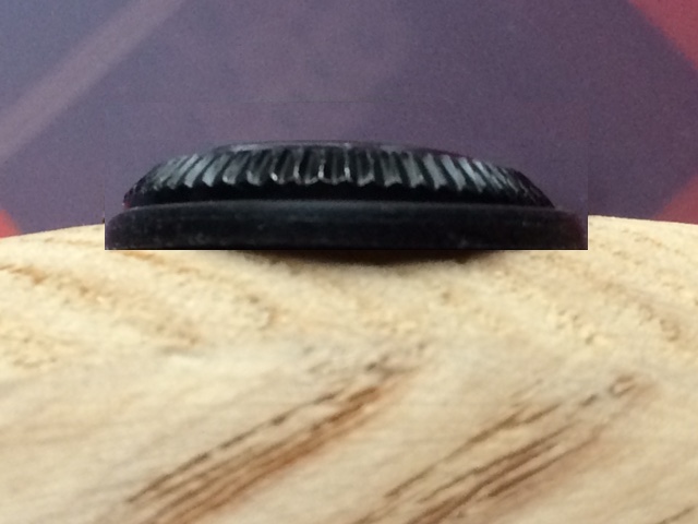

    Here's what I'm thinking as far as recessing the jack goes.
    If I file the marked area, because of the curve of the body it isn't necessary to recess a circular area for at least the first depth because there is no wood there to remove (it curves away).
    Hopefully getting something like:
    (artists impression)
    and further recessing might still only need filing across the body as the sides of the recessed area fall away with the curve of the body.
    Feel free to point out any flaws in this plan.
    - Sam
    IB-6S - done.

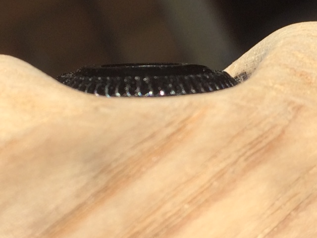

  8. #38
    Jun 2013
    414
    I know on mine the jack output is completely recessed in as hopefully the below picture shows.
    Not sure about everyone else that has done a ib-5

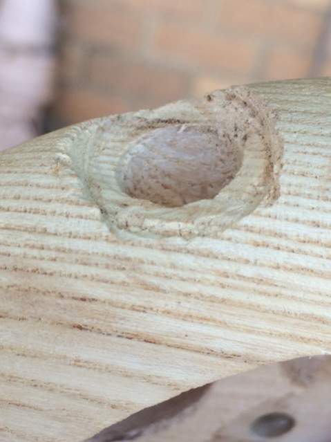

  10. #40
    So the jack recess is done.
    I started using a hole bore drill bit, handheld. Didn't really trust that thing running at high speed without a centre guide.

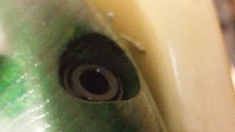

    Then using the dremel to level out the recessed area, sandpaper to round the corners, I ended up with a recessed jack I'm fairly happy with.
    View from the front of the body:
    - Sam
