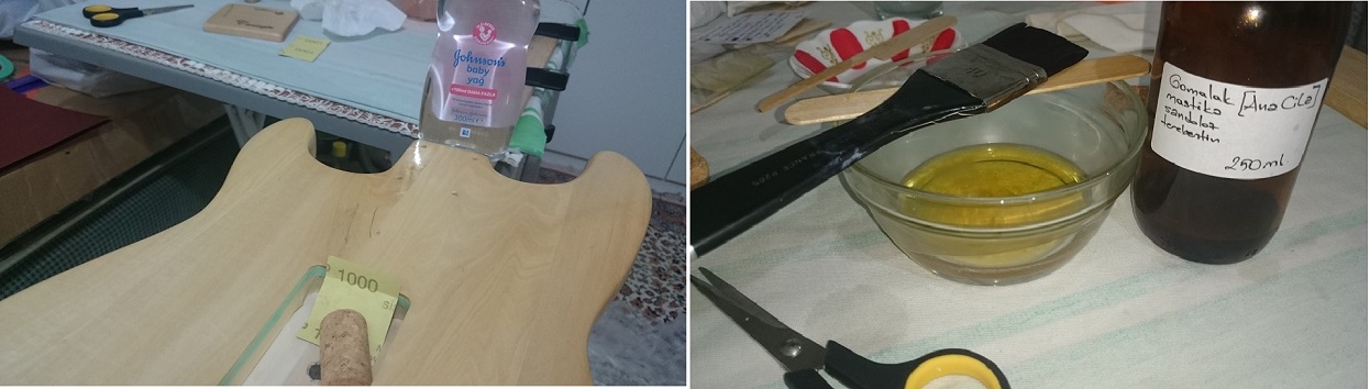

    I cut a cork into half and used as a sanding block. It's practical to use a little pressure with it and since it has a round outer surface it can also be used in curved edges easily...

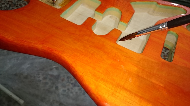

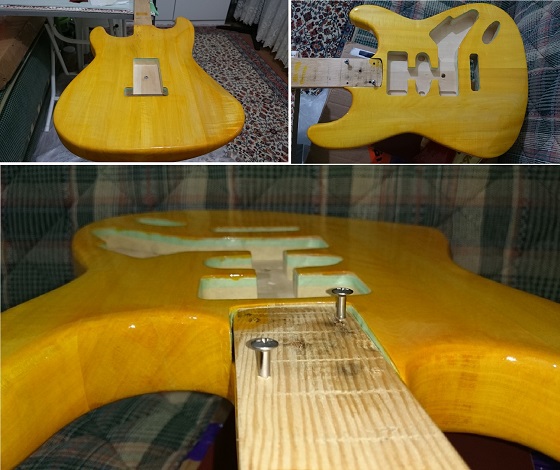

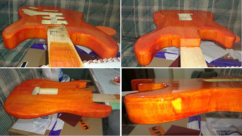

    The Yellow was easy to work with and 3 coats (each of them has two ways - going down / going up - and all of them has 1 week delay)
    Then came the orange... I couldn't guess it was the trickiest color
    I did a first coat of it but I was scared. It wasn't good. Anyway, I went on.
    Second coat was merely ok but there were lots of spots to be retouched.

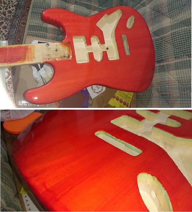

    This looked pretty to me so it was The Red calling me
ID:	6673 Click image for larger version.

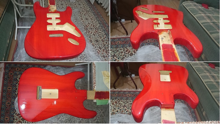

    I did a 5 layer of red color. Each of them had 7 days delay and after the final red I waited for 2 weeks to get it set. After 2 weeks, I covered my red color with 5 layers of my primary (filling coat) colorless shellac. I waited 7 days between each layers and after the last layer I gave 2 weeks to get it set.
    After that, I did another oiled sanding upto 2000 grit. Beginning with 1000 followed by 1200 - 1500 - 1800. When finished 2000 grit, I applied another layer of colorless shellac, sanded again, shellac again and one final 2000 grit sanding with baby-oil.
    It was now time to begin a polishing phase, I boiled another shellac formula but this time I used brown shellac flakes. The filling coat and the colors were white shellac gums.
