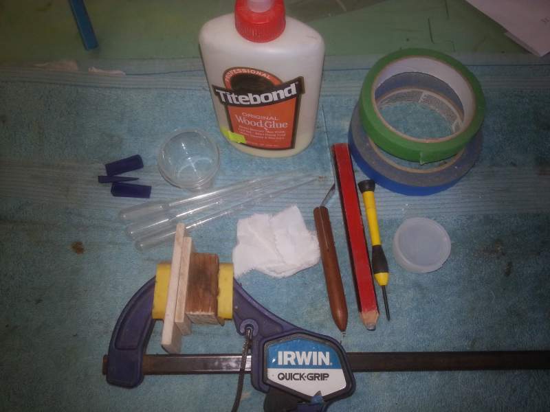

    Pretty much think I have everything I need.
    clamp, little blocks of wood, glue. some cotton and polyester patches(the poly is actually stronger than the cotton)
    wedges to hold the fracture open while I squeeze glue in from one of the pippettes.
    little sealable container to put screw in so they don't get lost.
    Tape for protecting the outside(green low tack tape)
    StewMac spatula for pushing glue under the fracture.
    Now just need it to stop raining.
    First up I'll trail fit the clamp incase I need to get soem bigger/smaller/thicker blocks
    PK

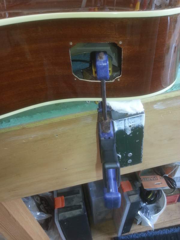

    After taking on board everyones advice,
    I have swampped the area with glue,
    glad wrapped the clamping block,
    clamped the clamping blocks
    and now waiting for it to dry,
    next task will be tomorrow, glueing some cloth over the area

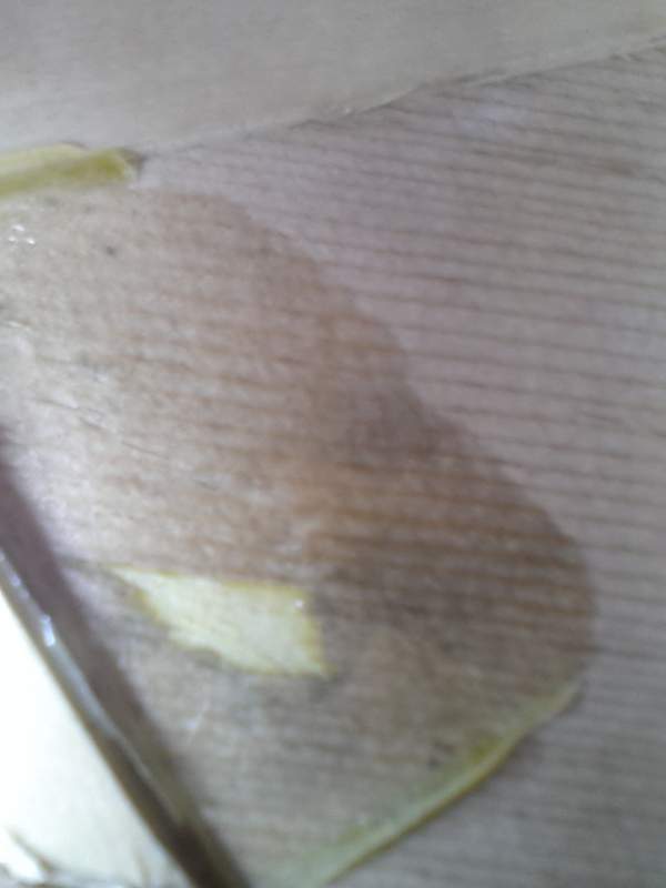

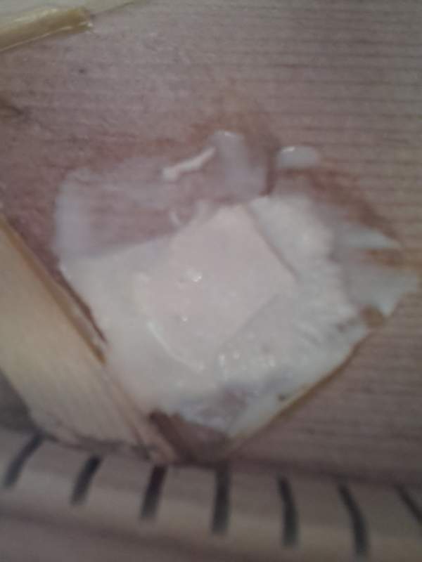

    Jobs Almost done
    Glue down of the delamination has worked a treat.
    Now I've applied the Andrews patch to the area missing bits of laminate.
    I've used two pieces of cotton in a sea of glue.
    In a couple of hours I'll put it all back together. with a new Set of D'Addario Phosphor/Bronze 10-47's
    I always use light gauge strings, it's a touchy feely thing.

    that's a pretty nice fix Paul, it should do fine. You are now in the Epi fixers club!

    I should stick the dental mirror in and have a look. I pressed the galdwrapped block in on top of the patch to try flatten it a little.
    But over all it seems to be rock solid. the repaired brace is holding well even though I felt I didn't get enough glue into the crack.

    it will be fine, good job. String her up and enjoy - and you learnt some stuff and repaired your own guitar - all good!

    Nice work!
    That repair should be stronger than the rest of the Guitar now.
