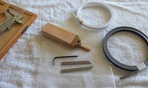

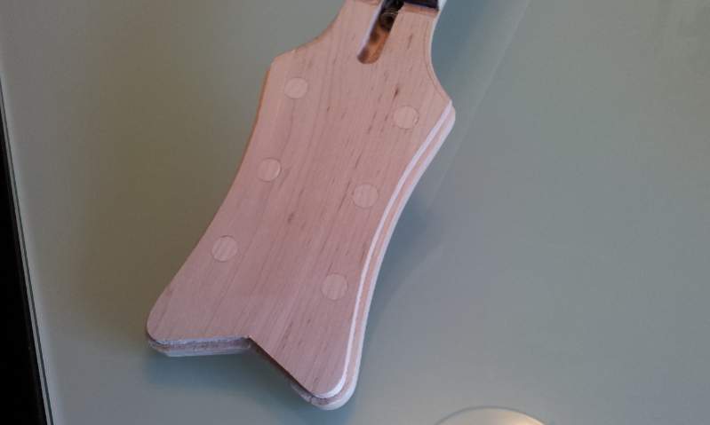

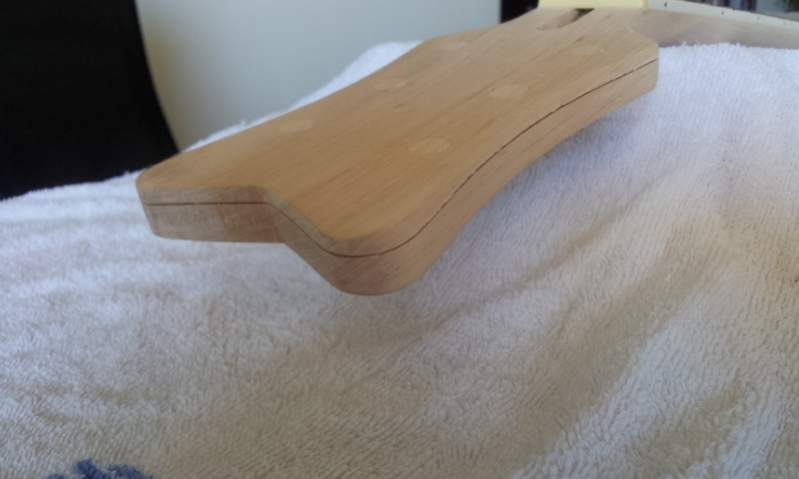

    Well, with the “binding-channel-cutter-tool-thingamajig” and binding having arrived and sitting around waiting for me, I just couldn’t help myself … so it was off to start Phase-1 of the binding of the headstock … and either loose a couple of fingers and make a complete botch of it … or … surprise myself with having done a passable job … but first back to the beginning …
    After first getting the GR-1SF, it took me about 30 seconds to realise that with the bound body and plain headstock, it just looked a little naked “up top”, so the decision made itself – bind and be damned. So began a crash-source in binding – without power tools! I guessed if luthiers have been successfully doing it for centuries by hand then I could certainly have a crack at it.
    A bit of research and scouring of suppliers and lot of planning and I was all set (yeah, right! ).
    The helpful folks at Australian Luthier Supplies were the only stockists of the “binding-channel-cutter-tool-thingamajig” and the ever-reliable Realtone had just the right bindings … so both were duly ordered.

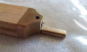

    The tool itself is quite simple and to be honest, if I’d had access to a reasonable workshop I could have made one a lot cheaper than it cost (about $60) but it is well made and I guess it’ll provide a good excuse for more kits (and them too! ). The two grub-screws (one on each side) allow for lateral positioning of the blade and the depth is controlled by how far it’s inserted when the grub-screws are tightened.

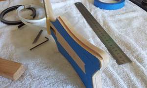

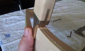

    With the blades set to the appropriate measurements … and a couple of contemplation of what I was about to undertake and the potential ramifications of not getting it right (how much is a replacement neck for a GR-1SF? ) … I started cutting … and cutting … and cutting … and … (it takes many passes, each time working a little deeper)
Name:	Cutting the side.jpg
Name:	side cut complete.jpg
    Wait a minute ... that sounds like Rock and/or Roll!
    SG-1 ... "Little Miss" finished in Flamenco Cherry Wudtone
    TL-1A ... "Slugger" finished in Antique White Nitro
    EX-1 ... "Metal God" finished in nickel-plate (work in progress)
    ST-1A ... "Scrapper" stained and finished in linseed oil ... and with the "secret weapon"
    GR-1SF ... "Rocker-billy" (just arrived, work in progress)
  9. #39
    Member Scott J.'s Avatar
    Jul 2013
    390
    It’s not a quick process, but quite satisfying (think of the zen of raking pebbles! ) the side cut to the full depth took about an hour all up …
Name:	cutting the face.jpg

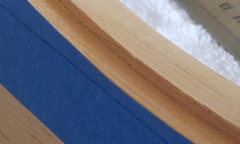

    … and the face cut about 2 hours … all the time being careful not make an stupid mistake (or lose a finger – these blades are necessarily razor-sharp).
    Quite pleased with the end-result … the channel produced by the tool was really quite clean and very neat and requires almost no clean-up (which I’ll do with a sharp cabinet-scraper) … and I still have all my fingers (although I did manage to pierce the end of one finger quite deeply … ouch! … and blood everywhere but fortunately not on the timber!)
Name:	channel complete left.jpg
Name:	channel complete right.jpg
Name:	Channel close up.jpg
    The sharp-eyed will have noticed that I didn’t take the channel all the way up to the nut.
    Due to the side-shape of the head (and it’s not being originally designed for binding) I found that if I did continue the binding through, to achieve a nice line (without an obvious and ugly “step”) between head binding and fret-board binding, I would have had to taper the binding down to about 2mm which, when I did a test mock up, looked really silly … in the end a test mock-up seemed to show that finishing the head’s binding at the “shoulders” didn’t look to bad at all – not a traditional fully bound look (which was the original plan) but certainly quite attractive in its own right … but we’ll just have to wait and see how the end-product shapes up.
    Next Phase – installing the binding
