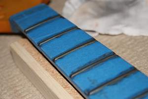

    Fret Leveling

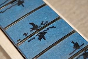

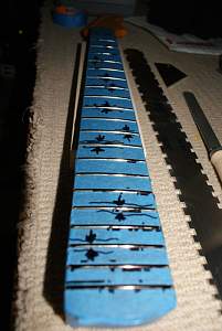

    This is the one that scared me. I watched so many different videos on this. Once I got the fret rocker and went over the fret board I found so many frets were not level. Never very much in it and who knows if this would have made a significant difference, but if I am doing this, then I am going all the way.
    The board all taped and marked where the frets are high - you can see the marker is everywhere.
Name:	Fret Level 1.jpg
    After sanding. Videos have told me to sand till there is at least a thin line through the marker pen
Name:	Fret Level 2.jpg
    This is the first fret. You can see how much was taken off on the far side to get the near side to just be done.
Name:	Fret Level 3.jpg
    Covered the frets with marker pen again and got my new fret crowning file out. This time you go till a thin line of marker is left.
Name:	Fret Level 4.jpg
    Taped up again to cover where the tape was damaged. Ran some fine grit wet and dry (in dry state) along the length of the board. Removed as much of the tool marks as possible and polished them up a bit. Then got out the dremel with a polishing bit and some polish compound to make them sparkle.
Name:	Fret Level 5.jpg

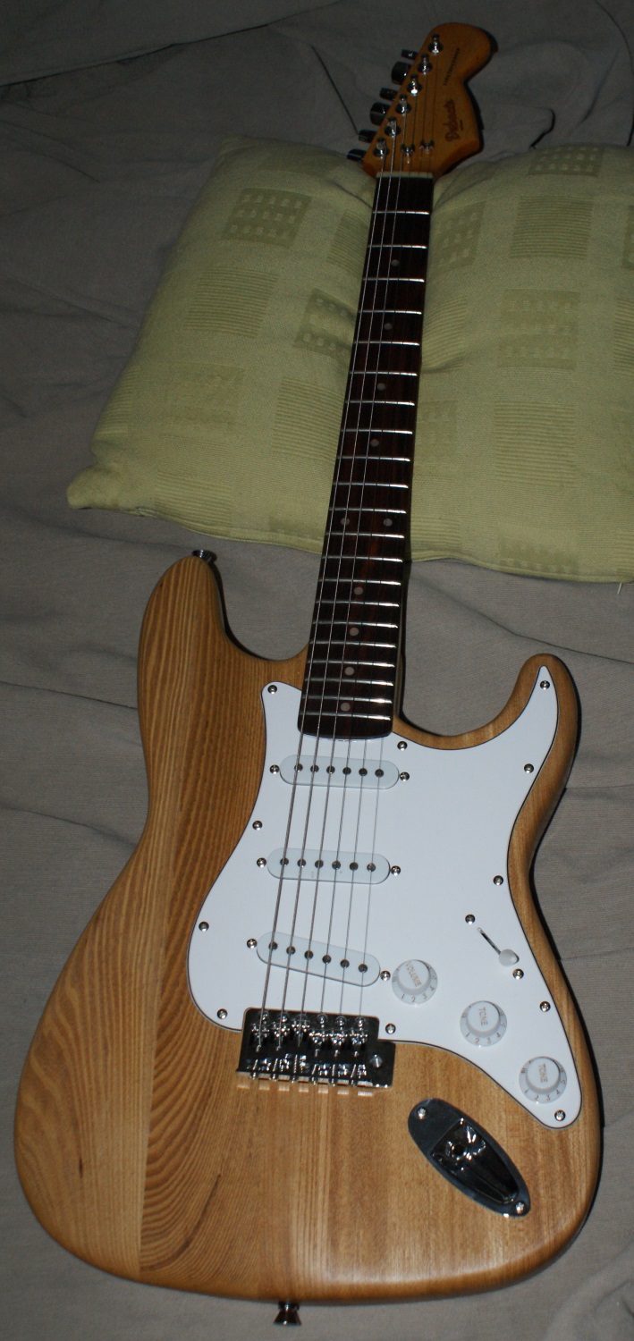

    FINALLY - it is done

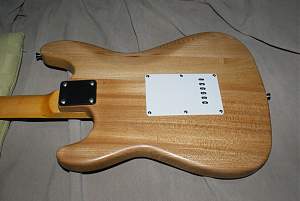

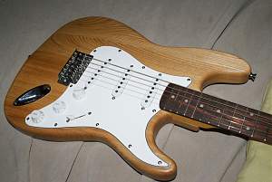

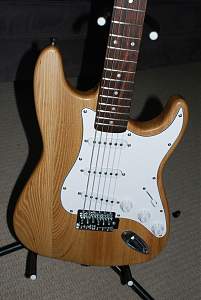

    I had a number of issues with the top coat on the body. I have used the Dingotone Colourless finish and when I put the first coat of top coat on it dried to a tacky finish in about a day, but stayed tacky for weeks. After about four week I thought I must have put too much on so I rubbed it over with some copy paper first, but that did not get rid of it. I then tried some 800 wet and dry which clogged up quickly, but worked to get the tackyness away. The stuff coming off was actually balling up.
    So I did another coat and tried to go as thin as I possibly could. Same thing happened again - dry to tacky in a day or two then stayed tacky. I left it for six weeks and gave up. 1200 wet and dry the second time. I then bought some beeswax furniture polish. Done!
    Neck on.
    Scratch plate on.
    Bridge on.
    Solder earth and plug.
    Machine Heads on
    Strings and string guides on.
    Action and intonation set.
    Here it is - The StratoScooper 001 - Blondie
ID:	3672Click image for larger version.
ID:	3673Click image for larger version.
Name:	Body from top.jpg
ID:	3674Click image for larger version.
ID:	3675Click image for larger version.

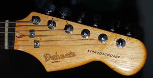

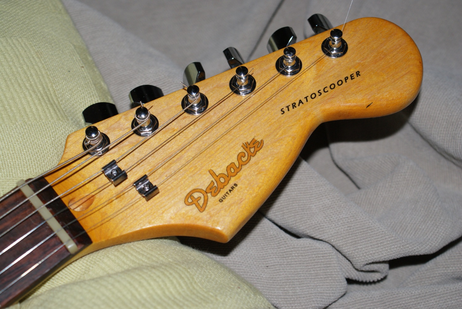

    And the headstock
    Front and rear of the headstock. I managed to scratch off some of the "brand" name when I was buffing with steel wool.
ID:	3677Click image for larger version.
ID:	3678Click image for larger version.
