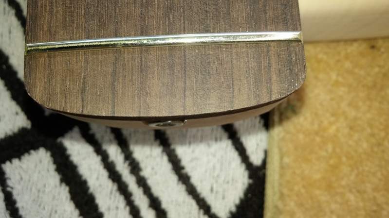

    Loosened the truss rod....no plastic hammer.....little bit of wood against the truss rod end and a small tappage with a steel hammer. It has popped right back in. I tightened it up again and all is good....loose now as I do the finishing.

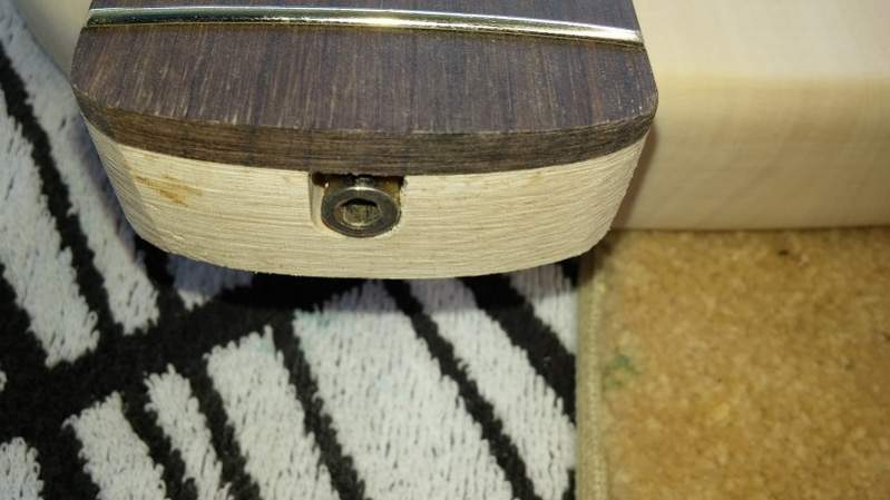

    Ozzbike can you please post a photo of the neck heel/truss rod ? Mine still protudes over 10mm out, so sounds like thats not the correct position. I figured it protuded and the adjustment is put a screwdriver in the holes drilled in it
  3. #33
    Mentor ozzbike's Avatar
    Sunshine Coast, Queensland
    1,109
    The Truss Rod
    As requested a couple of shots after applying DB's fine correctional advice. The Truss Rod is loosened off so it would go in even a tad more.

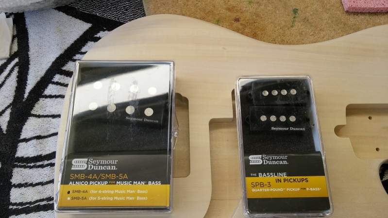

    I have to find some 125mm velco discs for my random orbital sander. I can easily get to 240 grit....but nothing finer than that.
    Today I have done both the body and the neck to 400 grit. A couple of times each grade, and a damping down with water on a sponge between each sand....let dry and then sand.
    I get some injections in my right shoulder tomorrow....old injury....so it will be numb and then painful for a few days. Sad I am not happy with sanding to the point that I could put some stain on....but as the boys say in the videos....PATIENCE.
    I will go 600, and then 800 on the neck....it is so smooth. I wonder what a whole guitar of maple would feel like....with Dingo Tone over it....so smooth and I imagine so full of tone.

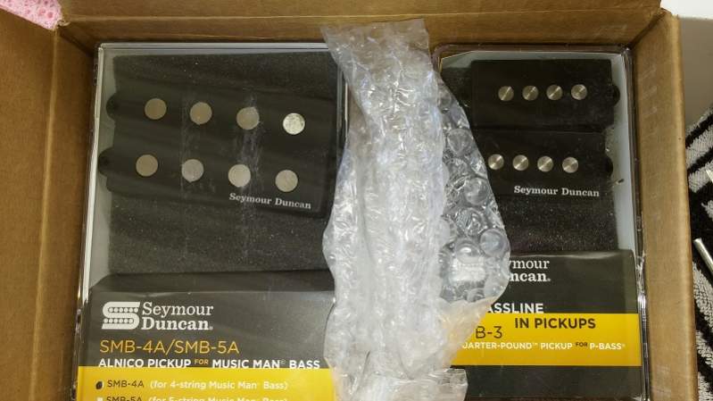

    Whilst I was sitting on a chair sanding a long. The Aussie Post parcel bloke arrived....scared the poo oot me boot....he had the Seymour Duncan pick-ups for me. They look cool in the box and even cooler just sitting in the guitar body....yes I know the P Bass ones would be up in the pickguard.....cool hey.

    cheers for posting the pics Ozzbike, I'll pull the neck of my PBH and fix the truss rod ! I built that a while ago and didn't know much about the truss rod then, don't think I even set it up properly !
    SD pups look great.

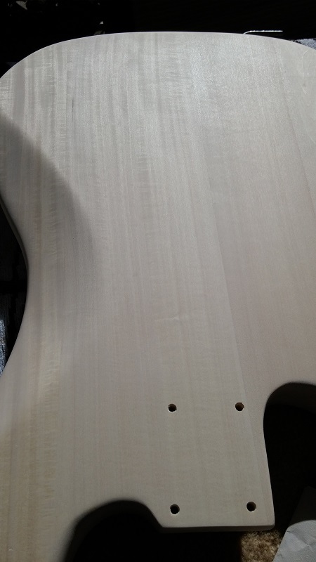

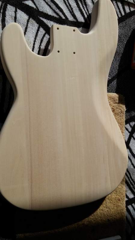

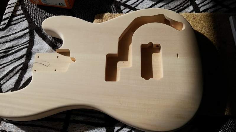

    Seeing as I have the needles and pain coming tomorrow I thought I should push through until I get the body and neck/headstock done.
    I got the body done....with some bits I would like to give a little touch up....the bottom of the curly bits near the neck pocket are seriously hard to get the sanding/machine marks out of.
    I went to 800 as in the Dingo Tone videos DB suggested he is tad retentive as far as necks go and he takes his to 600 or 800.....so I did it to 800.
    I don't know why Basswood is sort of thought as oh yeah it is a wood.....I don't know if the camera caught it....but there a little bits of flame in the wood....and some nice grain/figure.
    Well back in the box for the body and neck until I can move my arm again. The bridge has hit Sydney and should not be too far away....that would mean I just have the staining and waiting times to go.....cool huh.

    looking nicely sanded Ozz. Some basswood can have some nice figure. Just beware its quite a soft timber and can dent/ding pretty easily !
    Sure once you get the stain on the grain will pop
