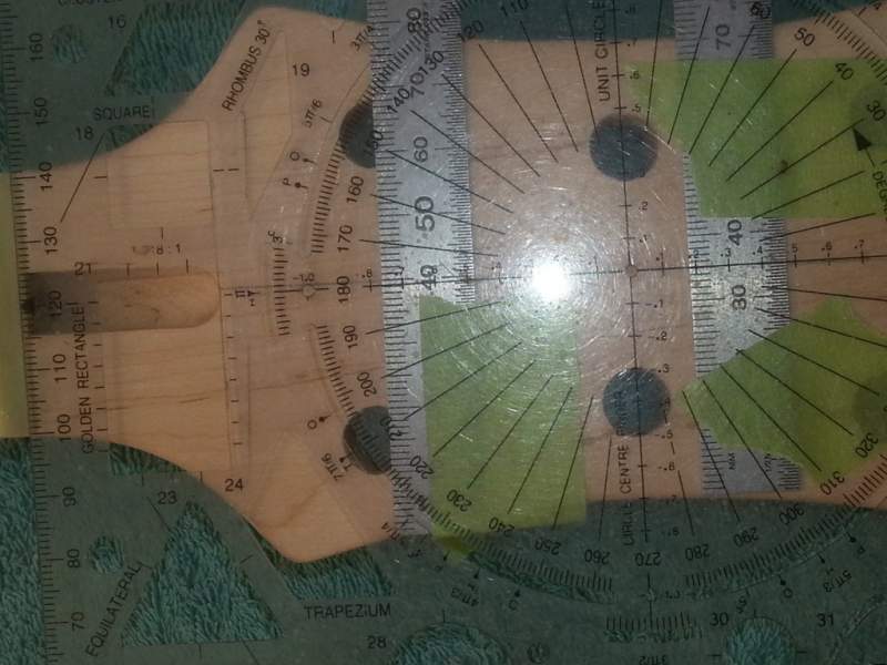

    and one more, if you can work it out.
Name:	White Falcon 006sml.jpg
    Kellza
    (PK)

    Are the holes not aligned or the hs out of whack?
  6. #36
    Mentor kells80aus's Avatar
    Jan 2014
    Wyndham Vale, Vic
    775
    Hi Andrew,
    all of the above. as to which set of holes are wrong is subjective. I am going to do the repair based on the high E set of strings, I will plug and drill the low E set. In other words teh High E's won't move they are my refernece point.
    The headstock will need 1mm taken off the low E side, and some adjustment at the top left, and bottom right to get it back into symetry.
    I expect many hours of teeth nashing, swearing and sweating, not to mention the odd angry beer being consumed. It is going to take a lot of careful work.
    Cheers PK
