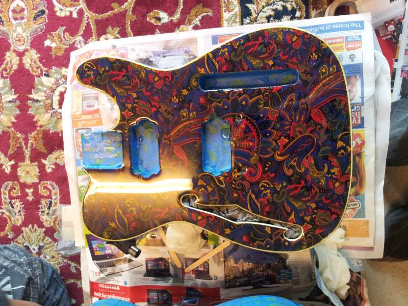

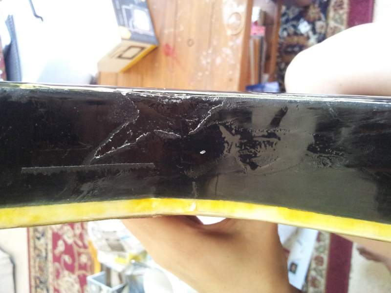

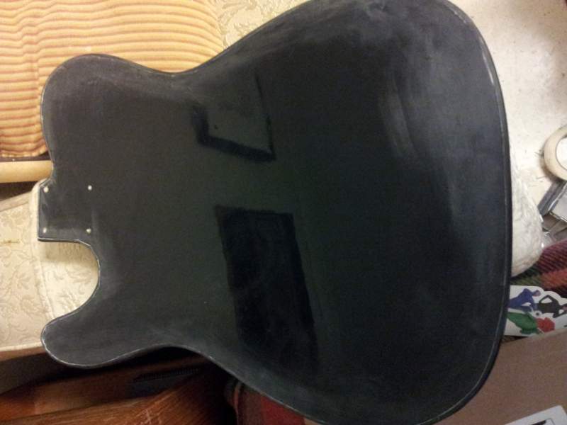

    So I did the whole thing in resin, but low tack tape let to much resin through. So I sanded down the offending bits (using wet & dry 400 on the worst and 1200 on the rest).
    Something to note: 1200 wet & dry is still super agressive on the resin.
    Here's the sanded down photos:
    P.s. I took a few weeks off while I was trying to sort out such things as my stolen car... :S

    Annnd a couple of quick pre-finishing ones + bonus extra projects in shot.

    Last one for the day to give y'all a heads up on the difficulties with the epoxy.
    It reaaaaallly likes to get underneath tape. Fortunately, if you do the pour in the evening the next morning you take off the tape and you can scrape off the unwanted extras with a fingernail and a little perserverance. For this to work it is absolutely imperitive that you've been patient and let your previous coat of epoxy fully cure (i.e. at least 3 days between flipping your guitar over for the other side).
    To do the side initially, I did the whole way around it with epoxy and sat around flipping the guitar every 20mins or so until it had hardened enough to give a good coat. each time you flip you should give it a quick go over with the mini blow torch.
    Also, get the small epoxy. The big one has done 4 amp chassis and three guitars. There's still about 1/5 to 1/6 left.
