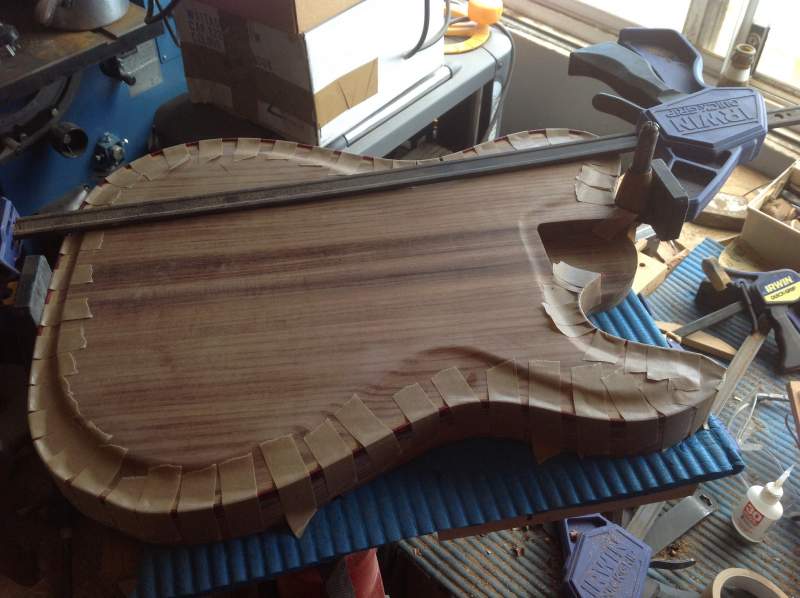

    Ok, I will try to keep it short...
    Firstly, you will notice burn out caused by two things, one is cutting the channel full depth first time and the second is using a blunt routerbit.
    The burning will severley compromise adhesion as the carbon acts as a barrier.
    Secondly, using acetone as a glue is questionable. Acetone effectivly melts the ABS plastic but not enough to effect a strong bond to the timber. (It is fine to join two or more layers of binding together using acetone)
    Notice how the guy melted binding in acetone to use as a bog? If you use either a weld on type glue (such as Tarzans Grip) or CA glue you will get a much stronger and consistant bond to the timber and thus will not need to bog up areas where the binding did not adhere to the timber.
    Thirdly, not enough tape used to hold the binding in place whilst the glue dries.

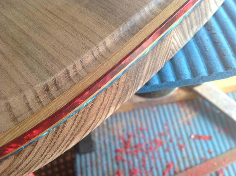

    And this is how it looks after a quick scrape and buff with 0000steel wool
